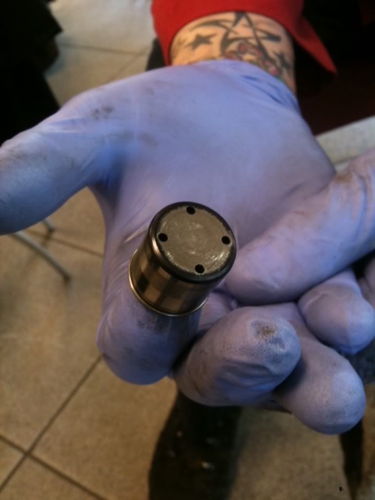

    This was mine at 46k miles on the dot, 2008. If you are bone stock they will replace your cam, follower, hpfp under warranty but if you have mods they may deny you. I paid 80 bucks with labor to get mine replaced, they are 50 if you want to do it yourself and my shop said I should be good for another 40k sooo.. Not a huge deal imo, do it or get it done so you dont need to worry about it.

    ^^ That one was probably ready to bust, once the black coating wears off they wear super fast.

    Some have failed as early on as 50k, everyones story is different so don't feel safe until you check yours.
