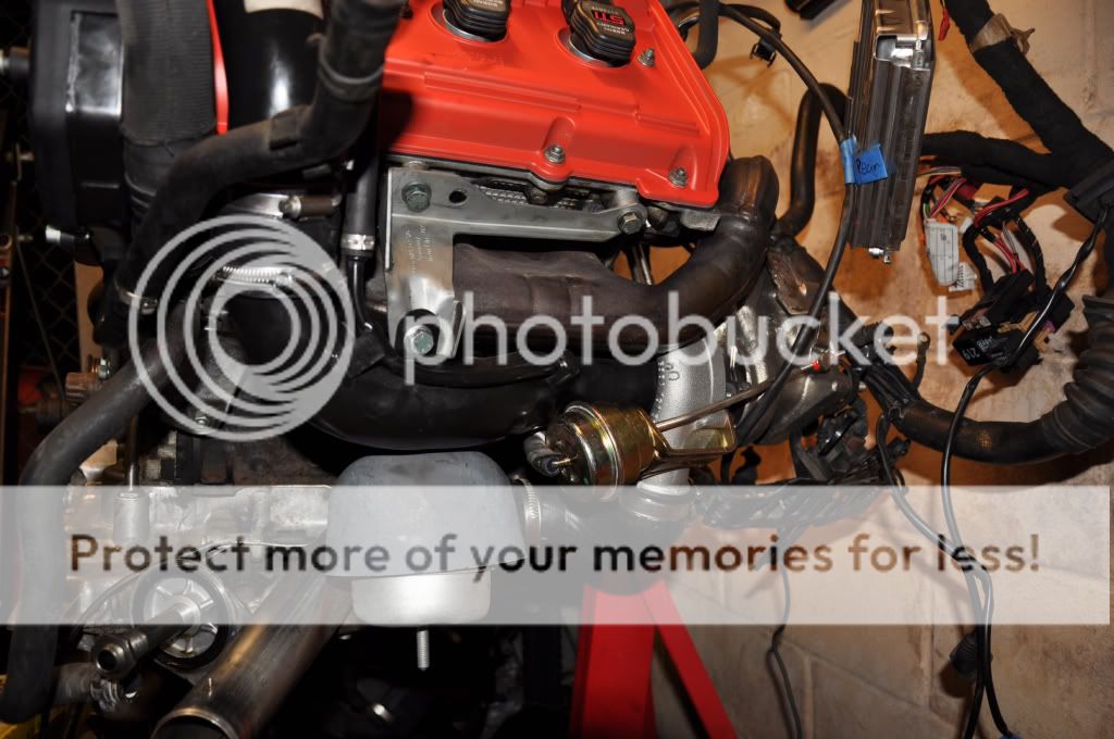

  5. #85
    Apr 18 2007
    17386
    ny
    Some updated pics I took today:
    6 Speed--EPL--034--SPEC--ER--AquaMist--Forge--RS4--RS6--K04 --RNS-E--DTS--PSS9's
    SOLD
    Greg
    C5UNION
  6. #86
    Jan 31 2010
    54269
    S-Line A6
    East Haven, CT
    Looks like she's ready to go back together, no?
  7. #87
    Apr 18 2007
    17386
    ny
    Hopefully this weekend vin, got a few more odds and ends to take care of.
