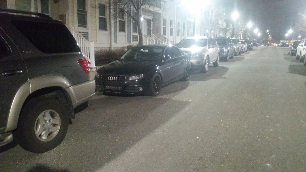

    Veteran Member Four Rings Lambda13's Avatar
    Jul 07 2012
    96422
    A4, car parts, paint, random sockets, OEM parts.
    Boston, MA
    My TR11, better view than my original.
    My 2009 A4 Prem+ Build thread
  19. #259
    Veteran Member Three Rings Townending's Avatar
    Aug 29 2014
    278682
    Claremont, CA / Big Bear, CA
    Quote Originally Posted by Lambda13 View Post
    Did your city turn up your streetlights to the "Noon on a sunny day" setting? Those are bright!
    On a related note, did you guys notice any increase in turbo lag with the TR11? I'm liking the price, but my biggest concern is the time it takes to build pressure in that massive thing.
    2009 BMW E92 M3 - SilverStone II - Full IPE F1 Exhaust - Stage 2
    2013 A4 Quattro - Moonlight Blue
    Mods : APR K04 E85 - Solowerks S1 Coilovers - Treadstone TR8 - RS4 Honeycomb Grille / Foglight Grilles - ECS Intake tubing - Hardwired Valentine 1
    034 Motor Mounts / Tranny Mount + Insert - ECS Rear Diff Mounts + Insert - Alzor Style 349 Wheels 19"x9.5" ET 40 - 265/35/19 Michelin PSS - VAGCOM Mods
  20. #260
    Jul 07 2012
    96422
    Boston, MA
    Quote Originally Posted by Townending View Post
    It actually doesn't have much pressure loss which is why I went with it. I haven't seen any negative effects. It was in preparation of a new turbo :)
    I think its primarily glare, but yea those seem wicked bright lol
