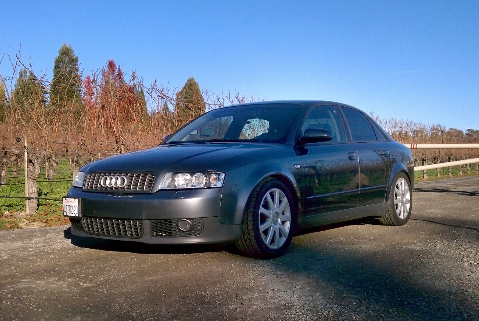

    I'm in Palo Alto.
    Just came back from a weekend trip to the central coast; the ride with the new control arms and H&R/bilsteins is AMAZING compared to the stock suspension w/80k+ miles on it. Night and day difference. I fell in love with the car all over again. This has been the best upgrade so far. Well worth the bloody knuckles and hours of unadulterated profanities.
    Forgot to mention: shifting has improved significantly. It's much, much crisper than it was prior to this repair/upgrade. Not entirely sure which portion of the repair/upgrade would attribute to this. I'm guessing the old, shot control arms may have had an effect on shifting?

    Gotcha, I'm in SF or a bit north. Don't make it down there too much but hopefully we won't have to wait for AZ11 for a chance to meet up.
    Isn't that the greatest? New suspension is like a whole new car. Totally changes everything, I couldn't agree more. The change in shifting can be largely attributed to the suspension itself but the new CA's don't hurt either. Basically, with a shot suspension a vehicle travels around a lot more when shifting. Tighter suspension = less body movement = car spends less time moving around and more time moving forward.
    Similar, last week I raised my rears maybe 1/2" and it's really improved the ride. Pretty sure I need to drop the fronts maybe a turn max to finish it off. Then no touchy touchy.

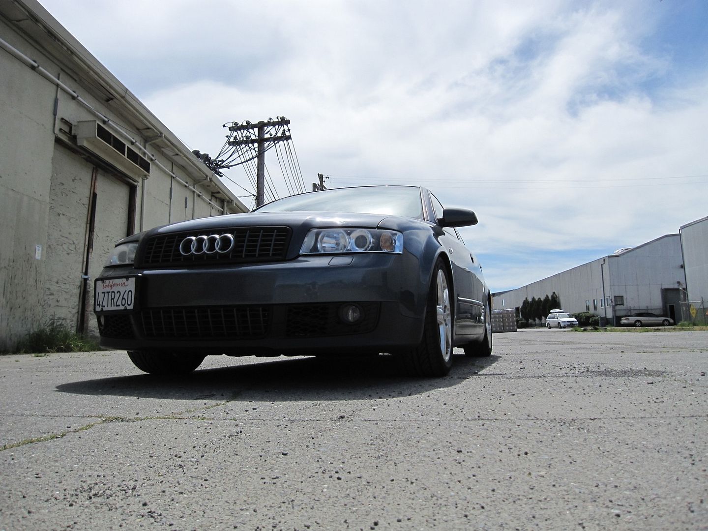

    did you ever put spacers? we have the same wheels and same ride height (ish) and i was thinking 5mm on all 4 corners to make these 17 flush. I dont see any listed in your mod list.

    What are you talking about? It's totally listed. Been there since I put em on.
    Yes, did and I was so happy to do so. There was always something about my car I didn't like but could never put my finger on it. Then I realized...
    OEM Stock Sport 17's, ET45
    OEM Celebration 17's ET43 + 10mm F and 15mm R = ET33/28
