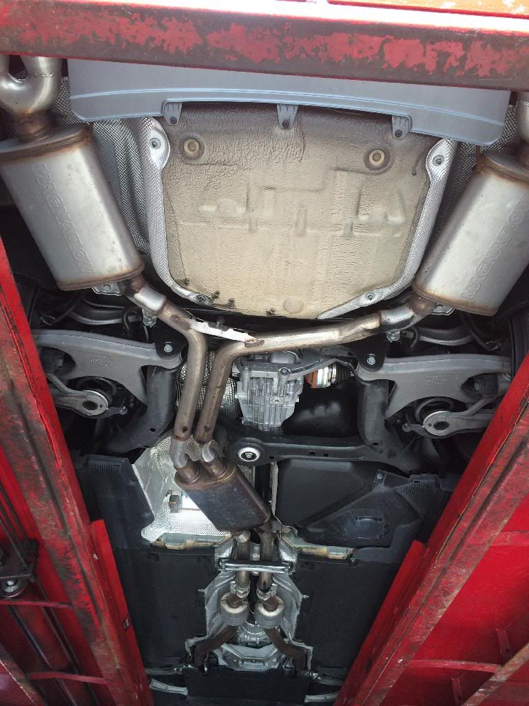

    Guys, i removed the 2 baby mufflers from my car.... SOUND IS EVEN BETTER......... PErformace on high rpms feels better too.
    Current setup is OEM CATS, Resonated X PIPE, MUfflers...
    I will try to make a video and post it...

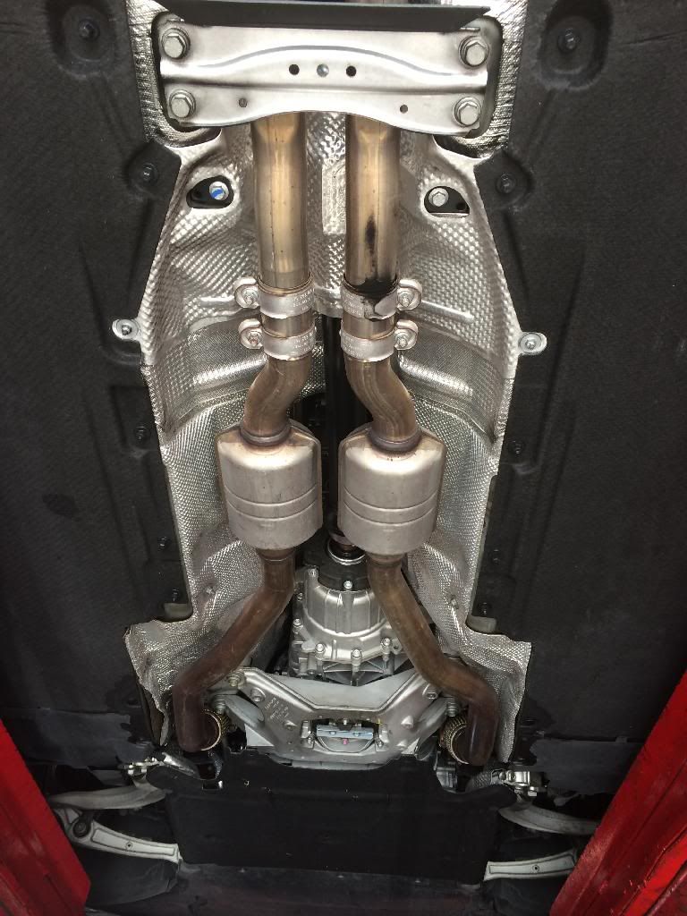

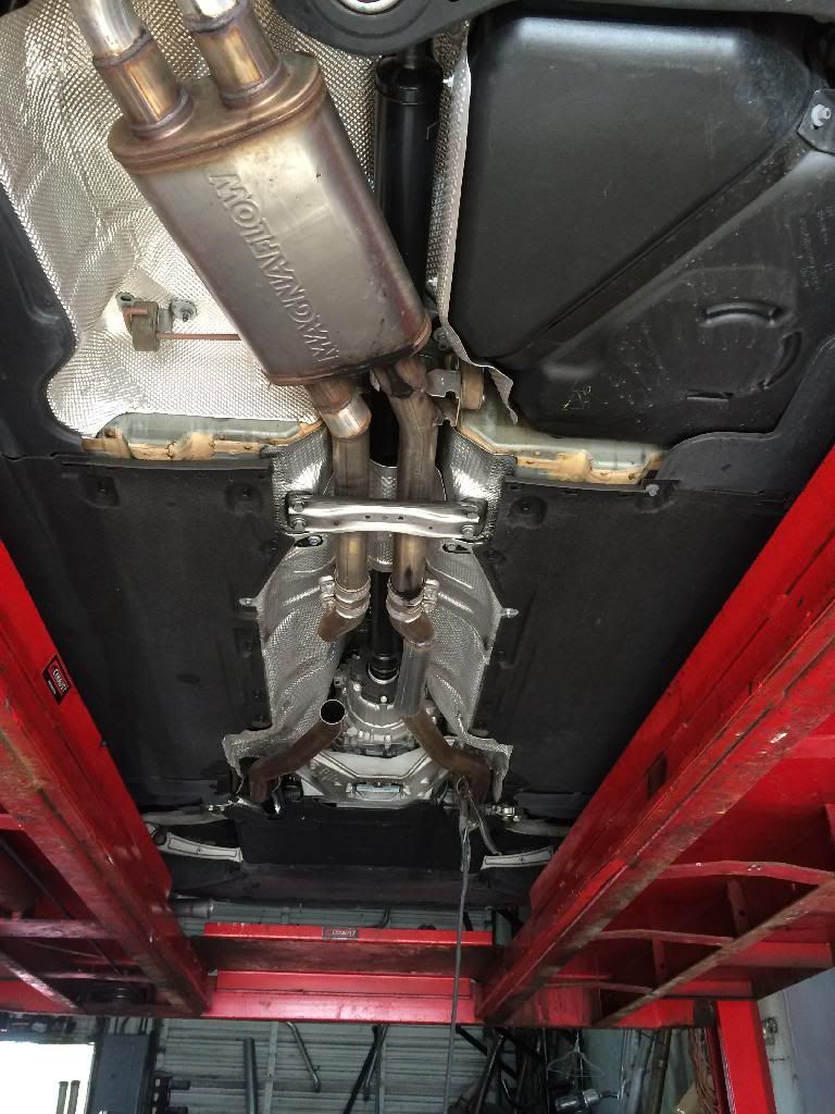

    Here are the install pics and video.
    Full system BEFORE
    http://i748.photobucket.com/albums/x...pskc4vnbza.jpg
    2 baby mufflers about to be unplugged
    http://i748.photobucket.com/albums/x...psdm2qde65.jpg
    Job being done
    http://i748.photobucket.com/albums/x...pswgmipla7.jpg
    Here is the video. This was recorded at a parking lot during heavy rain, lots of background noice and that lil wall right there wasnt really helping. I will make a better video soon.
    http://s748.photobucket.com/user/die...uhouo.mp4.html

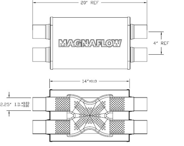

    Here is another video i just made. This is a cold start up. Sorry about the quality. I recorded it with my iphone.
    http://s748.photobucket.com/user/die...jcvkq.mp4.html
    And here is a nice pic of how a resonated xpipe looks like and how it works.
    Diego M.

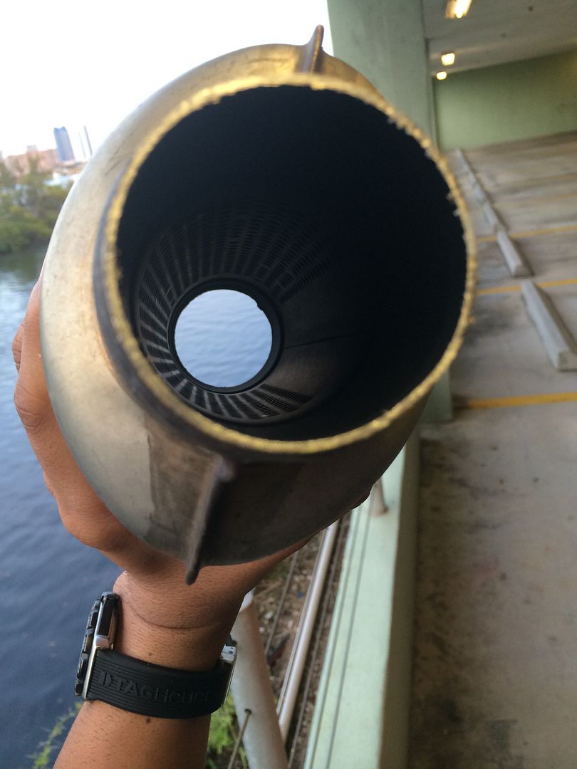

    For those wanting to know if they are baby mufflers pr baby cats. Here is the answer

    I resolved the drone using a resonated xpipe rather than the regular straight xpipe

    Look at the pic of my setup few messages before. Its baby mufflers delete with straight pipe. Magnaflow resonated xpipe and magnaflow mufflers with double 4" tip

    I had the rear mufflers with a straight xpipe the sound was raw and very good... BUT i had drone. Mine is DSG. If yours is MT you can try that 4 sure

    Just got my car back, now my car goes like so
    OEM Headers -> OEM Catalytic Converters -> straight pipes -> OEM Rear Mufflers
    So I basically removed the center "resonator" (a muffler) and the resonated downpipes.
    Will post video soon. VERY RASPY, love it though
