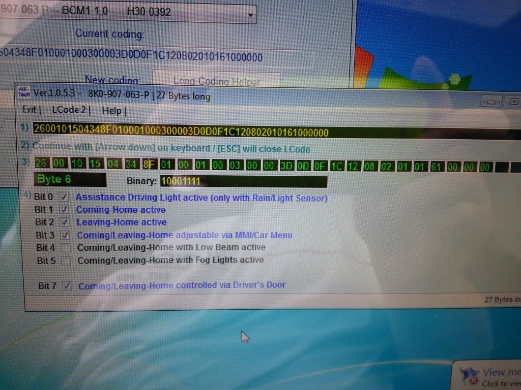

    Quote Originally Posted by ob_1jr View Post
    I posted this on the previous page as a reply to your previous post about it. I believe post 605:
    [09 – Cent. Elect.] [Coding - 07] -> Long Coding Helper -> Byte 6 >> Bit 5, uncheck it. (It says something about the fog lights)
    Now my fog lights don't come on for the coming home feature. The setting for the LEDs is a little dim for at night, so I started out with setting the LED brightness to 40, but that seemed a little too bright, so I went back in and set it to 25. I will see how that works for me and if I get flashed by other drivers at night.
    I tried this today.
    This seems to disable the fog lights completely. As in you can't even press the front fog button to get them to come off, they are just off all the time. The bit it says about the fog lights is "Front fog lights Installed" (my 2013 B8.5). It would be great to turn off the front fogs when locking/unlocking the car but still retain use of them.

    Quote Originally Posted by jmaddr View Post
    I tried this today.
    It may be something different on yours then. That worked for my 2012. I could enable my low beams to come on for the coming home feature. I have read on ross tech's site that the B8.5 is a little different. The way i found it for my car is just by snooping around in the different bytes and bits. I am pretty sure on my car it said something about fog lights for the coming home. I will have to go back and look again and possibly get a screenshot for you.
    I also did the coding to keep my foglights on with my high beams, but i am betting it is a different code for yours ince the other one basically disables the foglights, but here is the one for the foglights on with the high beams (from audienthusiasts site)
    Front Fog Lights stay on with High-beams***[09 – Cent. Elect.][Coding - 07] -> [Long Coding Helper] -> Byte 4 Bit 1 - Change 1 to 0

    Sorry about the crappy cell picture, but here is what the screen looked like. From what you described to me from yours on mine is byte 0, bit 5 in the same section. It says front foglights installed.
    Wow. This is completely different, even the wording at the bottom. I'll check on this tonight! Thanks for posting.
  10. #690
    Senior Member Three Rings ob_1jr's Avatar
    May 05 2012
    93082
    Clinton, UT
    yeah make sure you click on the 7th box over on line 3. I think you were on the first box (byte 0). In any case, you can do just like I did and click on each byte until you find it. I know it has to be there for the B8.5.
    I can confirm I was on the wrong byte. Sorry for the confusion but I can confirm this now works on the B8.5 as well. I think this should be on the main page now. Looks so mean now when you unlock/lock the NA models.
    Many, many thanks, ob_1jr.

  35. #715
    Veteran Member Three Rings 1flossedS4's Avatar
    Jun 11 2013
    116968
    Albany, NY
    Great list.
    I was able to code these on my 11 S4 last night. SO MUCH BETTER at night and the front end looks way better without that dump amber corner. (I refuse to pay $2k for some lights without a amber sidemarker lol)
    Went to 30 on the LEDs
    Disable amber corner lights
    [09 – Cent. Elect.] [Coding - 07] -> Long Coding Helper -> Byte 10
    Submodule 0
    Bit 3 - Set to 0 to disable amber side markers (U.S. vehicles)
    Disable LED 'wink' on turn signal
    [09 – Cent. Elect.] [Coding - 07] -> Long Coding Helper -> Byte 3
    Bit 2 - LEDs remain at full brightness with parking lights (1 = active)
    Bit 7 - Turn off LED-strip DRLs with indicators (1 = active)
    Adjust LED brightness
    [09 – Cent. Elect.] [Security Access - 16] (enter security code. One of the default codes is- 20113)
    [Adaptation - 10] -> Channel 3
    Set between 5 and 100
