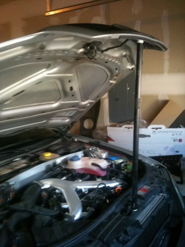

    Quote Originally Posted by 4ringAR View Post
    Two days ago the hood strut stopped working...ghetto replacement is a piece of PVC.
    This happened to mine too. When I changed my oil this weekend, I had to use a 2x4 to prop it open. Also driving on the highway my bellypan ripped off the other week. Scared the sh*t out of me when it came off at 70mph!!!

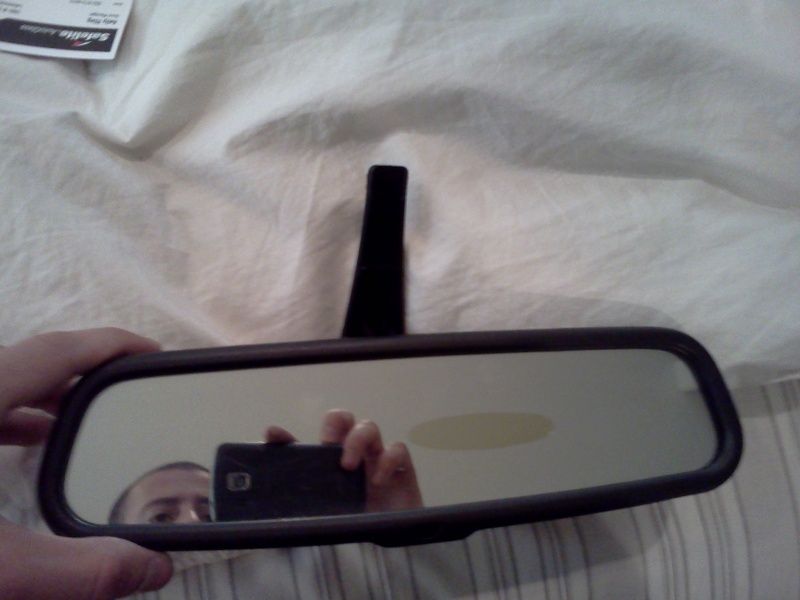

    I went to the european auto scrap yard and picked up a compass mirror from an RS6. Had to recalibrate it, but that was easy. I feel like a friggin explorer with this thing.
    old one with no compass and fluid bubble:
    shiny new, rs6 one with compass!

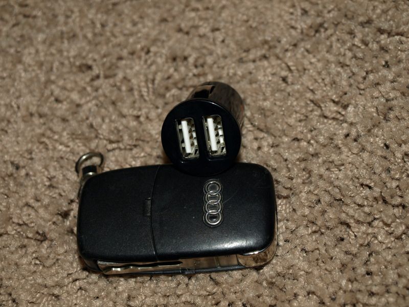

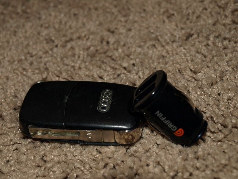

    I got some other goodies for the car in the mail while it was in the shop(not expecting it to be such an intensive situation) but I installed them today, and will have some installed pictures...soon.

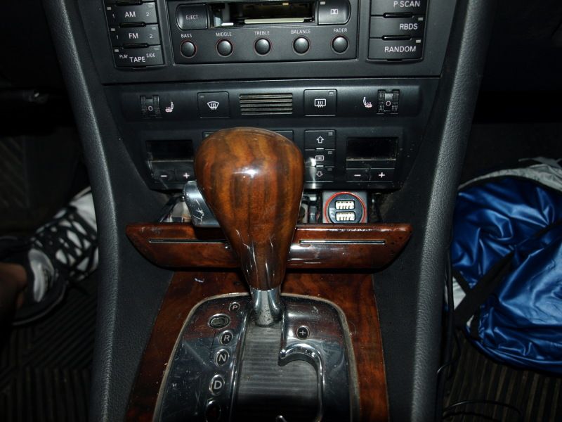

    1) I got this little Griffin Dual USB charger, 2 usb's, charge 2 things at once! It plugs into any 12V socket, and sits maybe 3/32 of an inch out of the socket...very low profile! Its lower profile than the stock cigarette lighters, so it wont get easily knocked out, and you can close the ash try with it in! Charge cellphones, iPods, cameras, whatever. Ive read that because its only 1amp per plug, it either wont charge iPads or it charges them very slowly, but I dont have an iPad, so not an issue. And theyre like $10 on Amazon, super cheap.

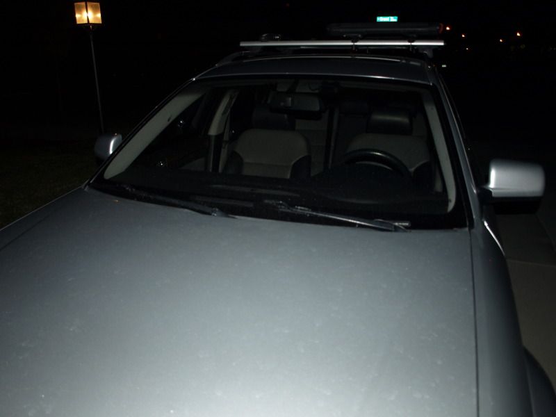

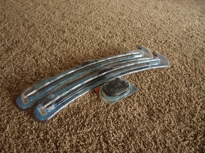

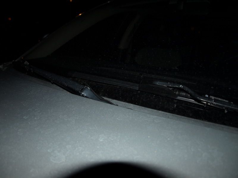

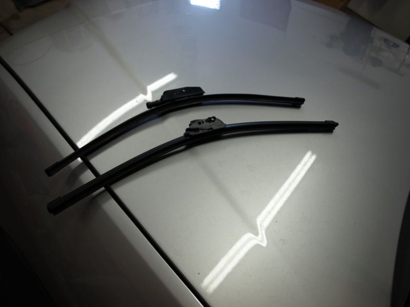

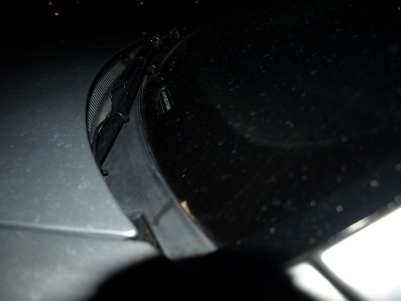

    2) I wanted to try heated wipers because I hate having the blades freeze up in heavy snow. I went with HeatFlexx(www.HeatedBlades.com) because they use the new "aero" style blade, and looked well put together. $50 (+$9 shipping, but thats free if you use "SNOW" promo code), is only a few bucks more than new blades from pep-boys or something anyways, so what the hell, might as well try it. Install was easy, they use pretty generic push-type plugs(looks like HP or similar laptops power plug), so putting it together is cake. just plug it in on each blade, run the wire down the firewall and ziptie it to the wiper arm(only negative i have to say is the included zip ties were too small to be useful), and either hard wire it using the included ring terminals, or use the 12V socket connector thats included. They will come on at 40*F automatically with little thermo sensors right inline the wiring, right by the blade. I might redo the wiring and have an on-off switch with LED indicator, but its ok for now. Its supposed to snow later in the week, cant wait to test them out. Like I said, Ill get some installed pictures of it soon. I need to redo the zipties on the wiper arms, I only had white ones available and so it looks like shit right now.
    Generic aero wiper blade vs heatflexx. Looks basically the same, but the Heatflexx has a connector for the wiring

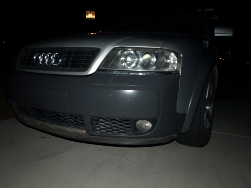

    3) I decided to paint the front turn signal bulbs silver since the headlights are clear cornered. That was easy, certainly looks better than the orange bulb sticking out in the headlights.

    Also, I got a new LED boost gauge light bulb. I used to have an LED one in there, but it was kinda too blue for the rest of the gauges, and it began flickering and eventually died. I put a standard 194 halogen bulb in, but it was worse than the blue, very yellow in comparison to the rest of the instrument cluster gauges. Found an LED bulb by Sylvania at Pep Boys, color matches the gauges well but is a fair bit brighter. Im happy.
    Here you can kinda see the blueishness of the old LED.
    And new LED that is actually white, but bright
    And some of the heated wiper wiring
    Cant really even see any of the wiring.
    And USB plug
    And painted turn signal bulbs in clear corner headlights
    Sorry most of the pictures are blurry, I couldnt get the camera to focus.

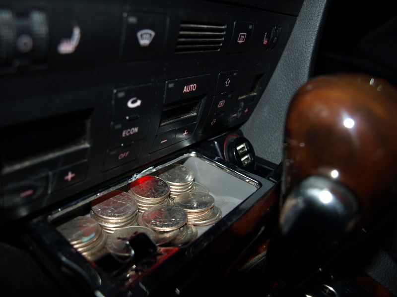

    PS: Dude!! what's with the Quarters?
  34. #74
    Veteran Member Four Rings 4ringAR's Avatar
    Sep 18 2006
    11642
    Colorado
    Youve heard of making it rain at the strip club? Well when I go to the strip club, I make it hail!
    Lol kidding I keep quarters in my ashtray since I use them at the car wash. Clearly, I havent been washing my car as much as I should, since Ive got a ton of quarters.

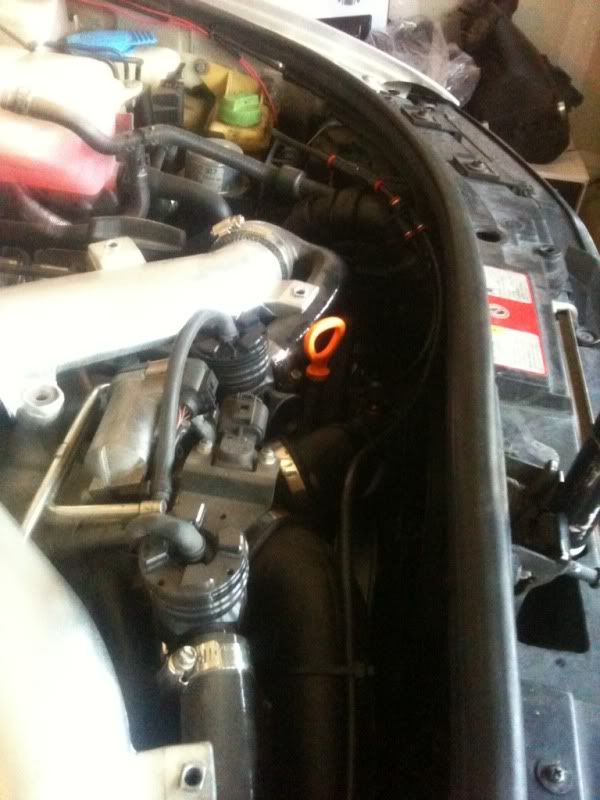

    YOUVE GOT TO BE FUCKING KIDDING ME. FUUUUUCCCCKKKKKKK.
    Im driving to work this morning, and all of a sudden the battery light comes up on the center console. I look at the voltmeter, and notice its pinned to 8V, and freak thinking the alternator isnt charging or something, then notice where the trip meter normally is it reads "FUSE" so I realize Ive just popped a fuse. I then also notice all of the lights on the dashboard, save for the instrument cluster and the LCD screens on the radio and HVAC are out.
    I get to work, and started pulling fuses to see which one has popped. Its number 15, which is a 10amp mini. I had a few in the car, so I put a new one in, turned on the car, and all was well. I get off work, and decided to try turning on the headlights because i know it is a lighting issue. POP.
    I pull over, put a new fuse in, and replaced the LED bulb in the boost gauge with the old halogen one, thinking this might be it. Works fine, I start driving, get cocky and turn on the lights, no pop. Great, it was the LED bulb.
    I get home, and decide to hit up PepBoys for another pack of fuses to verify that it was the bulb. Turn on the car and POP. This is with the halogen bulb. I try with the boost gauge wiring completely disconnected. POP.
    I drop the kick panel and start poking around, verifying all the aftermarket "homegrown" wiring is all good, it looks to be, but i decide to disconnect it all to make sure its not causing the problem. and POP.
    Youve. Got. To. Be. Kidding. I am so fucking sick of electrical issues. At least its only the lights that are affected, and not my heated steering wheel. It makes me want to punch walls....must...resist....Ive got a history of either hurting my fist or putting holes in walls, depending on the type of wall. Niether is desirable.

    New wiper blades grounding out somewhere?
  38. #78
    Sep 18 2006
    11642
    Colorado
    That shouldnt be it, I completely disconnected the wires for that and it still blew the fuse. Besides, it is not connected to that circuit at all, and it only happens once I turn the headlights on.
    I called the shop and they suggested disconnecting the HVAC unit because it was throwing some strange codes when they were searching for electrical issue #1.
    So i pulled the radio and pulled the HVAC...success! No fuse pop. But just to be sure its the HVAC, I plugged JUST the radio back in. POP. So its the radio. Well, just to be certain, I unplugged the radio again, POP. So I have no idea what it is still.

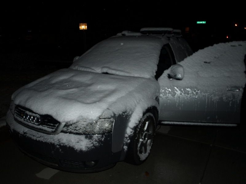

    And a snowy picture from the other morning
    Oh also this weekend I also got a new pneumatic hood prop, after over a year using the pvc pipe LOL. And a new rear wiper blade, how exciting!

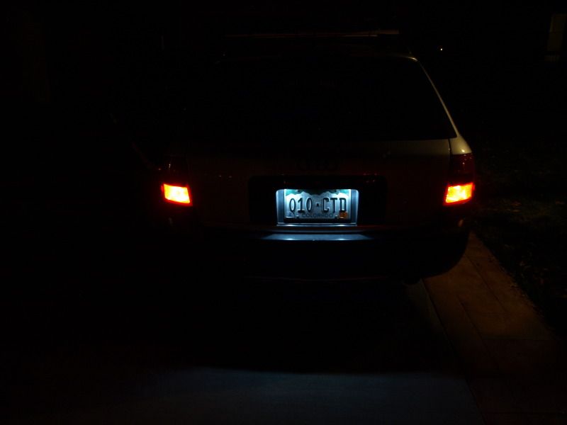

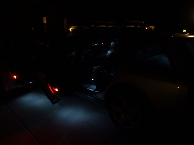

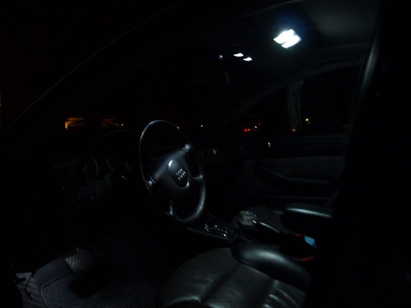

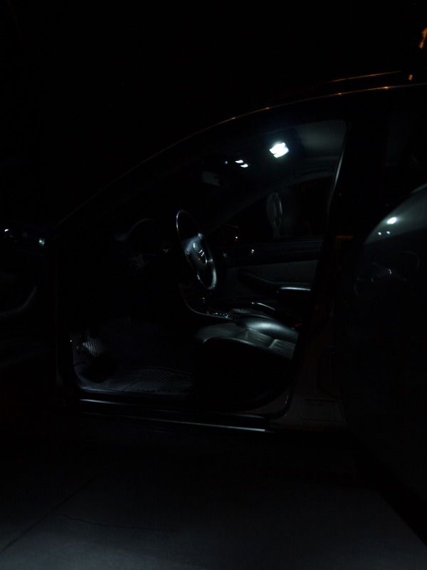

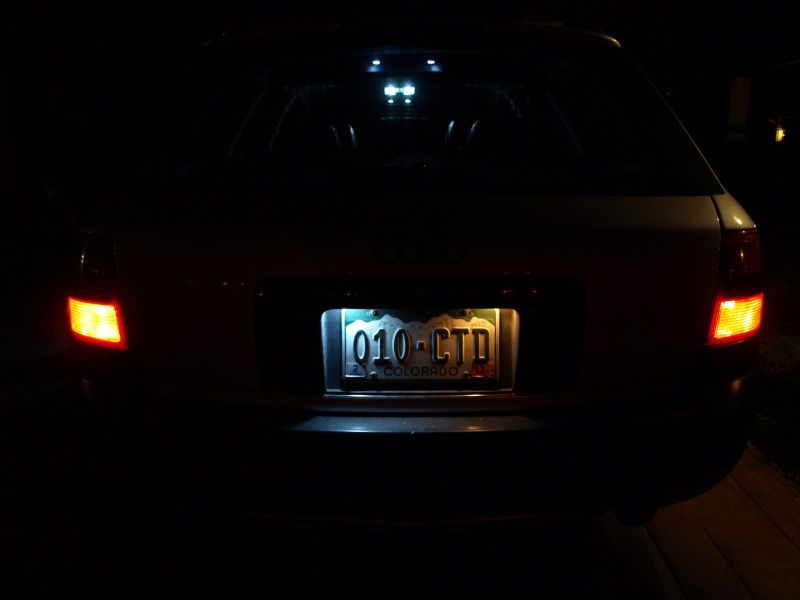

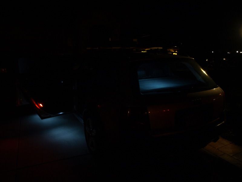

    Got this LED Interior light kit in the mail today. Everything is brighter and crisper looking. Im pretty happy. The kit is mostly complete, but not totally. However it is a good start towards a full LED interior.
    I used the rear dome lights for the license plate, and one of the cargo lights for one of the rear footwells. Cargo area is still brighter with 1 LED bulb than with both stock bulbs. Also still need the bulbs for the lights above the vanity mirrors, the glove box light, and that one light on the hatch so you dont hit your head. Ill also need a set of reverse lights now to go with the license plate bulbs!
