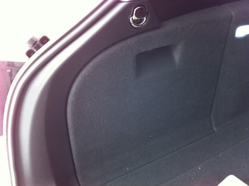

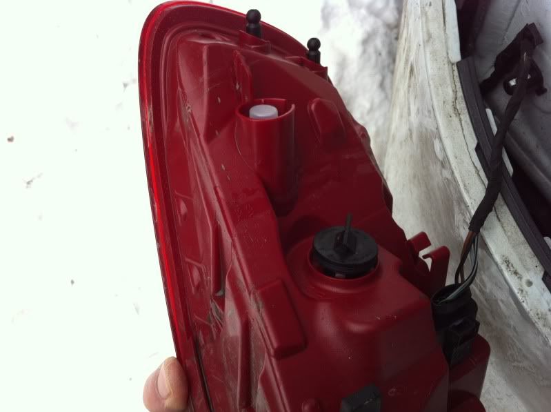

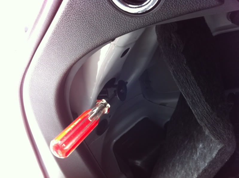

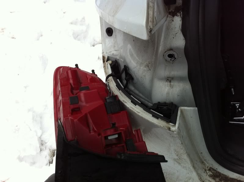

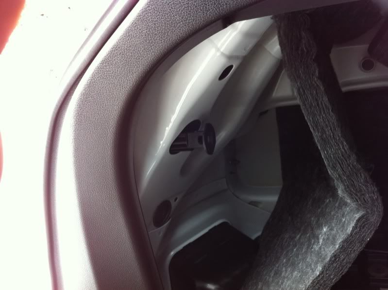

    Checked out my tails and it looks like the housing is different on the facelift 4's. Anyone have suggestions? I'm not really excited about unscrewing things at random All I see are some bolts + nuts that appear to mount the tail lights and one torx screw that I think secures the circuit board. Problem is the red housing appears to be impenetrable, like they don't want you to change your own bulbs Do I have to take off the entire lights to get to this?
    Here's some shots
    There's a small torx screw, you can kind of see the circular housing on the bottom leftish of this shot. My guess is it locks in the circuit board.
