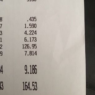

    99.5 A4 1.8TM AEB Fronttrak - Volcano Black Mica - AutoFlex'd Signal Green - E85 - Clutchmasters 725 series twindisk - ID1000cc - Precision 5858 cea Ball Bearing Turbo - JE Pistons/IE Rods - EurodyneMe - Coilovers - AWE DTS - 034 Mounts - Team Dynamic Wheels -Nitto INVO -Working @ DipYourCar.com - Usp Motorsports -
    Click>>>>>My Build Heel-Toe'n the b5 everyday =P
  38. #518
    Veteran Member Four Rings BrucexL33's Avatar
    Mar 19 2010
    56341
    2015 Prius Plug-In
    San Jose, CA
    freakin awesom! Any plans for a road/track vid anytime soon?
