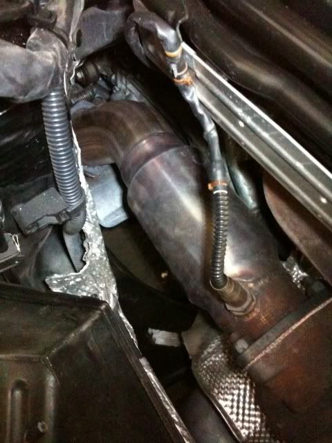

    BTW, the easiest way to replaced the sensor is just removing the top half of the intake box and viola. Took me about half an hour. Check out the plenty room w/ 034 HFC on.
