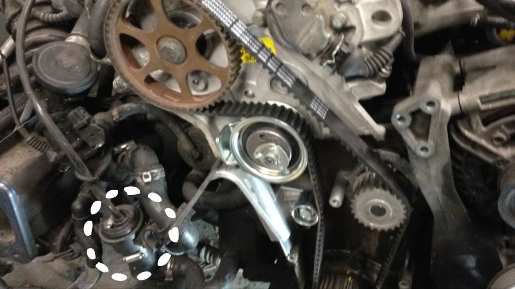

    Where is the DV located at? Easy to find location?

    Yeah, access if from underneath. Here is location from the top.

    Anyone OP that's where it is

    Apr 07 2011
    73592
    Quote Originally Posted by Preston_08 View Post
    Here ya go
    Senior Member Two Rings Preston_08's Avatar
    Apr 14 2014
    187316
    1998 Chevrolet C1500
    Richlands, VA
    Fluttering sound after boost
    Here ya go
    Awesome, gonna have to remove the whole front end....fun haha

    No no no, you access it from underneath. Put the can on ramps, remove a couple of one time use clamps and its off. No need to remove the front end

    Quote Originally Posted by freeloader700 View Post
    Sent from my finger tips using Tapatalk
    you could also just slide the front carrier a bit forward to gain some room, and do it from up top. No need to actually remove it. I prefer this method... I never seem to have good luck trying to pop off clamps while on my back.
    Apr 07 2011
    73592
    I was just giving you a different view of the location.
