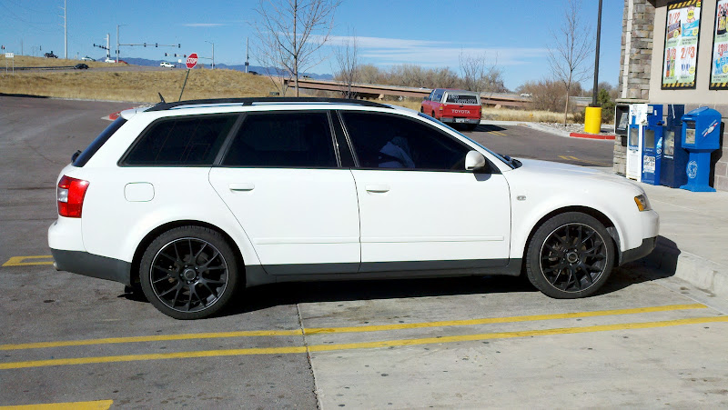

    Project Stormtrooper. 03 A4 Avant Tip.
    I kept the Bremmerkraft wheels from my Nogaro S4.
