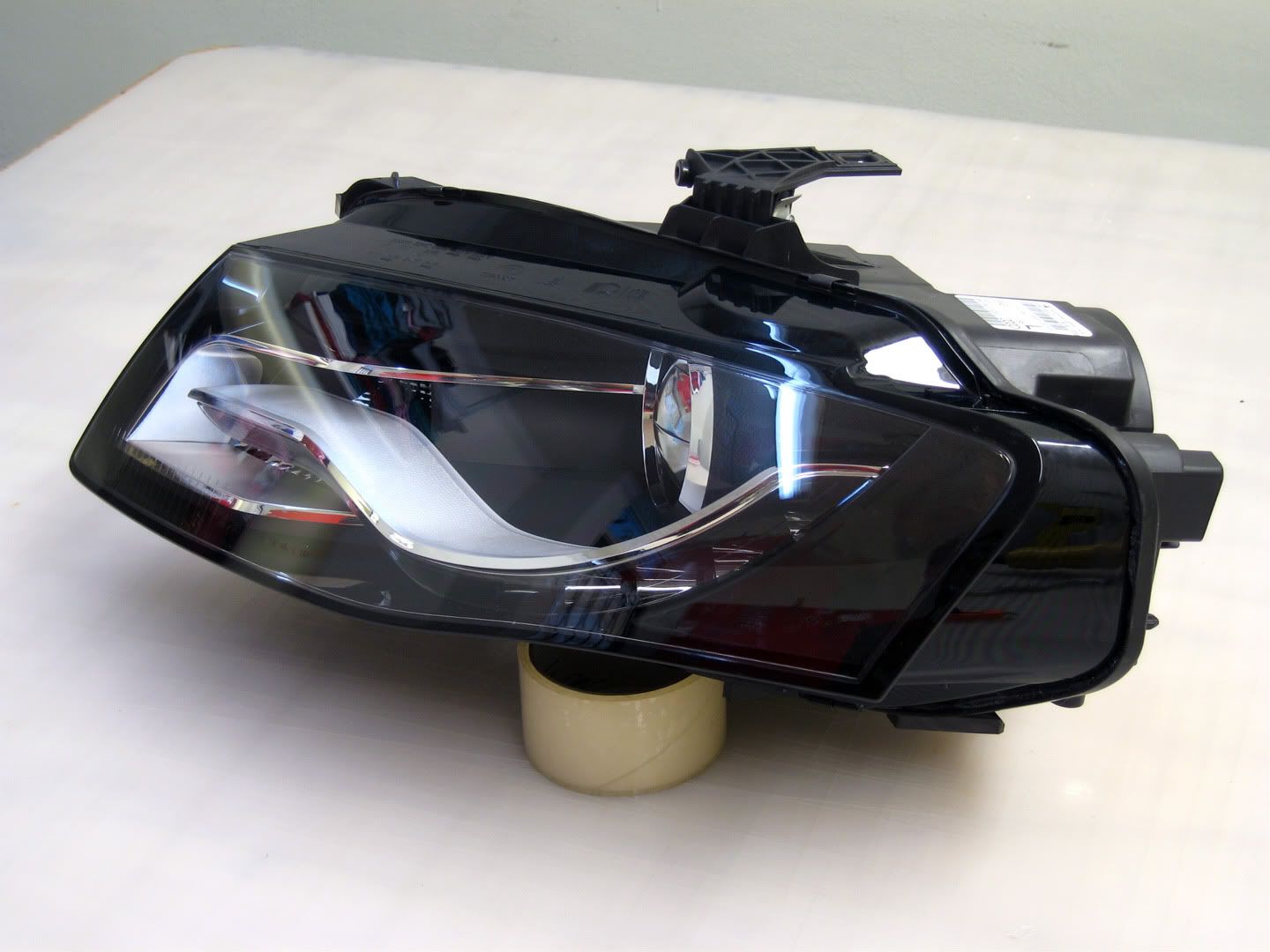

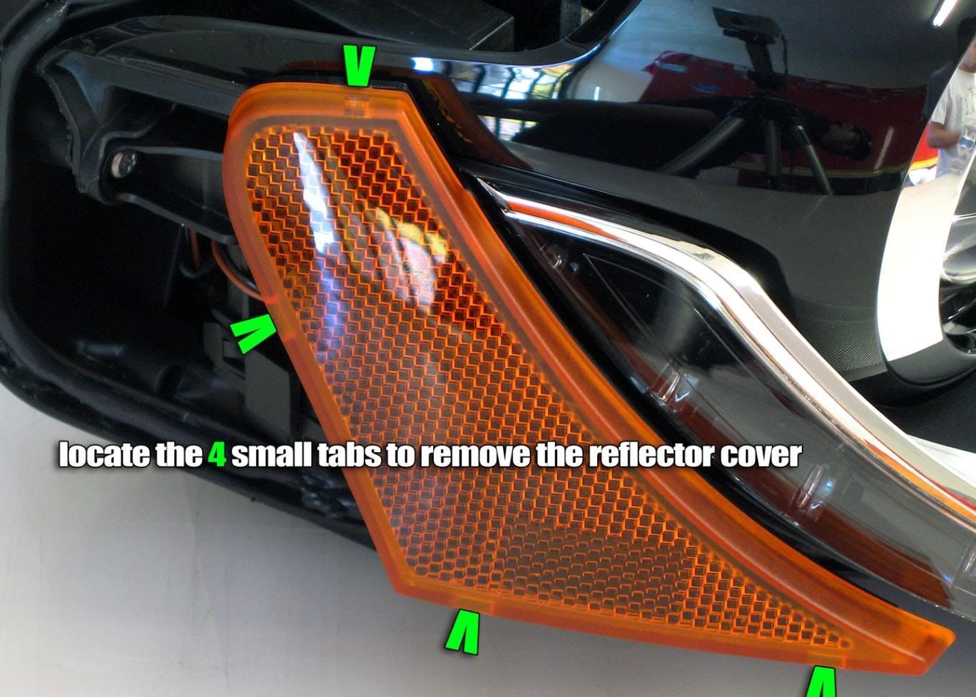

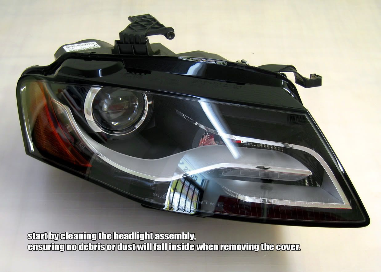

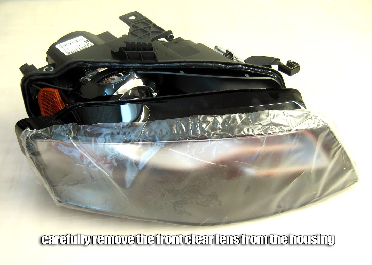

    OK, here we go as promised... but bare with me as some of the pictures got messed up in the process of uploading. So might need to post some now and some more in the morning.... enjoy.

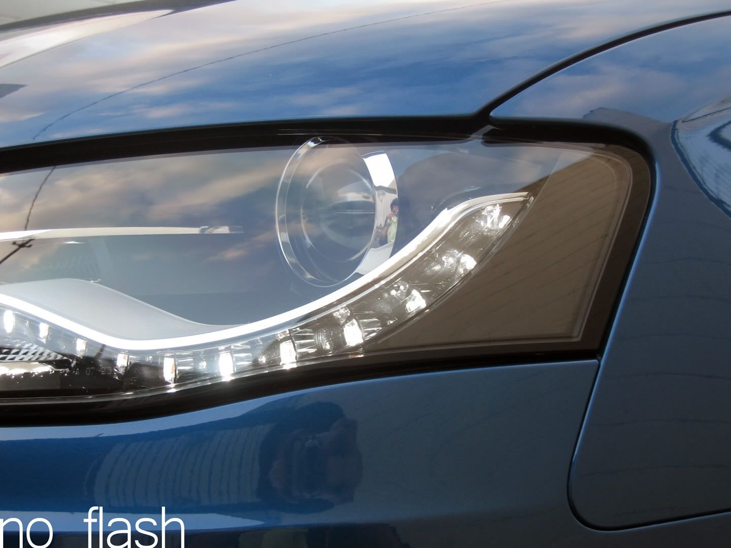

    Re: DIY J-Code tinted front reflectors

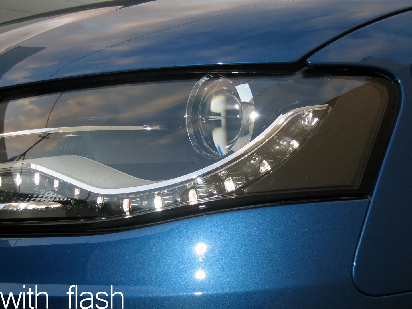

    Looks great, much cleaner .

    Great DIY write up...., looks much better! =)

    liking the clean look!

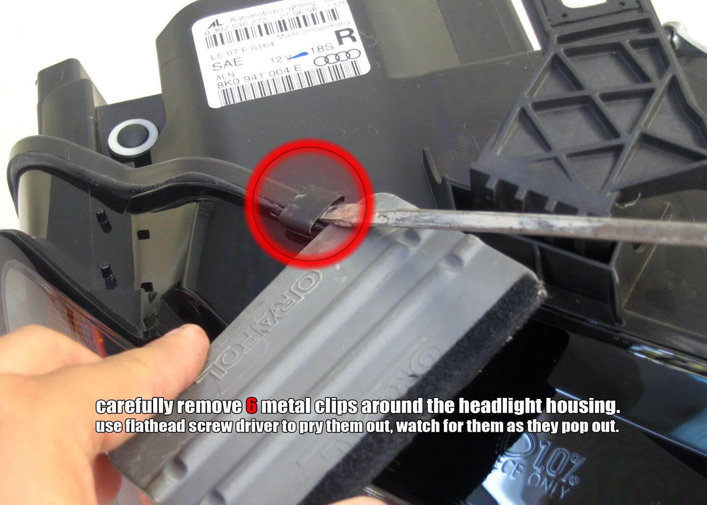

    back... sorry for the delay.. and there's a missing step-5... the file got truncated for some reason, have to retake the photo.
    for the rest...

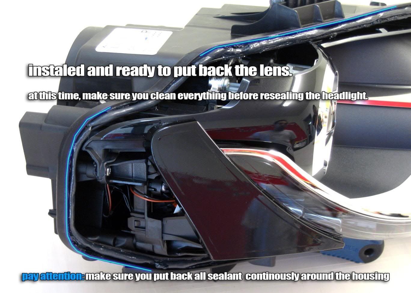

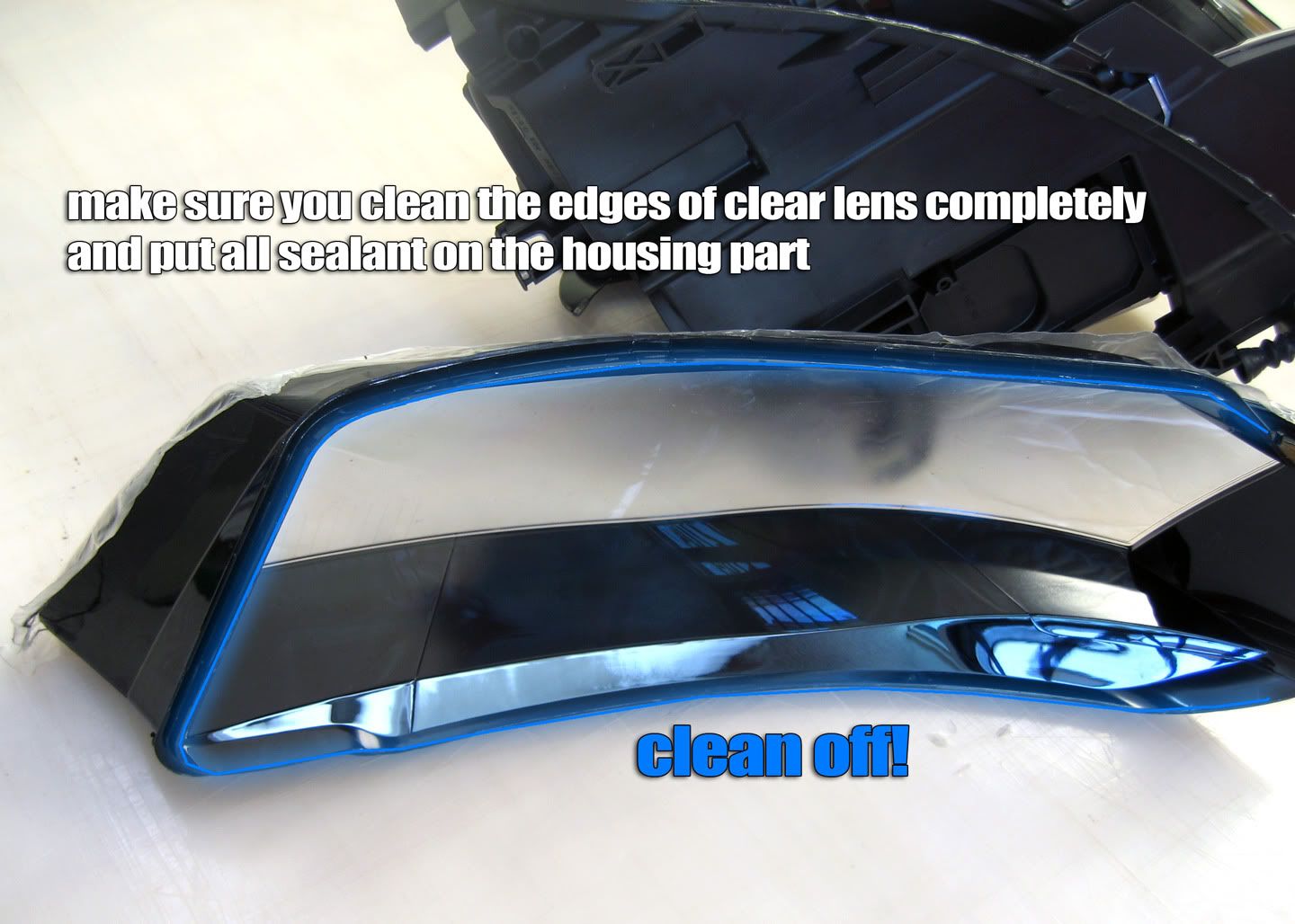

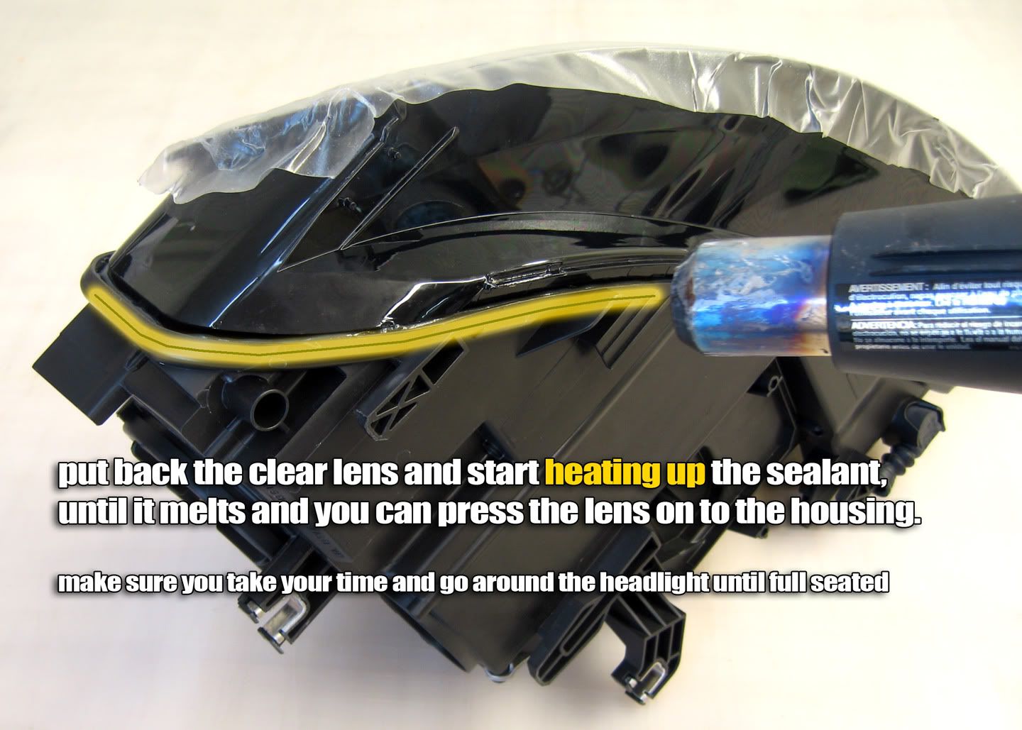

    Quote Originally Posted by agkellyboy View Post
    Can you stick the housing in the oven like I did with my B7?
    you could as long as you make sure all ballasts, headlight servos and all electronics are removed (those puppies are expensive). It's a lot more work that way...
    end result will look like this...

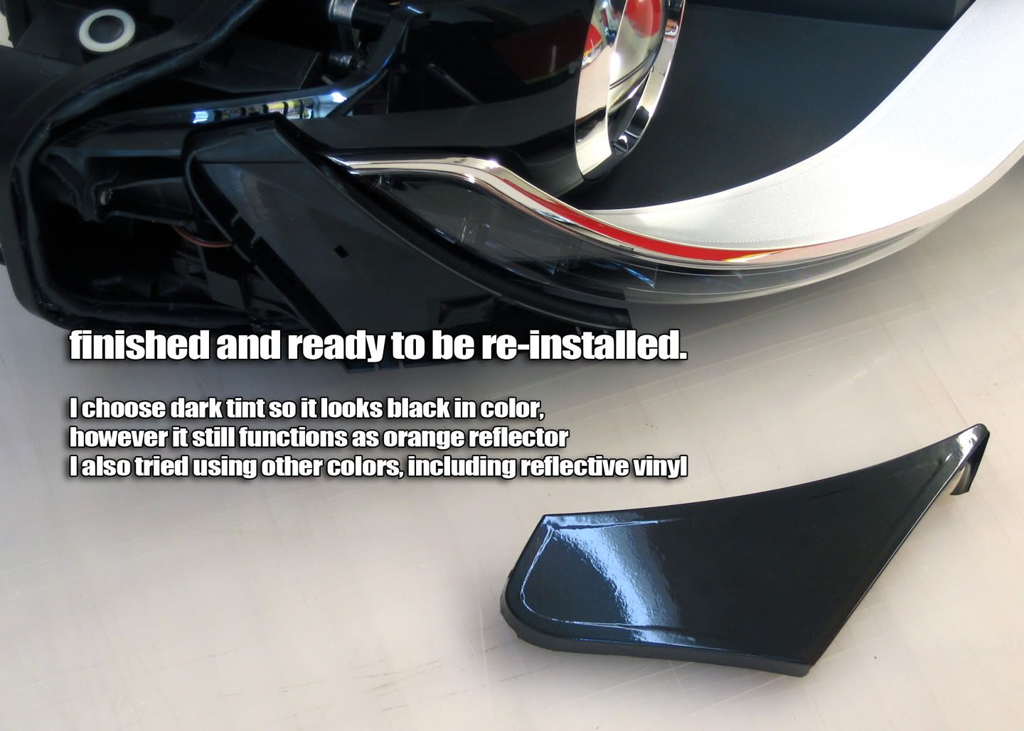

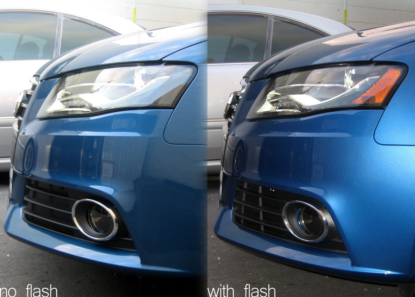

    Hm, now where can I get dark tint vinyl in small quantities.
    Is there such a thing as white tint vinyl? I wonder if that'll look nicer with a white car.

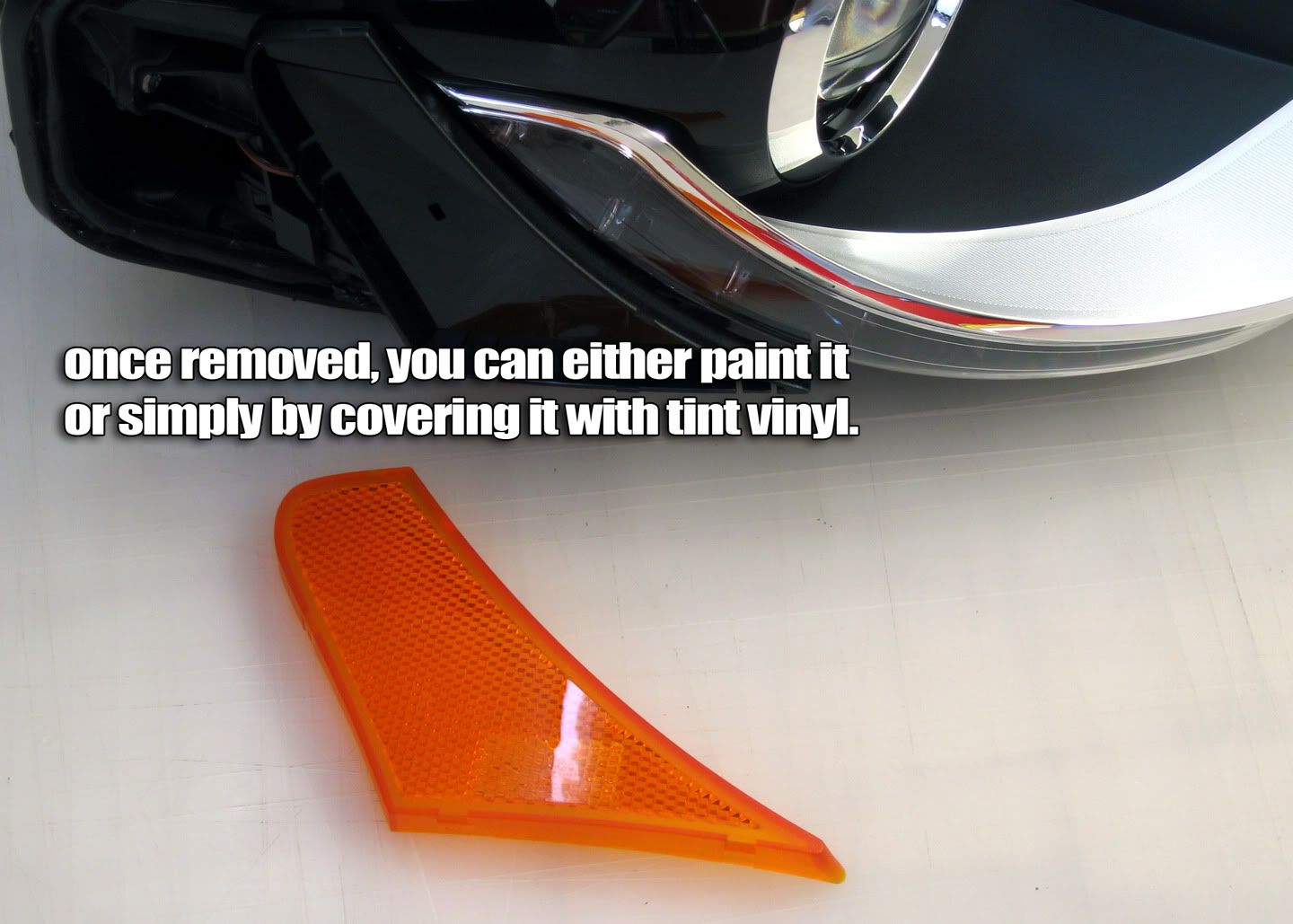

    Quote Originally Posted by Ryan_T View Post
    I can cut you some small pieces, but believe me... actually the tinting IS the hardest part of this DIY. To get it perfect really took me as long as the time for me to take off the lights, open the lens etc.
    There's no white tint. that would be transparent :D
    I should make it clear, it is white reflective vinyl. Thus it will reflect the color white just like license plates.

    Quote Originally Posted by Comp4k View Post
    Looks awesome! How long did it take?
    3-4 hours, first time was 5-1/2 hours :D
    the longest time was with the 'tint vinyl' hard to get perfectly smooth and no bubble.

    I plan on just removing the reflectors and taking them to a tint shop to get them tinted at the same time my car is tinted...I'll post results after tomorrow :)
    EDIT: Forget I said that; I'll try during my Thanksgiving break. Heating the housing took a while and I eventually gave up when it wouldn't budge. About how long should I be heating it for before attempting to open it? Or should I heat it section by section?

    Just a clarification: Do you simply heat up the original sealant and then press together and heat some more? Or do you add new sealant as well? If so, any particular kind or brand?

    Quote Originally Posted by Spacecadet_CC View Post
    Takes up to 30 minutes to completely heat sealant around housing before they become tacky and able to separate the back housing from the glass. Just keep heating on the move, don't focus on one area longed than 3-5 seconds
    I always think put back what you take out just to be safe :) so I did just that, pit back 99.5% sealant I took out. Nothing more, nothing less (first time, pit less and got fog inside housing afterward)
    I didn't spray since it's more permanent, and if you messed up the reflector covers, you can't purchase them individually (dealer don't have part #). I did contact manufacture of said plastics, and no reply (thinking I was going to order them in clear white)
    Patient is the key. Good luck
    I always think pit back what you take out just to be safe :) so I did just that, pit back 99.5% sealant I took out. Nothing more, nothing less (first time, pit less and got fog inside housing afterward)
    So you're removing the sealant as you heat it up?
    Established Member Two Rings S3S4's Avatar
    Oct 25 2009
    49726
    Connecticut
    Anyone thought of just replacing the turn indicator bulbs?
    On my WRX when doing the headlight mod we would remove the plastic amber pieces and replace the indicator bulb. The bulb looks black/charcoal in color but when lit it turns orange. I believe they were called silver coated amber or something along those lines. They were also really cheap off ebay...
    This is an example of what it would look like:
    Ive never been inside our headlights so I don't know how easy this would be to do or if it is even possible..
