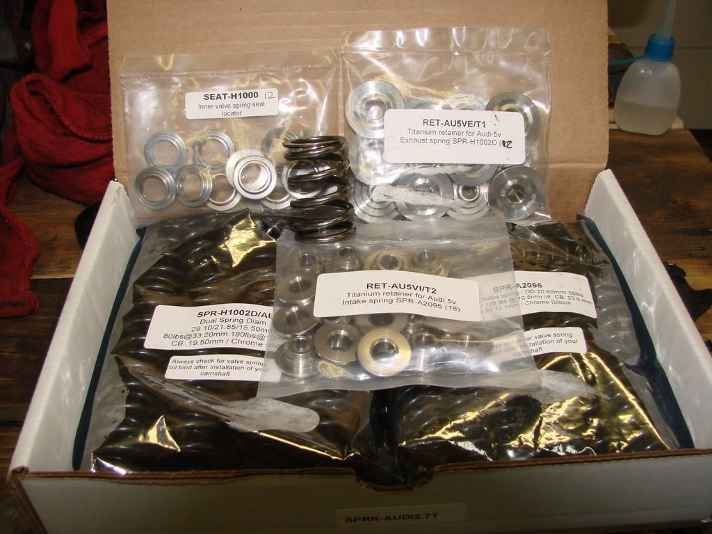

    You need a b6 3.0L crank, custom rods and custom piston ( almost 4000$ here )
    I did only rods, with stock 1.8t pispons ( cost about 1500$ including labor and balancing )
    The money I saved on the bottom end, I invested about 1300$ in my heads.
    My 2.7L will redline at 8200 rpm, it will largely compensate for staying a 2.7L instead on going 3.0L.

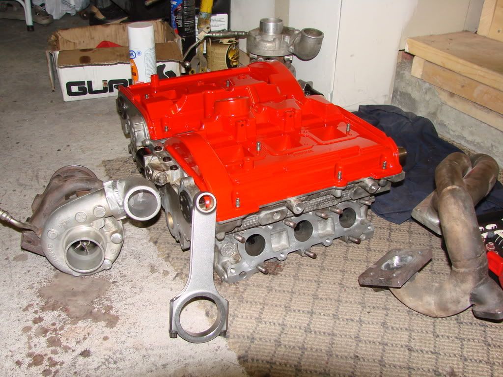

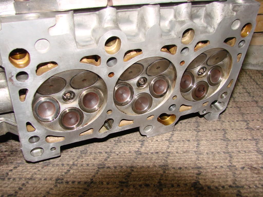

    As an update on my situation, my guy at the local machine shop called me today saying that 2 of my pistons were damaged on top of the rings. Cylinders looked fine but, I just ordered a set of JE pistons wich are gonna be 82.5mm coated top and skirts.
    Compression ration is gonna drop to 8.5
    In doing this, I changed my mind on turbos, it wasnt too late. I'm ordering a set of gt2860rs (disco potato) turbos.
    Block will be the a 2.8L, you see I'm getting closer of beeing an original A4.....
