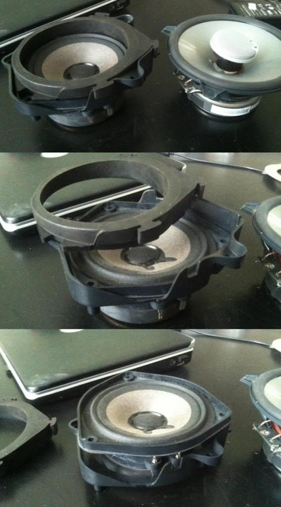

    :Stock speakers and brackets pictured
    :Final installed reference speaker pictures
    :hardware pics
    :Silicone pics
    :stock torx screw reusing pics
    :dremeled out pics

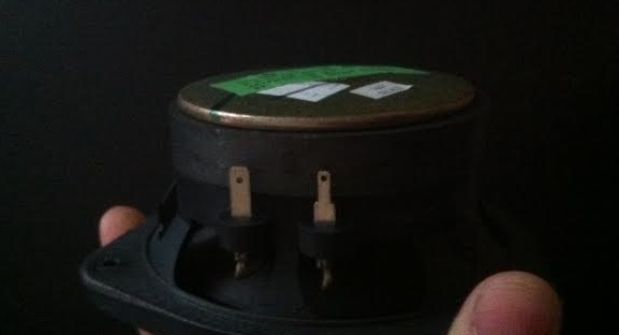

    its two wires, why would you need a harness?
    The factory ends in my 01.5 didn't look to need anything to slide over the clips on my Infinity reference 5032CF. I say "look" as I had it all apart to test fit but haven't made the adapter rings yet to fit the larger than stock speaker.
    EDIT
    Here is a pic of the terminals on my stock bose that I currently have out of the car:
    Most aftermarket speaker's terminals look pretty much the same. So no harness required in my case.

    I haven't made the mounting adapters yet (the speaker in the photo is blown, so I removed it until I get the replacements in). The weekend weather has been too poor for me to get motivated to pull out the MDF and jigsaw. I can post them up when I do finish them though. If that would be helpful, or if anyone wants to see what they end up looking like I will gladly take a few pics along the way. Its supposed to rain again this weekend but if I get some sunbreaks maybe I will finally be able to tackle it.

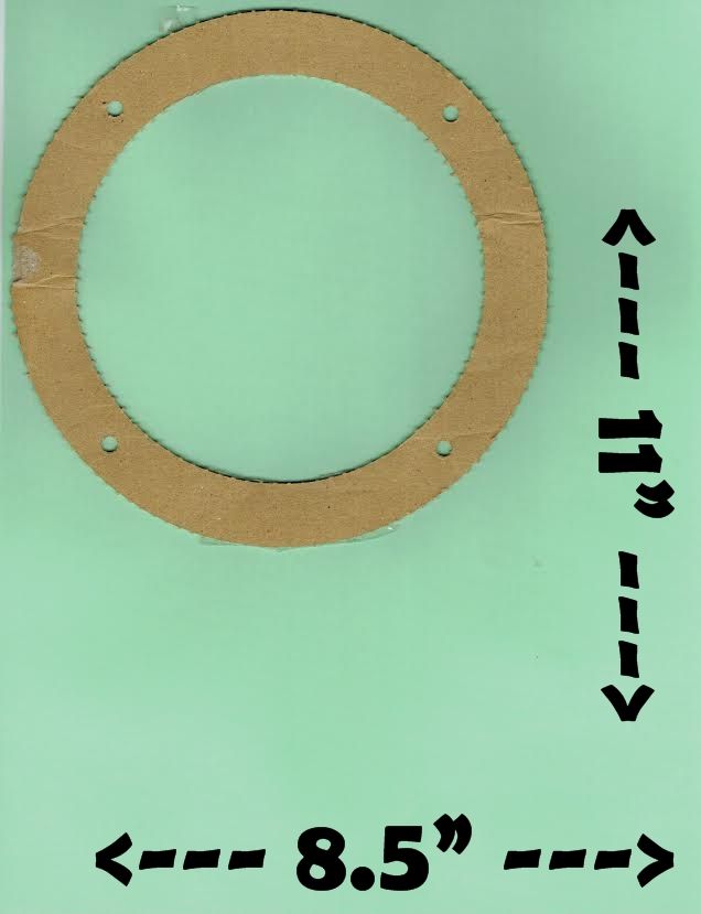

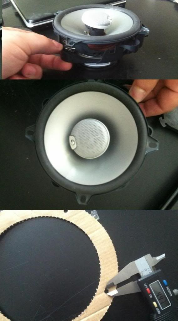

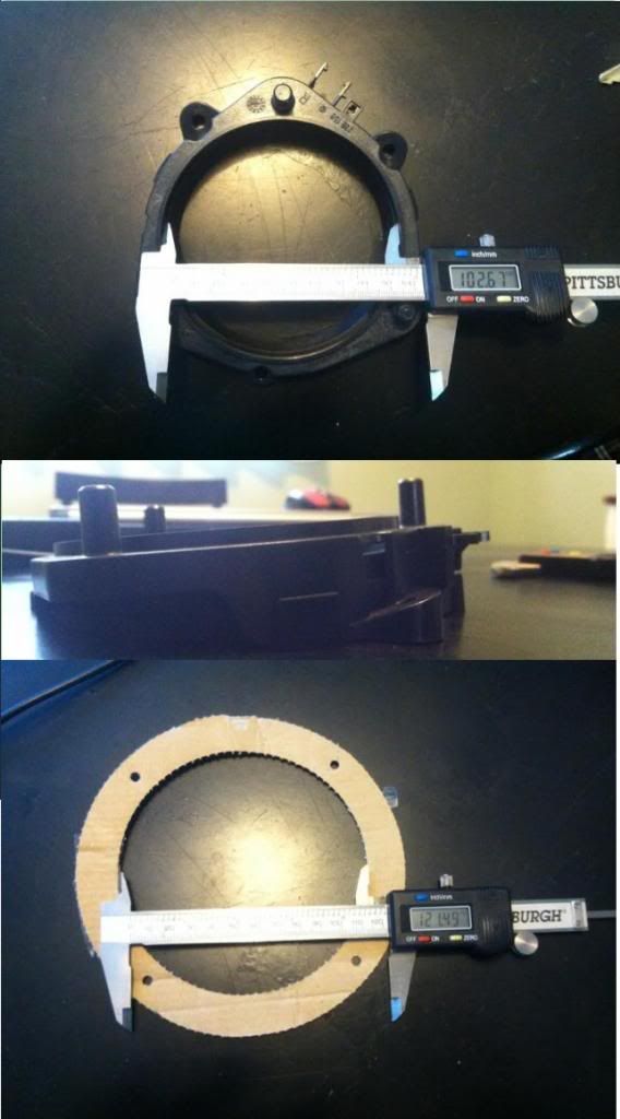

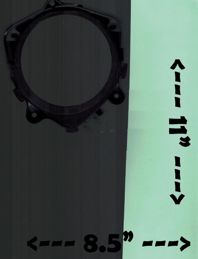

    rdcyclist maybe these will be of some help. I just took the Infinity Template and scanned it on a piece of 8.5" x 11" paper for size reference as well as a printable template, and I did the same with the bottom of the factory mounting bracket.
    I also took some rough measurements with a digital caliper and a side shot so you could see the slop of the factory piece and the slanted mounting angles. Hope some of this is of some use:
    Keep in mind these are larger than stock speakers for the front, I dont want to confuse anyone into thinking these are the 4" versions

    Thanks for the pitchers. I'm gonna hafta wait until I get the speakers and get into my doors so see what's the best way to fit them. That angle is concerning. I was anticipating being able to make a flat adapter. Maybe I'll just adapt the Infinitys to the Bose adapter. We'll see.
    If you could measure bolt circle diameter on the Infinity template that would be a good start for me.
    Sure thing, here are some other examples just to help you give you a better idea of the stock bracket an how it compares to the larger infinity. Just to help you plan ahead

    This is going to be interesting. Thanks for the images. I wasn't clear on the bolt circle diameter dimension; I need the diameter of the pattern of the holes in the template. That'll give me and idea of the size differential of the speakers and what I'm adapting.
