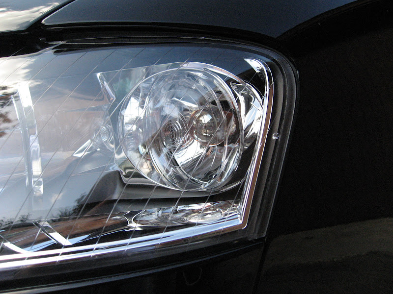

    I did this writeup because I found the information on this topic a little sparse. I posted this on AW because I like the HTML formatting there. I regularly check both boards so I'll try to answer any questions you all have!
    http://forums.audiworld.com/a4b7/msgs/93217.phtml
    Keywords for future searches...
    Installing installation bi-xenon bixenon ecode hid headlight headlights
    Without removing bumper removal
    New Kufatec harness pins 21 and 22 gray grey connector

    Ok, i've been looking at getting actual HID projectors for my B7 A4, and i'm wondering, are the pins that you're running to the inside of the car for the Bi-Xenon motor? What are ECode headlights? How are they different from normal Audi hid headlights, or are they one in the same? I'm a tad confused, and was hoping the headlights would be somewhat plug-and-play, but life can only be so simple. *sigh* Thank you.

    What does this DIY EXACTLY do? I have clear corners, so how does this benefit me?

    First of all, yes, the pins you run inside are for the bi-xenon motors. These wires will not be activated as the "high beams" in your car until you recode via VAG-COM.
    Next, Ecode == Eurocode, and this means that the bi-xenon lights have OEM clear corner lenses instead of ambers that must be removed (US bi-xenons). I've been told that older ECode bi-xenons (for one example, on the RS4) in fact had amber corners like US bi-xenons. Physically and electrically, the ECode and US bi-xenons are exactly the same, and the installation process is the same.
    Some have said the beam pattern is a little different between US and ECode bi-xenons, but I can't verify this. The upgrade is expensive if you already have US bi-xenons and can just hammer out the amber from your existing lights. If, like me, you had halogens before, it makes sense economically to pay a little bit more to get the bi-xenon upgrade AND the ECode clear corners at the same time.

    I ran ECodes on my 2003 Jetta. they were great with the exception of the reflectors were set up as if it was a Right hand Drive car. Do the HID's in these level off for Left Hand US driving? Do the lights still turn when you turn a corner?

    The cutoff for the lights looks something like this:
    __//---
    The lights do not turn because I did not install all the necessary sensors, etc. It is possible to retrofit this stuff, however.
