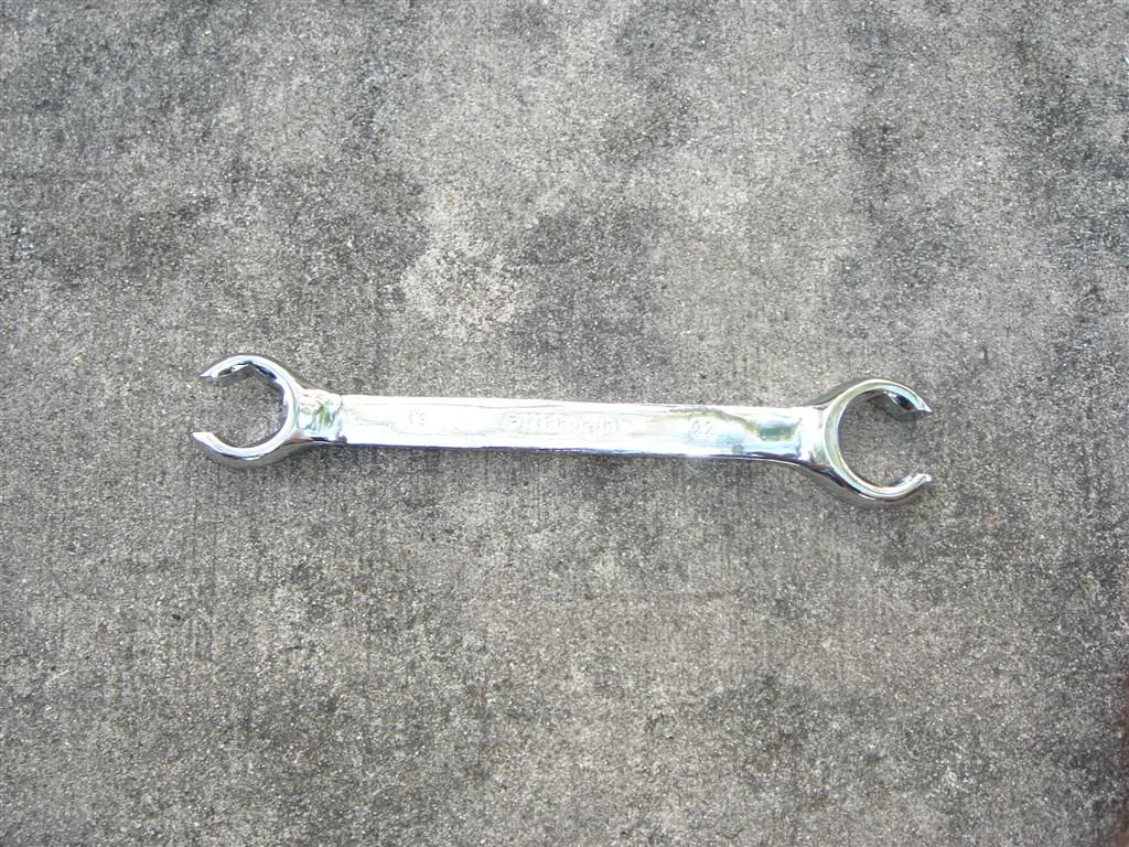

    22mm Hydraulic wrench ($9.00 for the set at Harbor Freight)
    First, how the wrench looks like

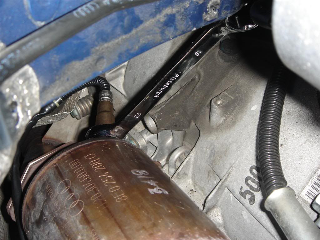

    The post cat O2 sensor location

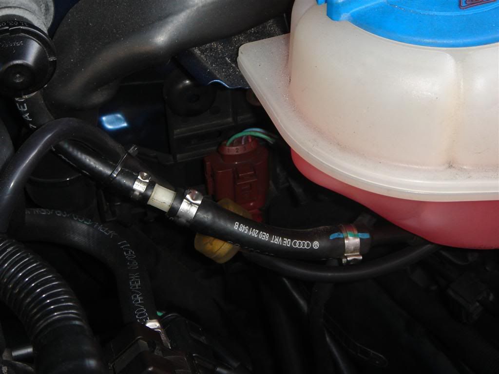

    Disconnect the connector located right behind the coolant reservoir (Color Brown)

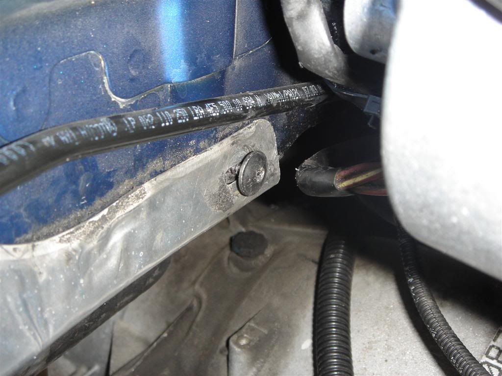

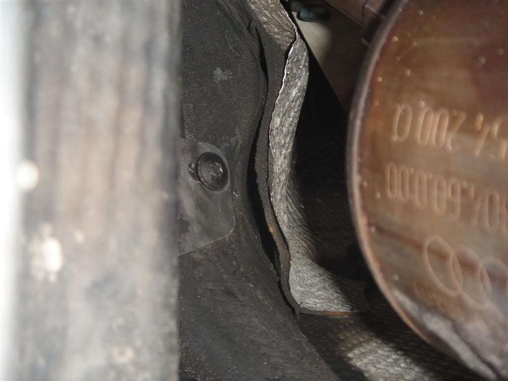

    Then, to clear the wrench length, remove the heat shield hold in place with 3 screws.
    First one

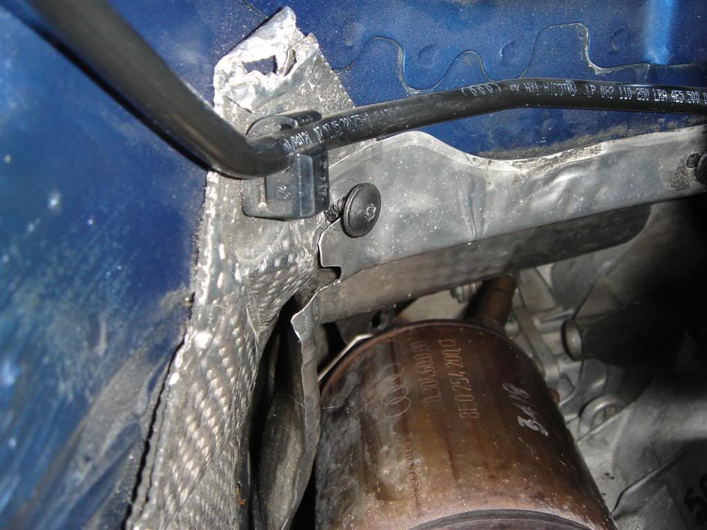

    Second one
    Third one (this one will require the ratchet extension)

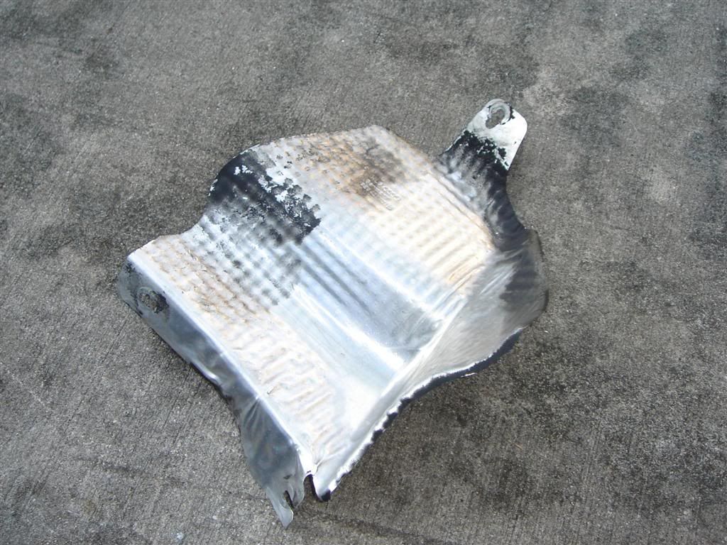

    Now the heat shield is out of the way
    And you have plenty of room now for the wrench

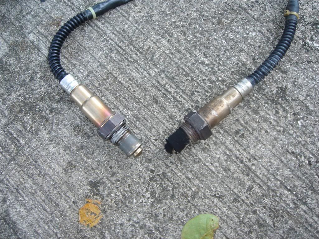

    The old one was in pretty bad shape
    The threads of the new unit come already greased with anti-seize. When you install the new unit, make sure that you don’t pollute the tip of the sensor.
