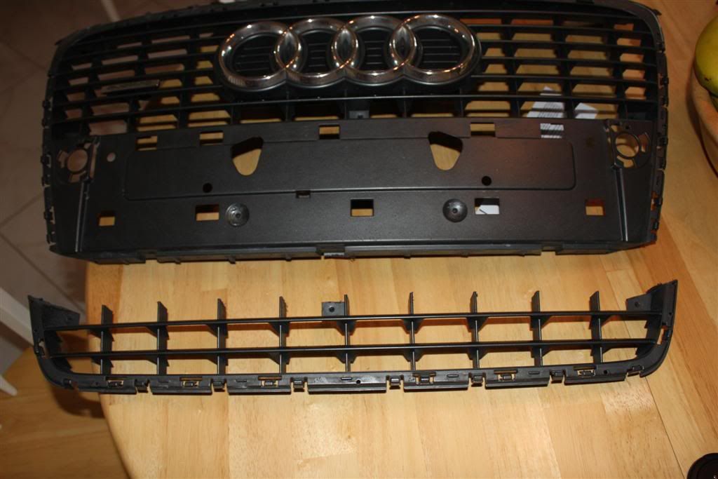

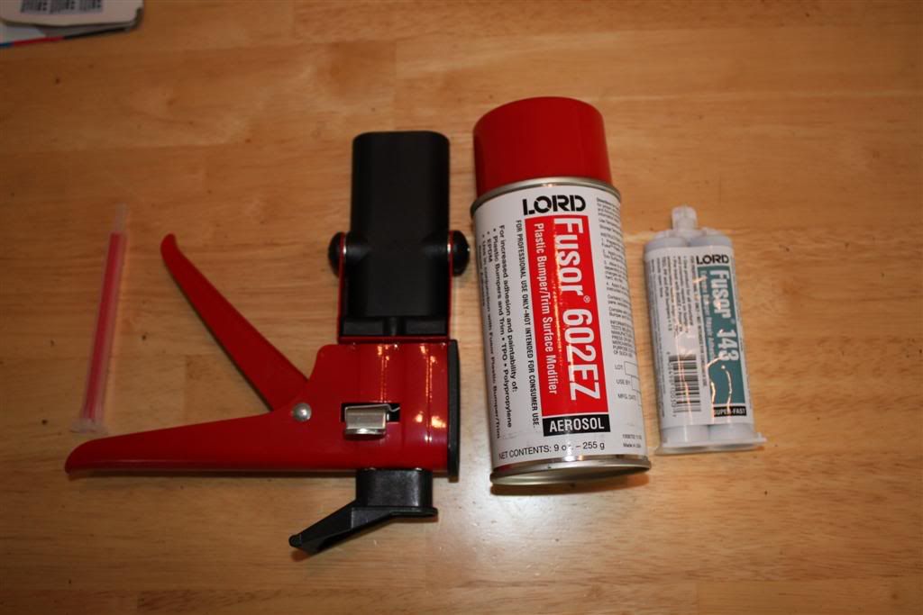

    You need these Materials. Don’t take any shortcuts; this is the best stuff that will give you the best results! PM me if you need a links where you can find them. Because I choose the Fusor with really fast cure time (2 mn), I suggest you order more than one mixing nozzle (left on the picture). I used a total of 6 for this project.
    So, here is your challenge

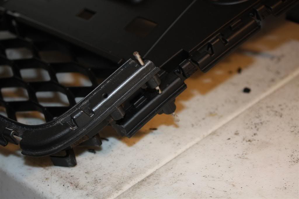

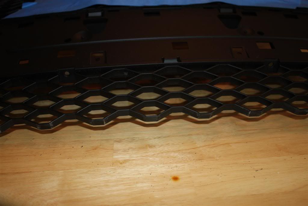

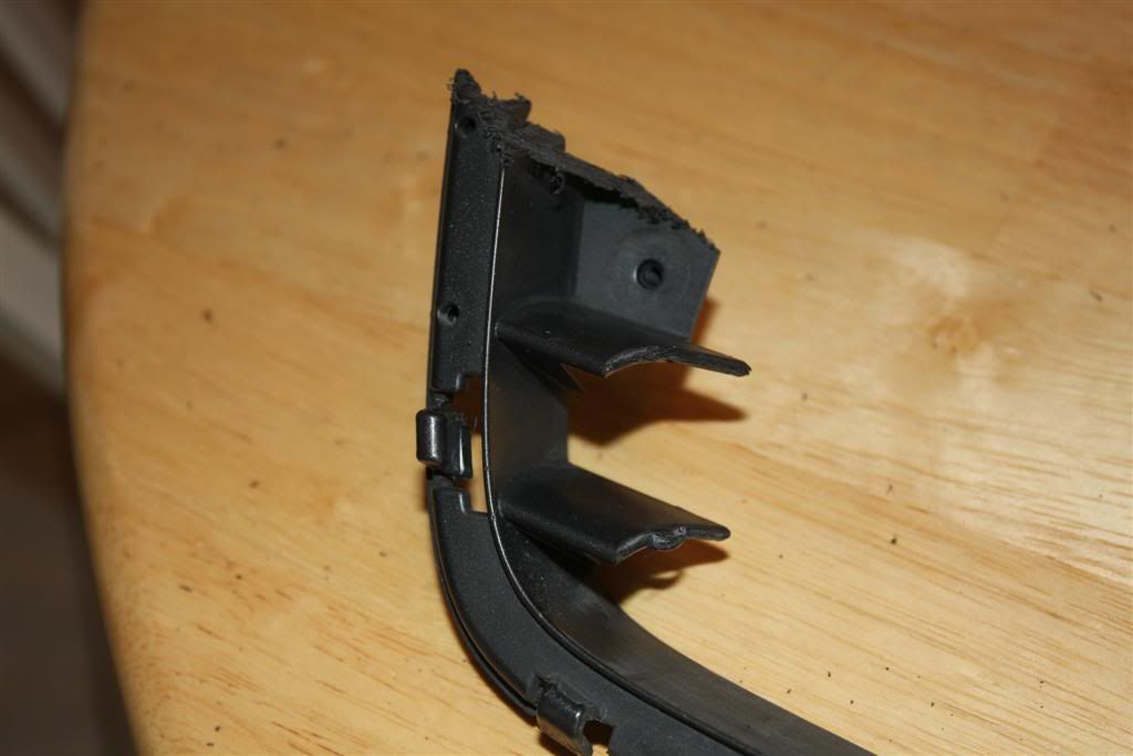

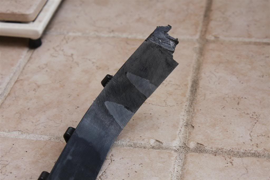

    Using the Dremel, start to cut the bottom piece of the non S-Line grille right below the plate holder. Cut the sides to keep the holes, we will use them later on.
    Should look like this:
    Then

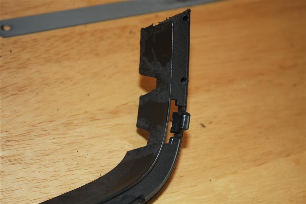

    And the 2 holes that you need to keep, above the plastic clip

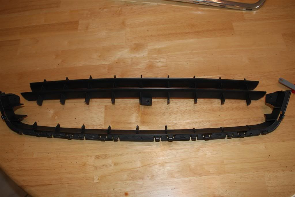

    Now, on the bottom and each side, you are going to grind down the fins left over until you get this:

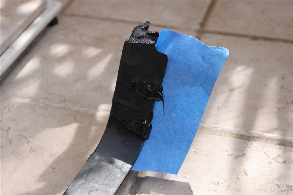

    You are now going to fill the 2 cuts on each side using the Fusor. Put a piece of tape on the back of the trim and use the gun to apply. Hurry, it cures in 2 minutes.

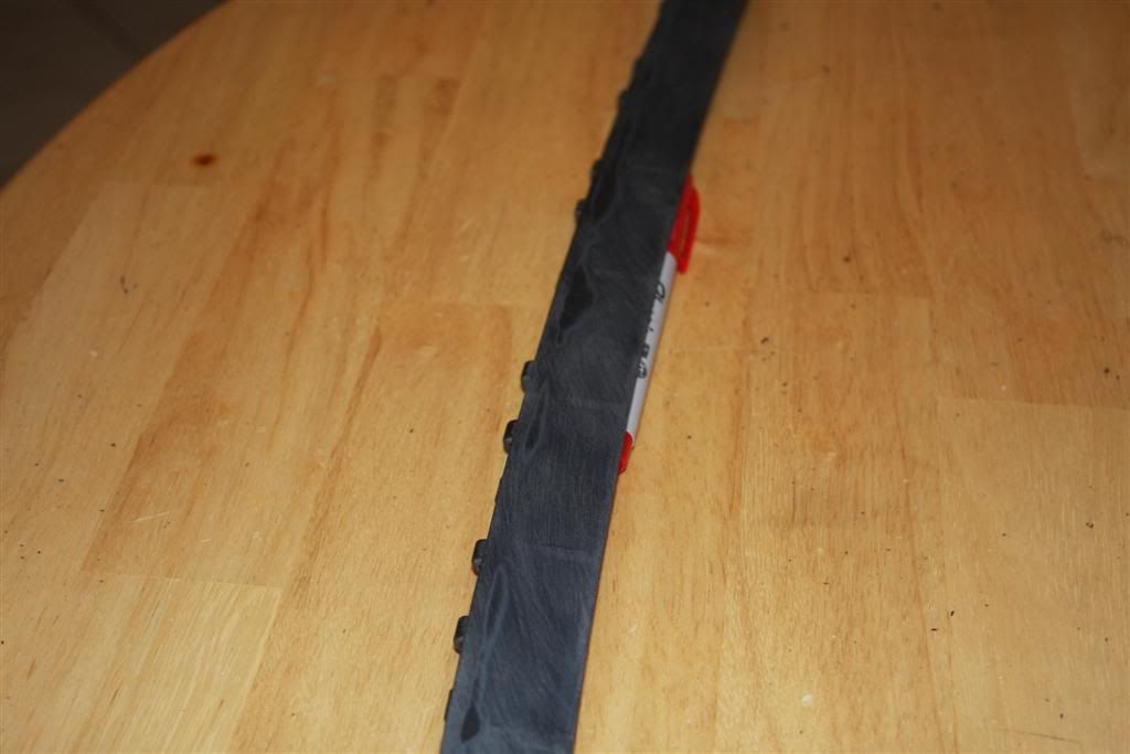

    Then, using Dremel and sand paper, smooth up the profile
    You are done with this one, you can have a beer…..Crap, 10:30 AM, let’s wait a bit for the beer.

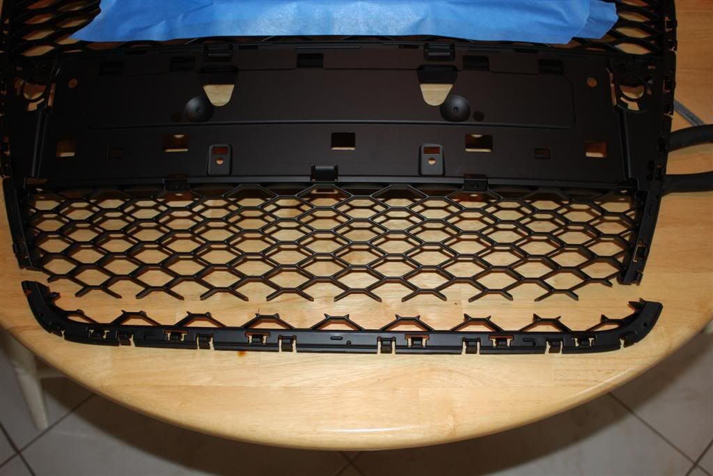

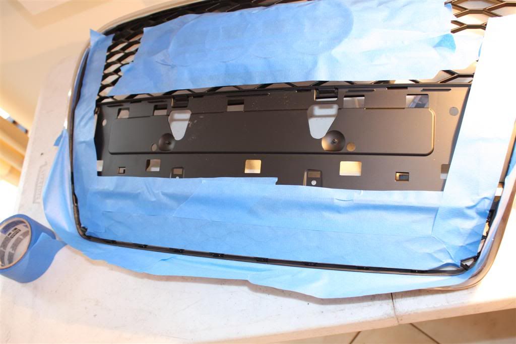

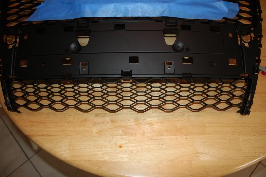

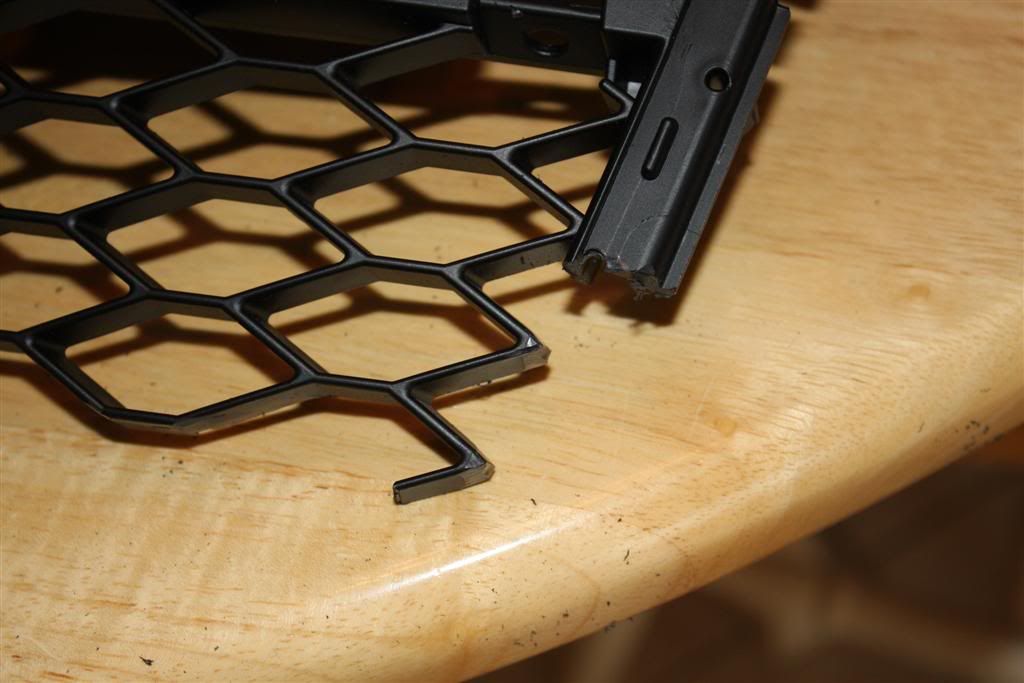

    You are now going to cut the RS4 grille as such
    Then, using a box cutter or the Dremel, trim down the remaining tabs like this.
    Leave the sides as shown we will cut them later on

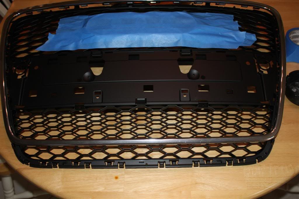

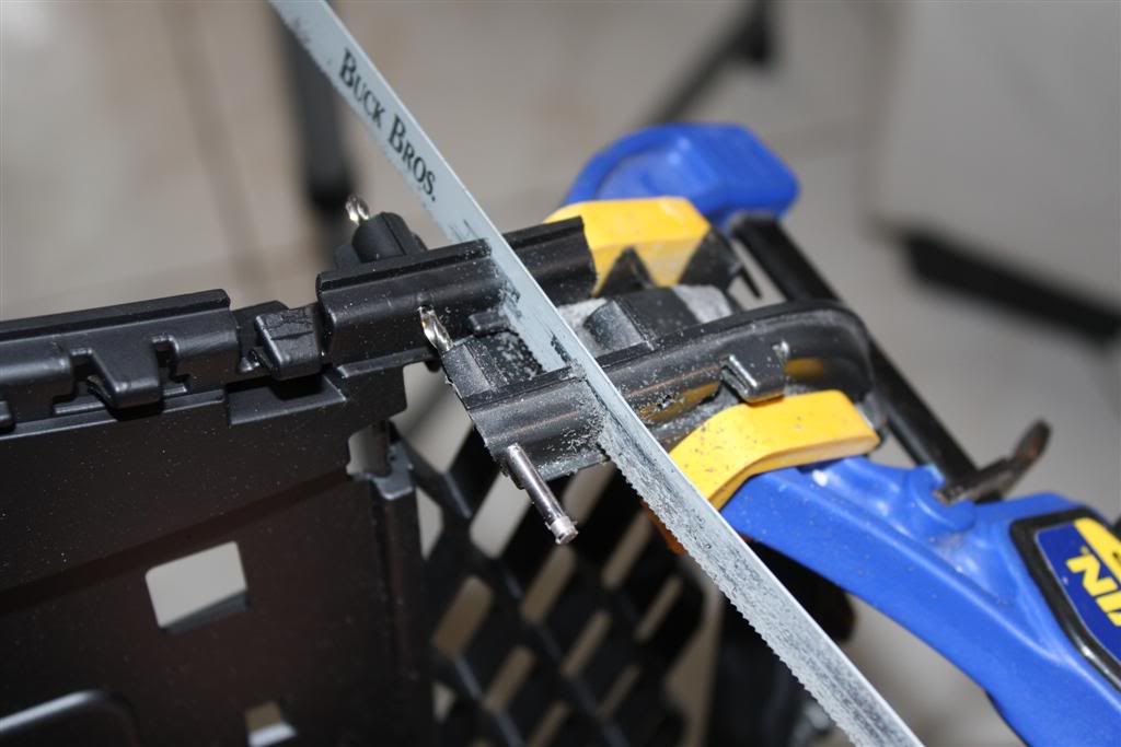

    Now, the little trick:
    Superpose the old trim with the new one and use a drill bit to center one from each other. Do that on both sides
    You can now, using a hand saw blade, cut both piece at the same time and obtain a perfect and identical cut on both piece

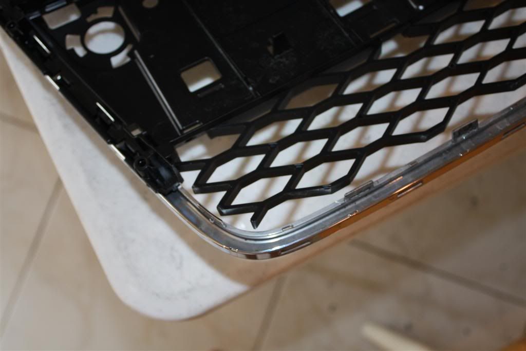

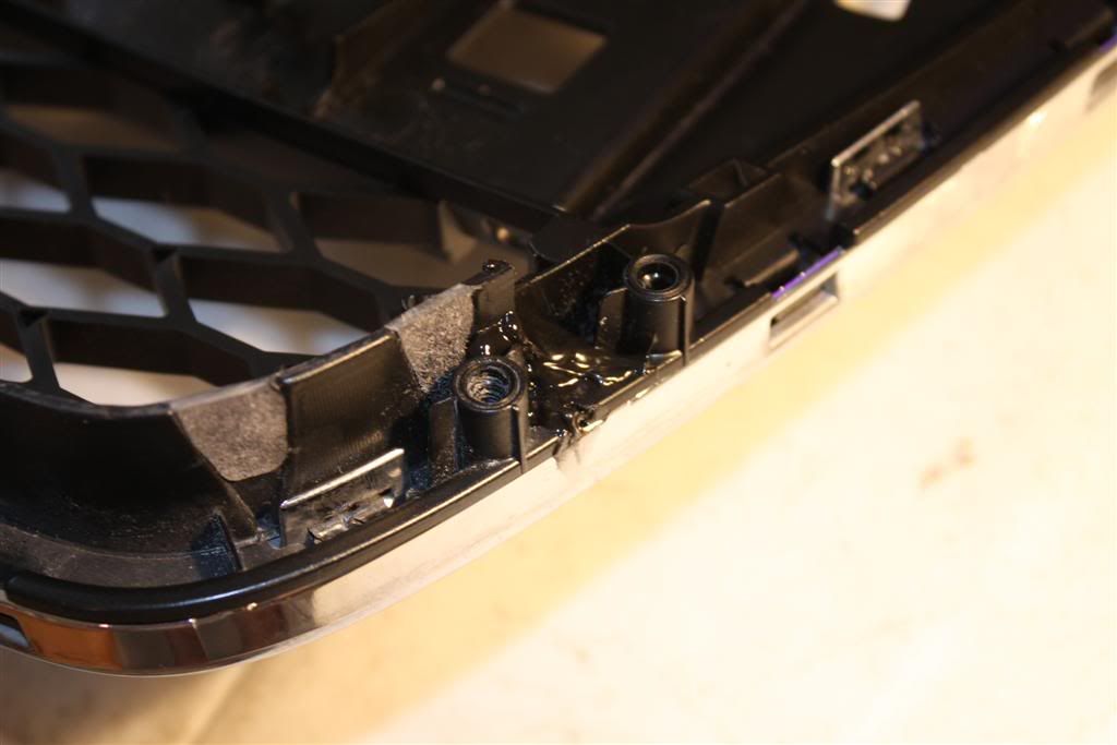

    Reinstall the non S-Line chrome trim to the RS4 grille
    Now insert the non S-Line piece to the chrome trim and cut the 2 corners that we left over as requested. Then, using the Fusor, secure the 2 pieces together

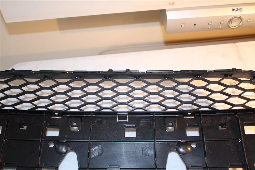

    From the back of the grille, secure using Fusor, each little square to the bottom of the non Sline trim
    The added piece was not exactly the same color so I sprayed some flat black
    Guess what, you did a great job and have now a RS4 grille that fits a DTM Bumper.
