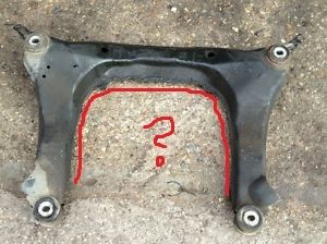

    Does anyone have any annotated pictures of where to weld the subframe? Or is it obvious based on where it seperates? All my front suspension is recent, but know the car is clunking and popping when the front of the car undergoes any torsion or braking stress.

    I searched and couldn't find any pics but if you have a spot welder you need to reinforce the crimps along the inside edge of the subframe. That is the area that causes the creaking and popping.

    Awesome, thanks for the reply. Do you mean here? I haven't gotten completely under the car to take a look yet.

    That is correct.

    I have this issue on my car and was planning to take a closer look at the next oil change (due now). I have a spot welder - just wondering how restricted I'm going to be from an access standpoint. Has anyone actually done this job with a conventional spot-welder with the engine in place?

    i had a muffler shop weld all the spots shown in that pic and it didnt help with random pops/clunks and other noises. Guess im off to inspect suspension/steering components again.

    I'm getting ready to get my subframe welded up soon.
    Does anything electrical need to be disconnected before welding for risk of over juicing components?

    I always disconnect the battery ground before doing any sort of welding on a vehicle.

    I just did mine a few months ago. I didnt disconnect anything and Ive had no problems....but its a good idea to disconnect the battery
