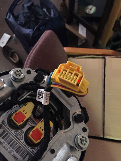

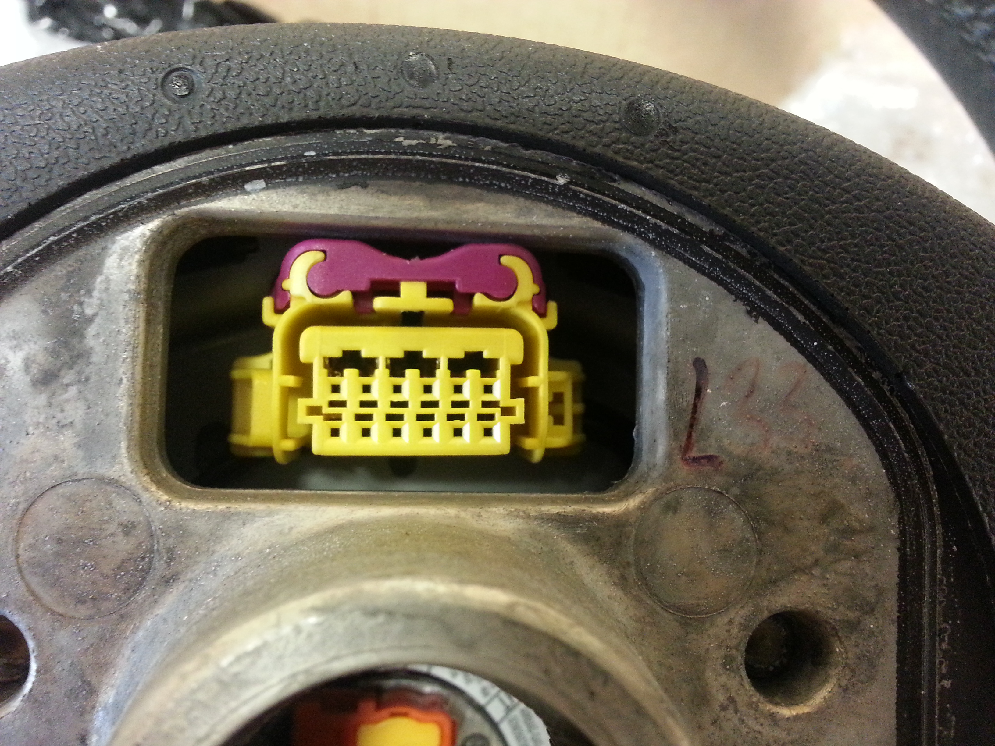

    This is the RS4 connector:
    This is your connector with the parts that need to be removed marked in red:
    And these are the instructions I followed, it's pretty easy to figure out once you have the 2 harnesses next to each other, just make sure each of the wires on the new harness goes to the same pin as on the RS4 harness.

    Ok great shouldn't be too tough. Making the connectors physically fit though. What parts am I shaving/ removing and will it still lock into place?
    Dec 28 2011
    85832
    2007 RS4, 2008 Q7, 2005 4Runner V8, 2001 Impreza RS
    Upstate NY
    I colored them red above, you need to shave off the 2 "ears" sticking out of the inner part of the plug. When you have the 2 plugs side by side you can see the difference pretty easily, on the TT plug they're much wider than the RS4 plug and won't fit into the socket on the roll connector.
    The latch itself is the same, the plug will click into place on the socket just like the RS4 one does. It just doesn't have the purple secondary latch, which I guess they dropped in the later years.
