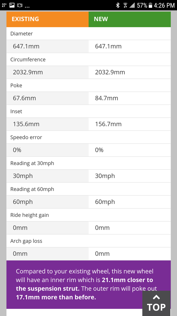

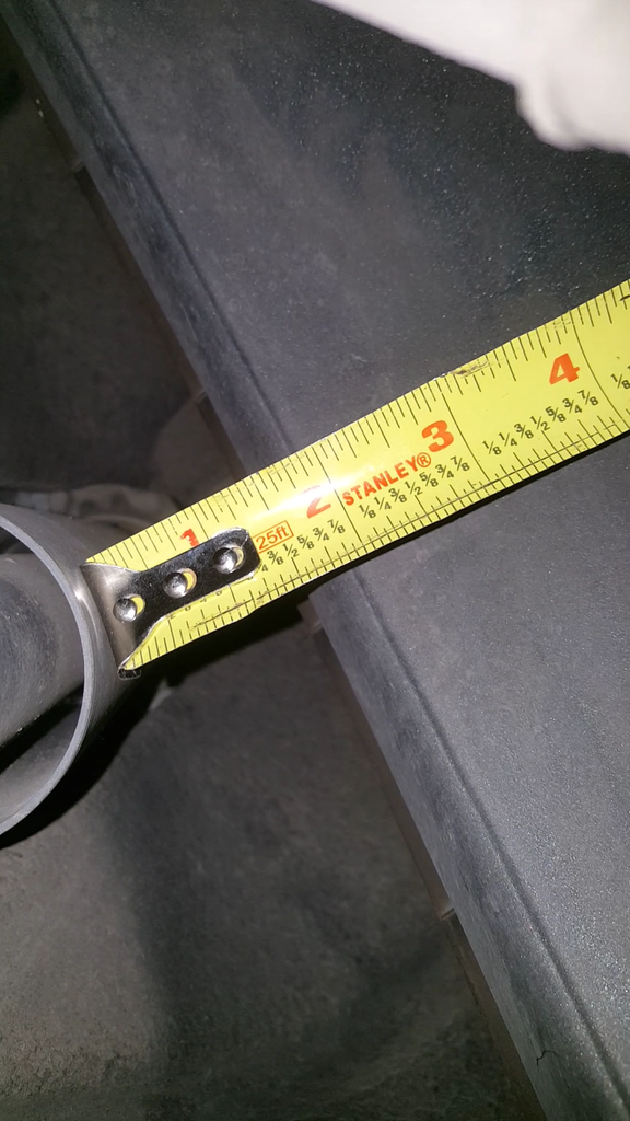

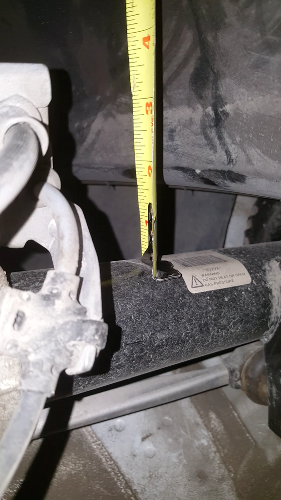

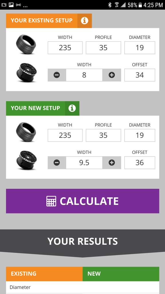

    So these would fit then 19 x 9.5 +36....... but would stick out 2mm further

    Yes that will work
