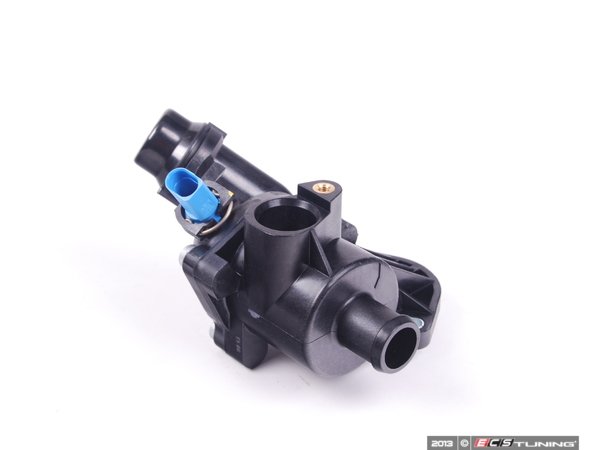

    Just an FYI. The thermostat opens mechanically just like any other thermostat. It also has a heating element in the wax that allows the ECM to force the thermostat open under certain conditions. Sounds to me like a faulty thermostat.

    Here is how a conventional thermostat operates. A map controlled thermostat is created by adding a heating element to the wax capsule so the ECM can apply power to the heater and force it to open sooner and or stay open longer depending upon specific engine conditions. Without power to the heater the thermostat will still open once it reaches the required temperature.
    Wow this is really nice to know. You definitely know what your doing sir! I've seen a couple of posts from you and you seem very knowledgeable!
