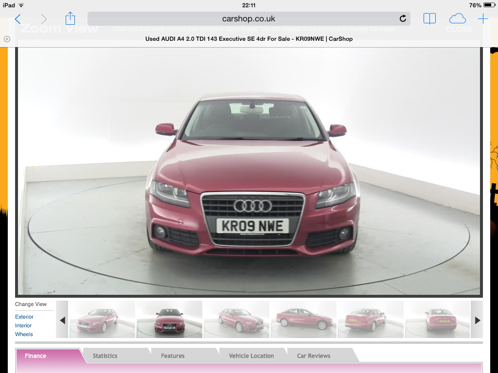

    heres a picture of the car when I got it
    [IMG][/IMG]

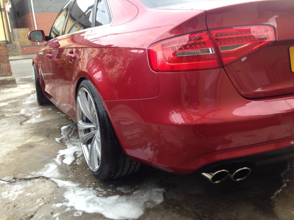

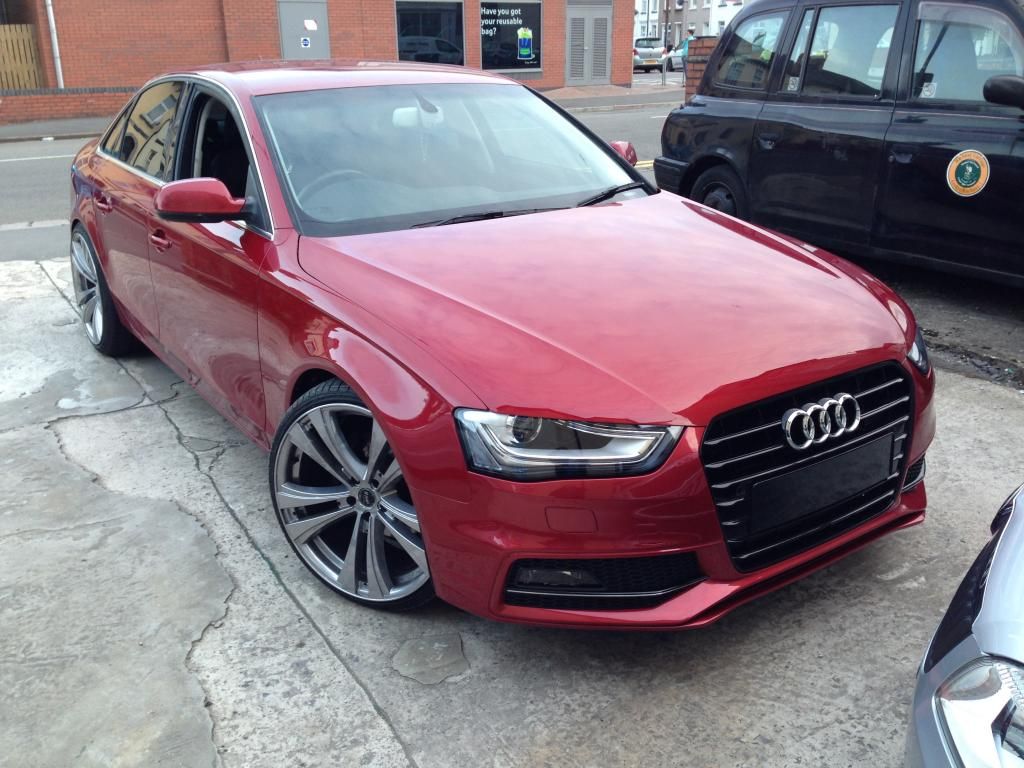

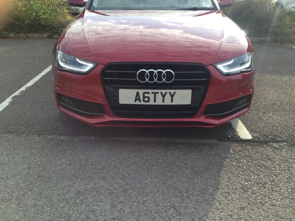

    and now
    [IMG][/IMG]
    [IMG][/IMG]
    [IMG][/IMG]

    Can't say I am a fan of the wheels - but it looks like you did a really a great job on the conversion. Love the .5 front end. Nice work

    Thank you, wasn't as bad as I thought it would be and wasn't no where near as expensive as a lot of people said it would be. Lol the wheels, I love the concave look and they grow on you a few people said the same thing then they have said afterwards they growing on them, 9j o. The front and 10 on the back in 20z come out ok
    all the work was done @ GWENT VW / SJ CONCEPTS so just wanted to thank them and if you have any questions SAJ would be happy to help email is [email protected]

    Wow! Excellent work!

    Looks great, nice job!

    That is amazing. Nice work!

    Car looks amazing! Love your wheel/ tire combo!

    The back end cost me £700 that's parts and paint
    Front end unmm at a guess I ain't say down and worked it out cost me about £2000 was under that just rounded it up and done all the work myself so no labour but in fairness my mates garage got me parts trade price from tps and the bits I could get used I got from ebay

    Thank you
    Wheels are wheelmania savoy front 9j with 245/30/20 and back are 10j with 265/35/20 (originally where 245/30/20 but we're too stretched for my liking) but will be changing them to 255/30/20 tomorrow as they rub now lol. They came off a mates merc so offsets a little wrong they stick out too much
