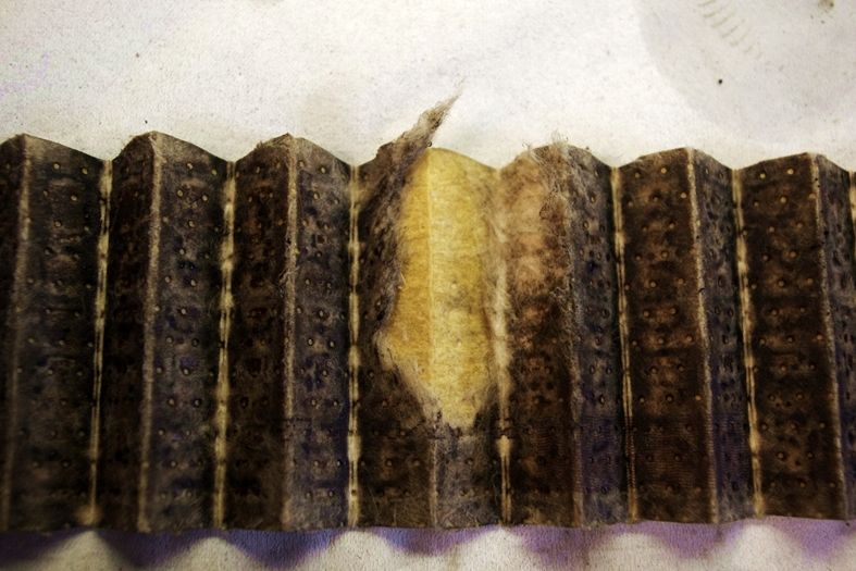

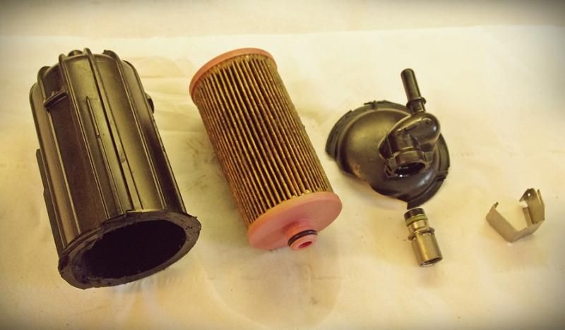

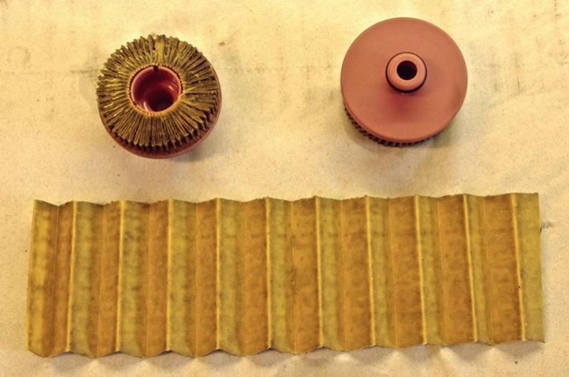

    I finally got around to changing my fuel filter (8k0 201 511 A). BE CAREFUL removing the retaining ring on the fuel pump cover!!! One slip and you're buying a whole new pump! Plastic nipples do NOT resist to sharp impacts. Anyway, here is what your B8 filter is all about .Why is it so expensive? Maybe 'cause it's pink on the inside... ($120 CDN for an aftermarket? no thanks! Europaparts savings will pay for shipping on that alone, almost.)
    Exploded unit: Casing, filter element, inlet cover with pressure release valve and grounding shield
    Filtered side of fibre/paper element:
    Filtering side of element:
