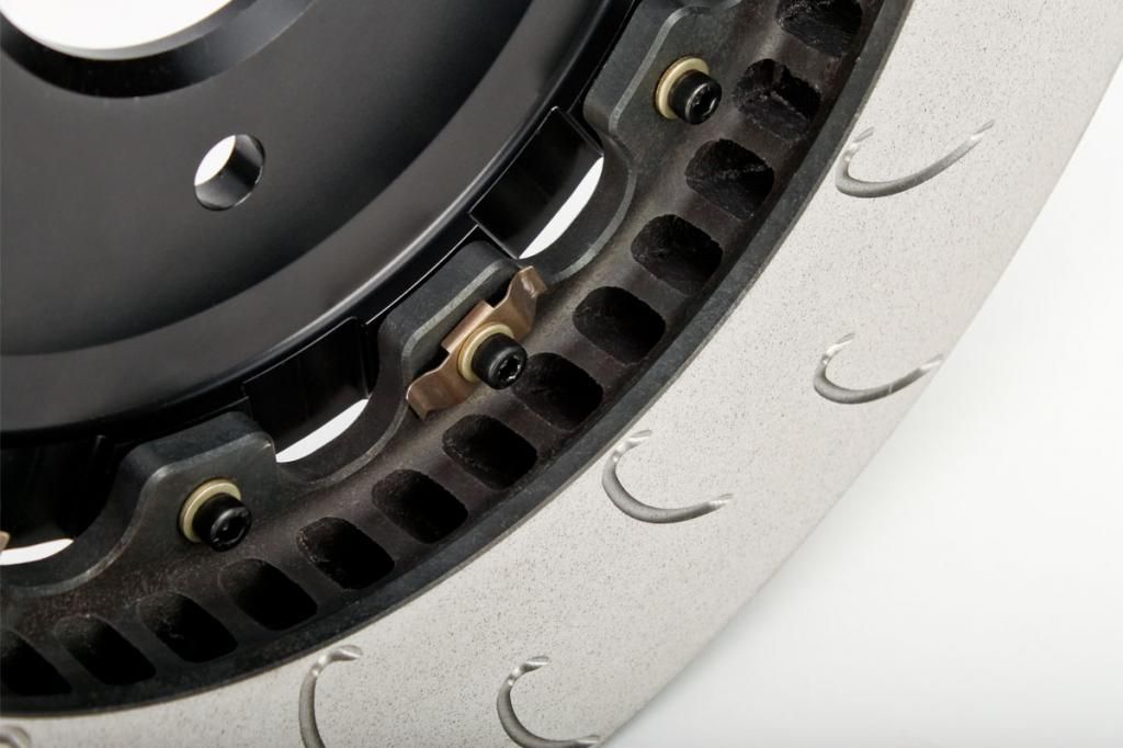

    Ok, we buy these kits mainly for their performance not looks. Here's my setup:
    Front rotor: 370mm x 36mm cross-drilled and slotted two-piece. Rotor weights slightly heavier than OEM. If you are looking to save some unsprung mass, may want to try something else.
    Rear rotor: Stillen cross-drilled rotor to match the look (OEM drop-in replacement)
    Pad: Ferrodo DS2500 front and rear. This is the pad of choice that came with the kit. It is a semi track/street pad. No noise but quite dusty. Brake dust shows an reddish hue in direct sunlight. Will need consistent cleaning. They takes a few brake applications to warm up until they really start to work, which was annoying at the beginning but then I got used to it.
    Fluid: Torque RT700. Much more expensive than the common Motul RBF600 but well worth the price. I've been to two track events with them. Pedal remained firm and no need for bleeding. I say put your brake bleed money onto the right fluid.
    SS brake lines front and rear
    I had little issue daily driving with this setup. Nor are there much benefits other than the all-mighty look of the BBK.

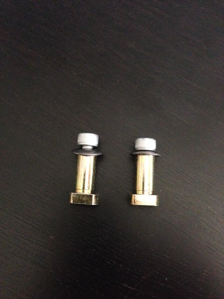

    I think even little things like not having a set screw would tick me off.....its the little things, you know.

    Sure. There are not a lot of things that you can do different on a street BBK, but some of the differences are listed below (not totally knocking Stoptech as I have been reasonably happy with the two BBK I have had). I know there are some things posted here that don't sound so great about the AP kit, but I feel pretty good about them working the problems out. Stoptech has had several issues reported on the B8 S4 forum alone... ABS lockup and rotor noise being the most common.
    Caliper:
    The AP Racing caliper has a larger pad area (108.9cm2 for AP, around 80-90 cm2 for the ST-60-- Stoptech doesn't publish their exact specs, but it is 152mmX51.5mm where the AP is 175.5mmX73.5mm). The AP also has two fewer bridge bolts that are always a problem area on Stoptech calipers. The AP caliper has material removed in areas it is not needed (Stoptech only does this on their "Trophy" kits). Both are forged two-piece calipers....
    Rotor:
    AP has proven to make some of the best rotors in the world, and their metallurgy is second to none. J-Hooks, and AP rotors in general, are better rotors (very subjective I know, but search NAGTROC forum, or ask anyone who really cares about rotors if you need proof). Stoptech Aerorotors will not last as long as AP Racing rotors (I've replaced mine with DBA rotor rings which have last longer and are cheaper). Stoptech rotor hardware is known to be noisy, and is not a floating design. They use a tapered washed to separate the rotor hat from the ring. The AP is a partially floating design, but also uses anti-rattle hardware. See pics below as evidence. Obviously with the Stoptech you can get a slightly larger rotor at 380mm vs. the 370mm offered on the AP kit.
    The AP kit also comes with Goodridge brake lines and Ferodo DS2500 pads which I think are superior to what Stoptech supplies with their kits.
    Stoptech Hardware (from my personal collection-- about to replace the hardware on my rotors):
    Stillen/AP Hardware:

    I thought that the rotors were provided by Stillen and the caliper was AP only, but I heard that on the forum rather than from a vendor/installer (so it is rumor). In any case I have put 20 track days on those rotors over the last two years and 15,000 street miles on race pads, and they still have some life left in them. I will replace them prematurely just to be safe, but I could probably get another 1/2 season out of them.
    Veteran Member Four Rings jran76's Avatar
    Jun 20 2011
    77149
    2002 Audi S4
    Plano, TX
    Quote Originally Posted by westwest888 View Post
    I can't speak to the kit you have, but the rotors are made by AP on my kit.
    http://apradical.stillen.com/brake-t...ce-brake-discs

    Aluminum rotor hat (vehicle specific) is by Stillen but the steel rotor is from AP. As you can see, anything application specific (mounting bracket, rotor hat) is from Stillen. AP makes the generic kit parts.

    One small correction. The rotor ring/disk is an iron alloy.
