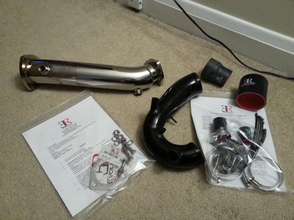

    I got good and bad news this morning. I haven't heard from Evolution Racewerks about shipping my order, so i gave them a call, parts are just now coming in, but I ordered the black anodized finish so that still needs to be applied, but should ship out by Wednesday. I wasn't paying close attention to my huge order request from ECS and the shipment date was set for March 10th, all because a magnetic drain valve for my trans; a quick email to Jason straightened that out and I'll be able to get some maintenance done before the TIP gets here. With all this time waiting on parts, I was thinking I should order a new Clutch and mounts, that was I could pull everything apart once. I'm leaning on FX300 and street density mounts (DD).
    Jan 22 2014
    139742
    Fairfield, Ca
    Today was like Christmas I had 4 packages waiting for me after work. I'll upload pictures this weekend, but I got a ton of parts in. Also finished my ordering frenzy tonight, the last few items were a ECS RSA4 stage two clutch kit, Treadstones TR18T intercooler/piping and H&R front/rear sway bar kit. I purged a ton of money from my bank account, but my build will be "finished".

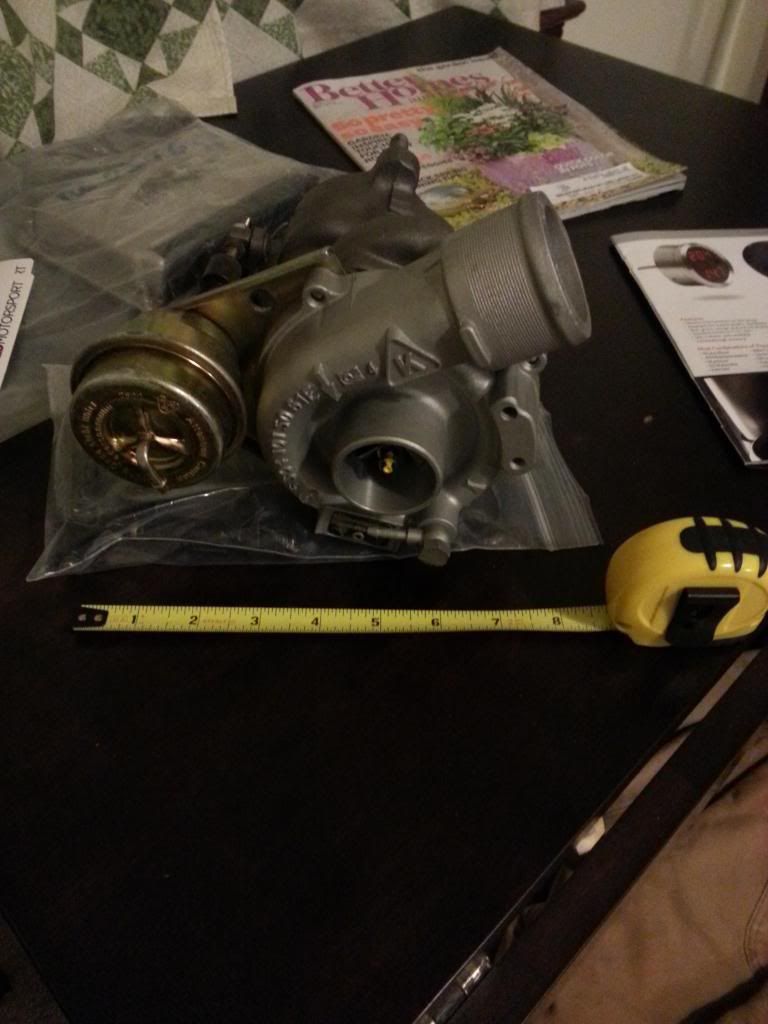

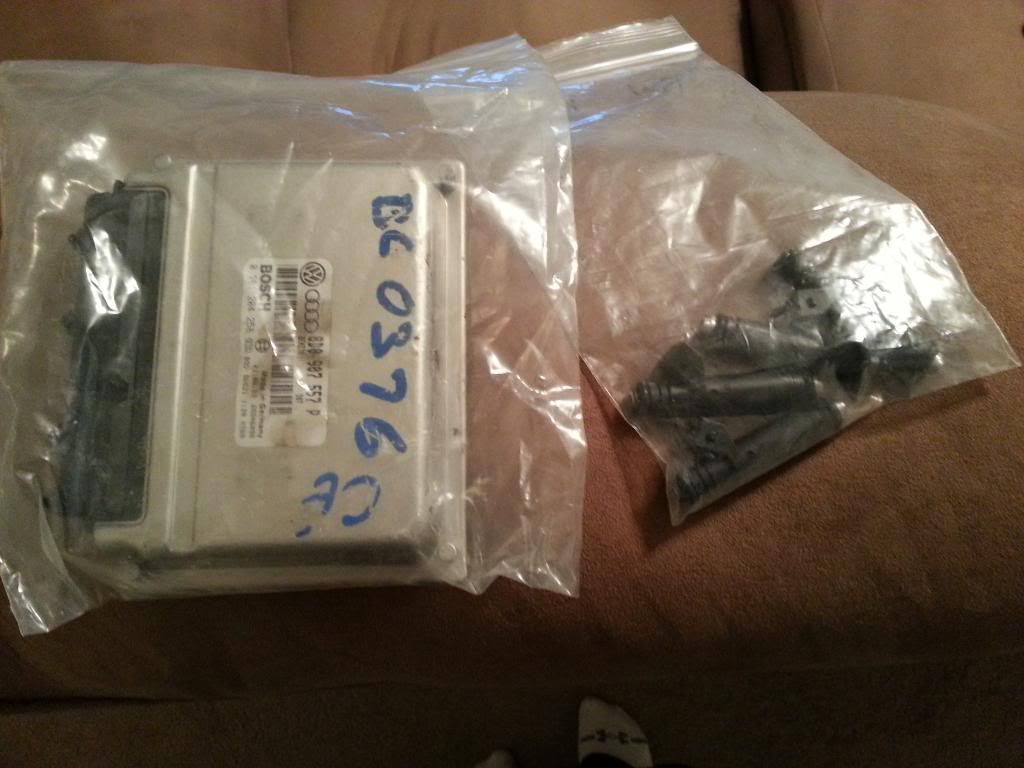

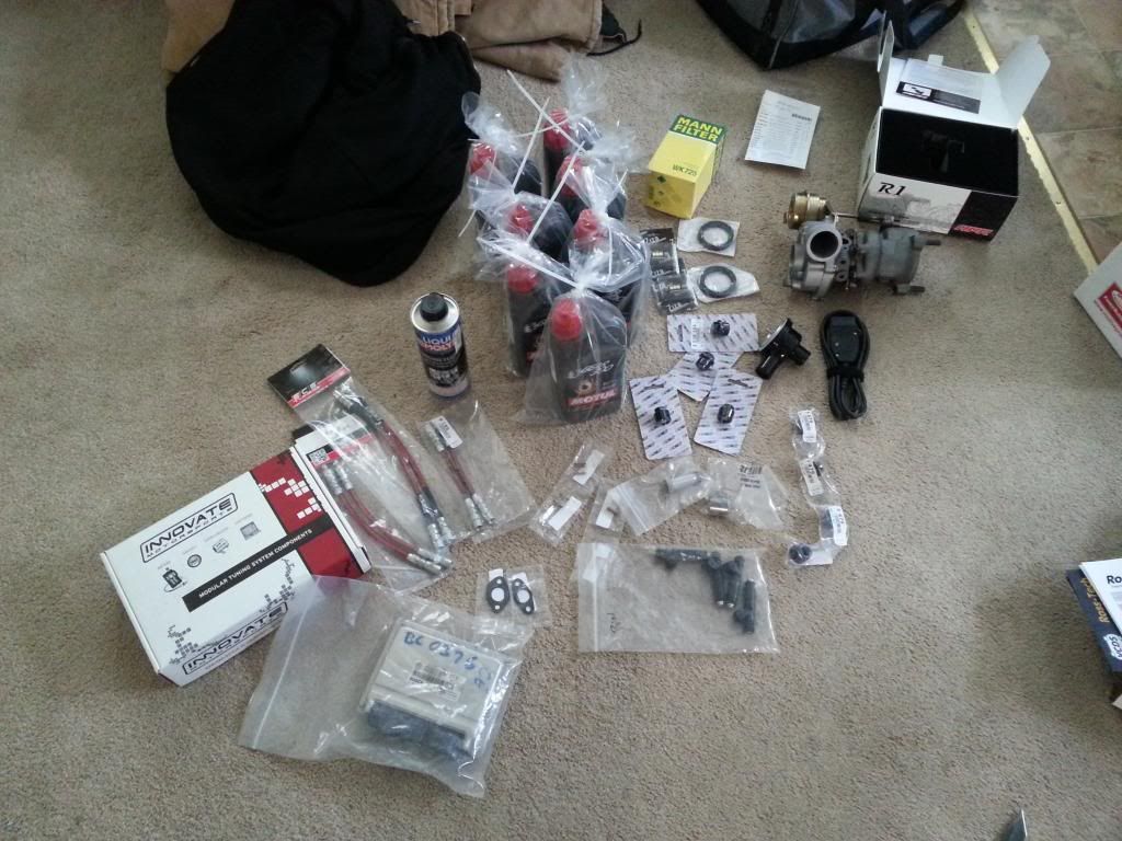

    As promised, some pictures. More to follow as more parts show up/get installed.
    PARTS!!!!
    K04-15, tiny lil guy.
    United Motorsports stage 3 tuned ecu and Siemens 630cc injectors

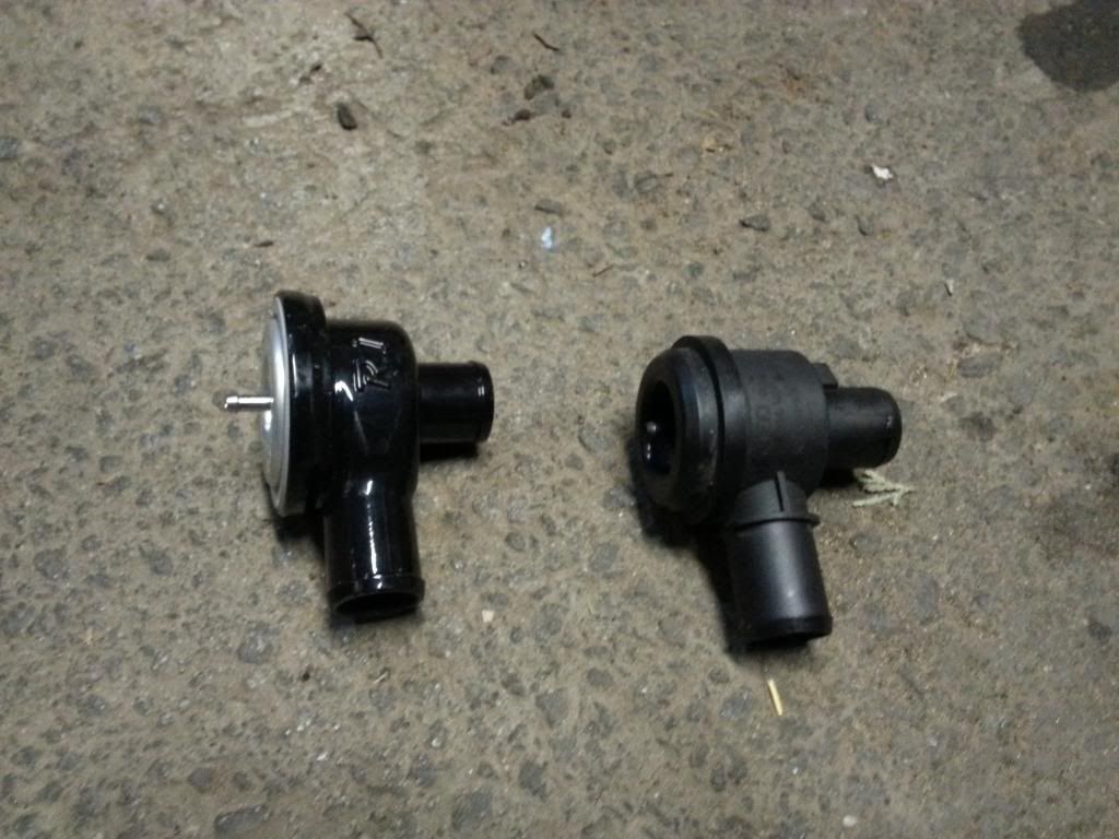

    Out with the old, in with the new, APR R1 DV

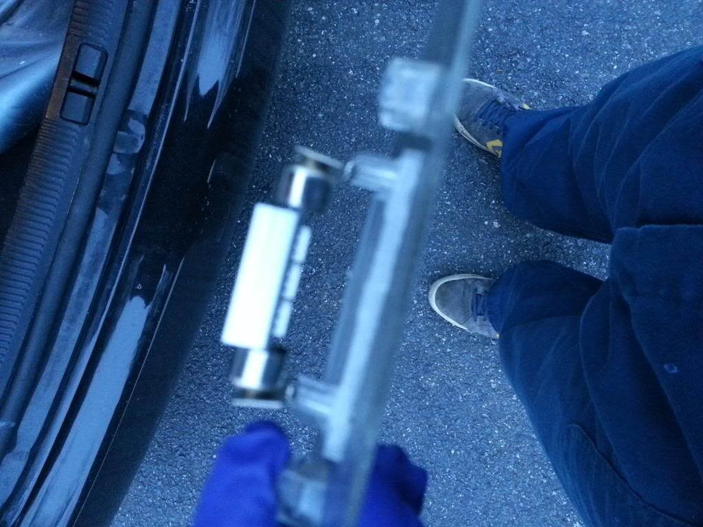

    LED plate lights
    Welcome to a state of solidness

    630cc for a k04? That's a lot of injector.
    Jan 22 2014
    139742
    Fairfield, Ca
    Agreed, just rolling with the tuners recommendations.

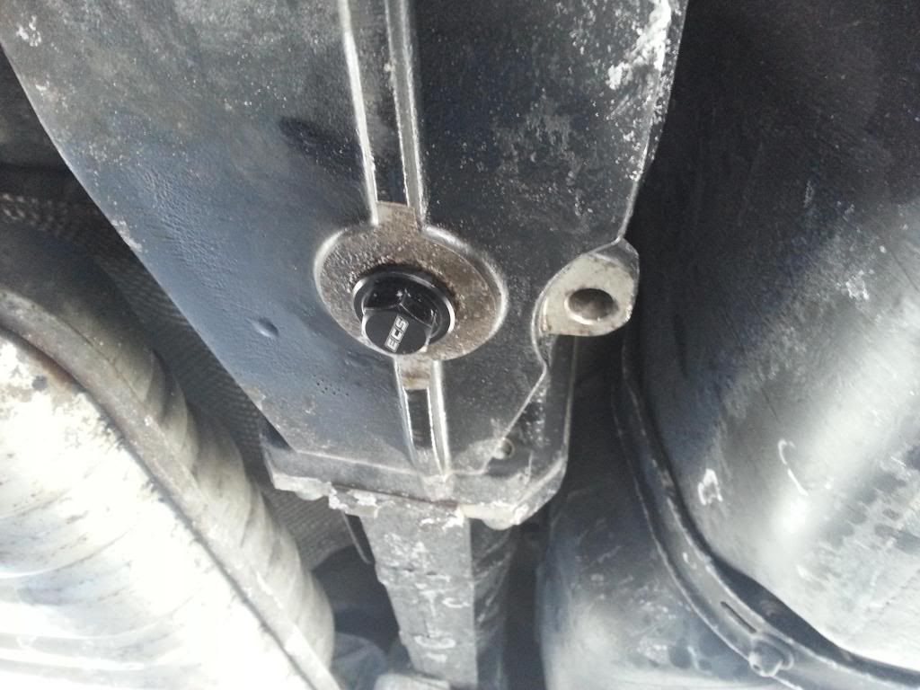

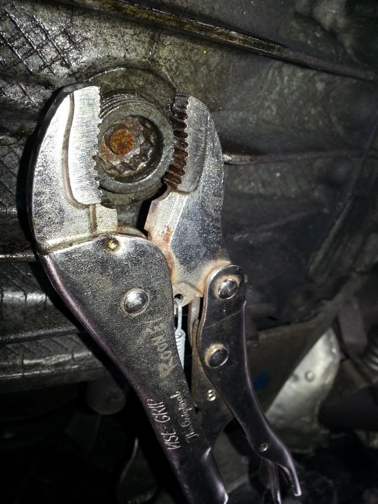

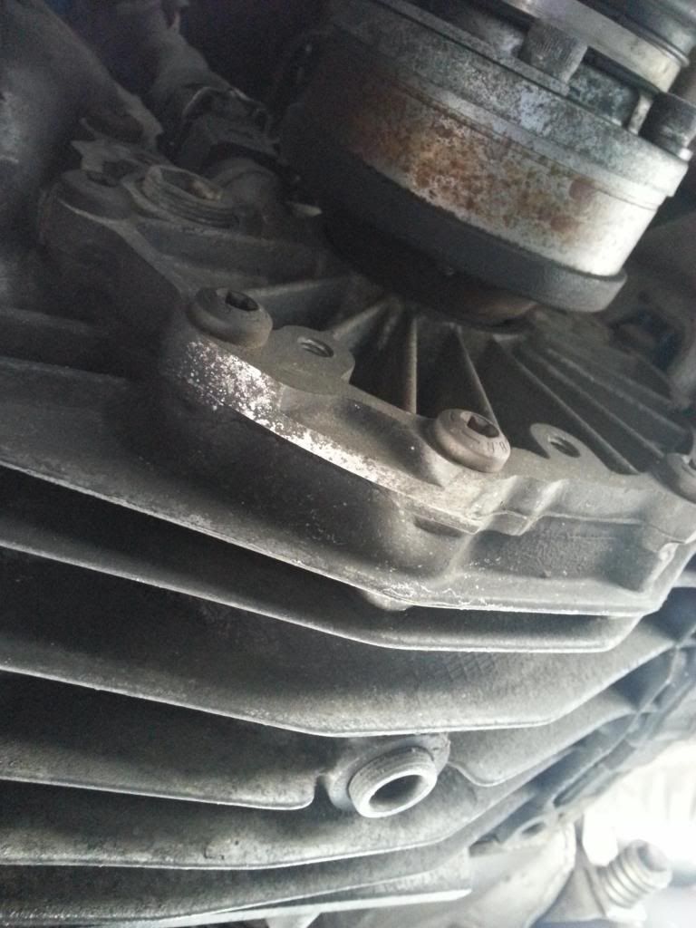

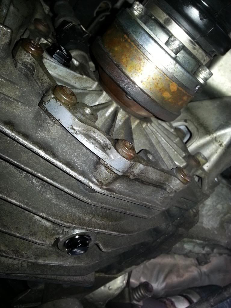

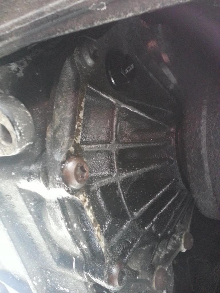

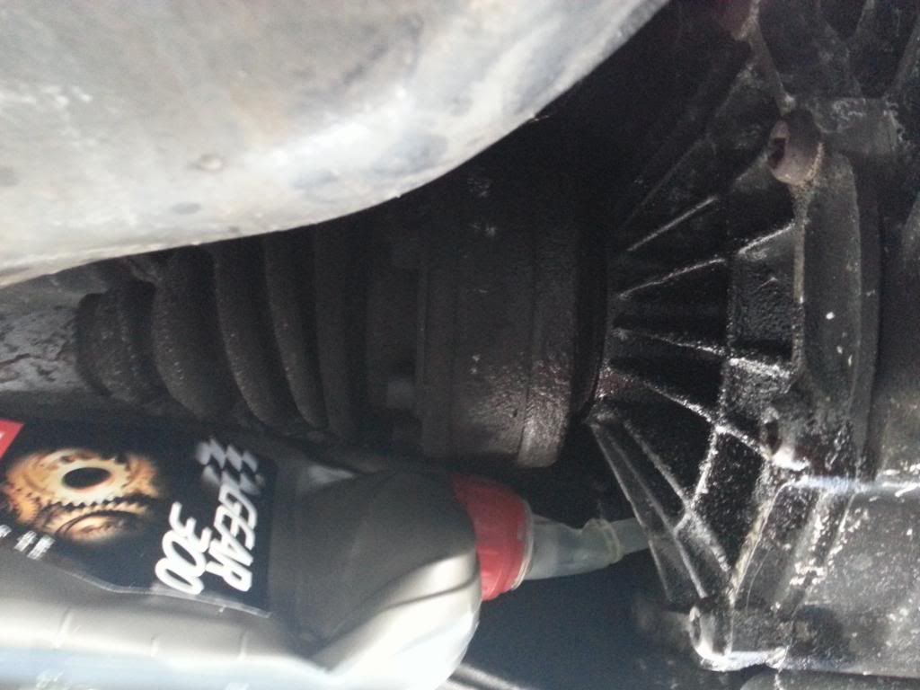

    Changed the transmission and differentials fluids today, the rear fill and drain plug were hard as hell to get out, but the front were a lot easier. I replaced the fill and drain plugs with ECS's magnetic fill/drain plugs.
    Rear Diff
    Real pain in the ass to fill. Rear took just under 2 liters of oil.

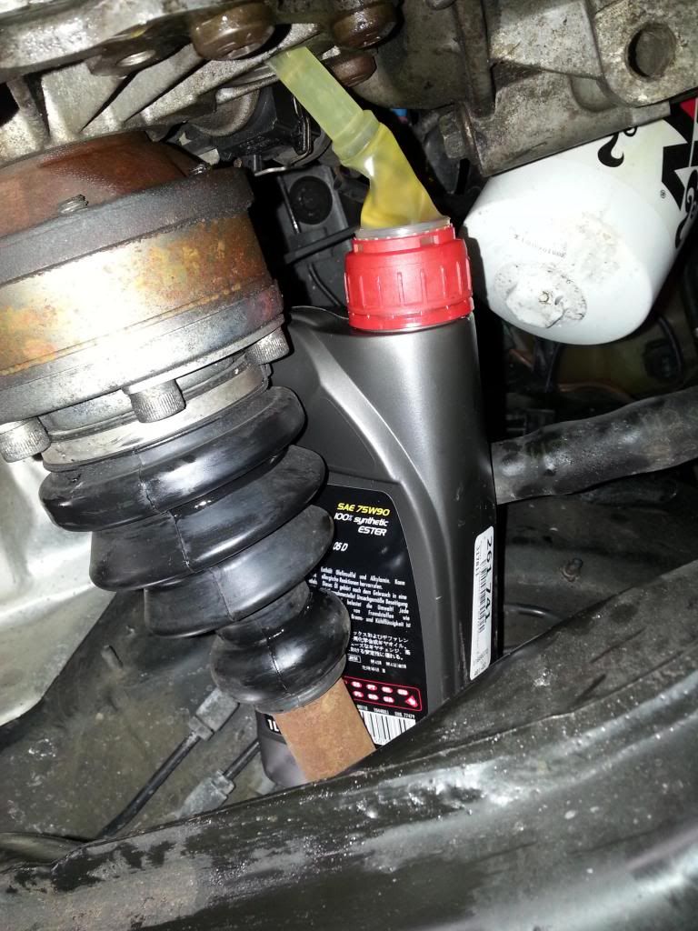

    On to the front. The "center" differential and manual transmission share oil and took 3 liters of oil.
    The drain plug was a 12 point anti-tamper plug, but my vise grips took care of it.
    The front was easier to fill, I just rolled the liter of oil on top of the axle and let it eat.
    End product.
    Veteran Member Four Rings BaseDrifter's Avatar
    May 18 2010
    59183
    Good job. A couple tips to make filling the fluids easier. For $3 you can buy a screw top pump that will allow you to pump fluid into the rear diff. For the tranny, I use a 4' piece of plastic tubing to fill it by gravity from the side of the car.
    Thanks bud, that's good intel.

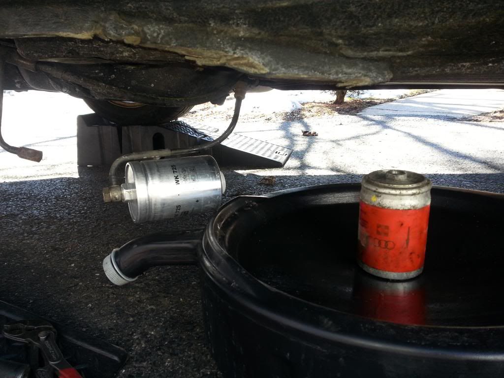

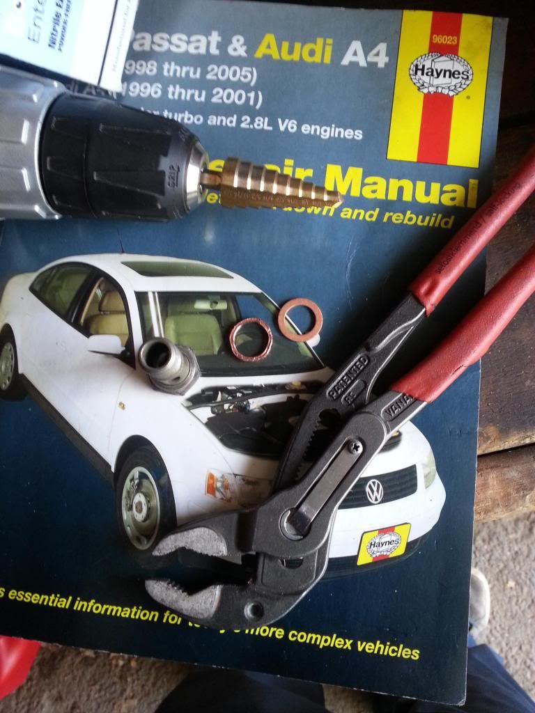

    I tried to tackle the fuel filter change, even after reading a bunch of horror stories from other threads. Well my story is the same as the others. It only took 20 minutes to get the old filter out, and slap a new one on, but there were only three crush washers on the original filter.
    I found a copper washer that didn't quite fit, so I tried to manufacturer my own.
    No dice though, I was able to blow through the filter still, so i just slapped it back in. I'll get some washers from a dealership and try it again later.

    Well I was full of pep after work, made it to the dealer and picked up a new set of washers; only a little over a dollar per washer, not bad. I get home and don't even unpack the car, up on jacks it goes. I pull the tank down and start to loosen the fuel supply line, my wrench slips and scrapes the rubber back on the line (insert profanities here).
    Luckily Advanced auto parts had a fuel line repair kit for 16 bucks. I just redid the last 16" of fuel line and slapped it up, no more leaks!
    Well Seafoam was on sale so I picked up a pint of that and ran it through my intake manifold, took her out for a spin and all is well, except for a CEL. It's was a misfire on the #1 cylinder. I choked it once while Seafoaming, so I got the Vagcom and cleared the code. Afterword I was playing around and checked my readiness status, this is what I found.

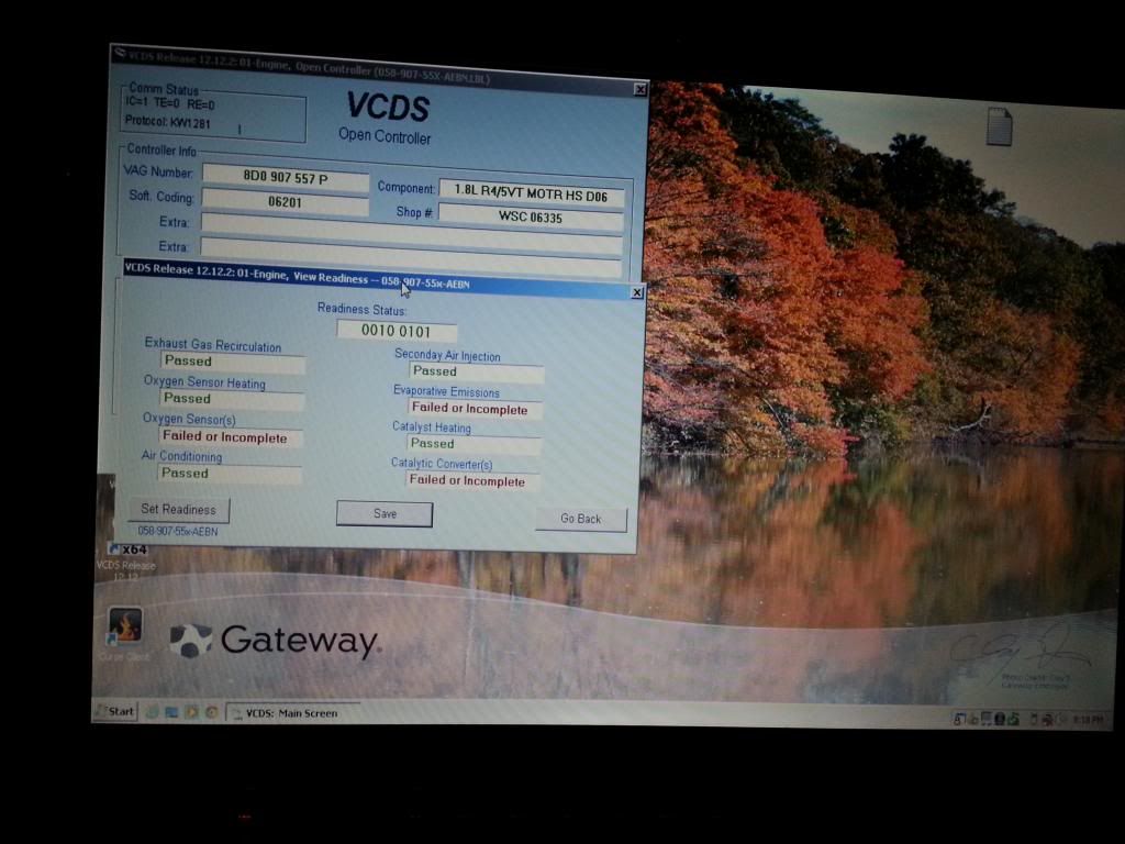

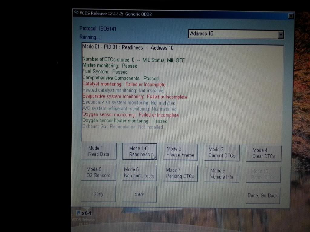

    Both O2 sensors show voltage but the B1S1 goes back and forth from Lean to Rich, it never steadies. Any ideas with what's going on? This is only the second time I've used the Vagcom, but it doesn't seem right to me.

    Quote Originally Posted by B5A4coastie View Post
    Totally normal to get misfires running Seafoam through, even if you don't choke out the engine. I'm surprised it only happened on one cylinder!
    Couple things here... Readiness can take a few running cycles or up to 50 miles to set for some of the parameters. I wouldn't worry about it until 3 cold start cycles and/or 50 miles have gone by.
    On an AEB there is a narrowband primary oxygen sensor. These are very sensitive to stoichiometric air/fuel ratio. NB sensors can only measure something iin the range of about 14.1-15.0 A/F ratios. Your ECU will purposely cause the A/F ratio to go up-and-down and switch between rich and lean. This switch should happen once every 2-4 seconds or so at idle. Basically the ECU does this so it can make sure it's running in the stoichiometric range.
    Actually... the United Motorsport Stage 3 630cc tune is even said to work with a K03. Jeff Atwood (guy who runs UM) runs the 630cc AEB tune on his stock-engine B5 from what I understand. Nothing wrong with having nearly twice the fuel-flow capacity as stock :) The tune runs very nicely and there's obviously upgrade potential (up to an Elim-ish).

    Well I finally got my test pipe and turbo inlet pipe from Evolution Racewerks, the parts look solid and the directions and installation kits are very detailed. Only one small problem, I asked for a 3"MAF TIP, but I received a 2.75 coupler. My guess is it's just a step down silicone coupler, hopefully they can sent it fast, I'd like to put this all together this weekend. ER is very hard to get a hold of though, I'm not sure if I'm the only one having that problem, but I can never get anyone to pick up the phone, I always have to leave a message.

    Gotta love getting parts! Hope you get that 3" maf tip fast too. What's next on the list after all this is put on?
