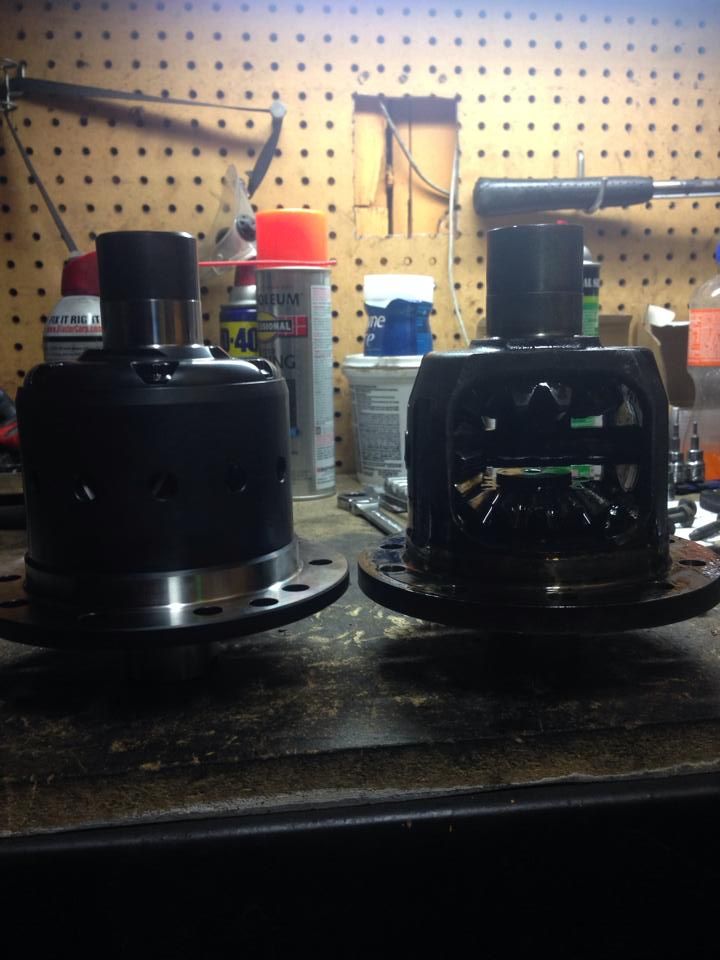

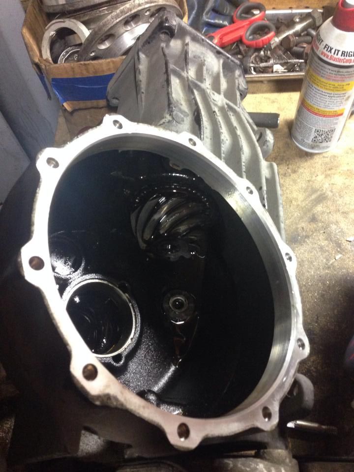

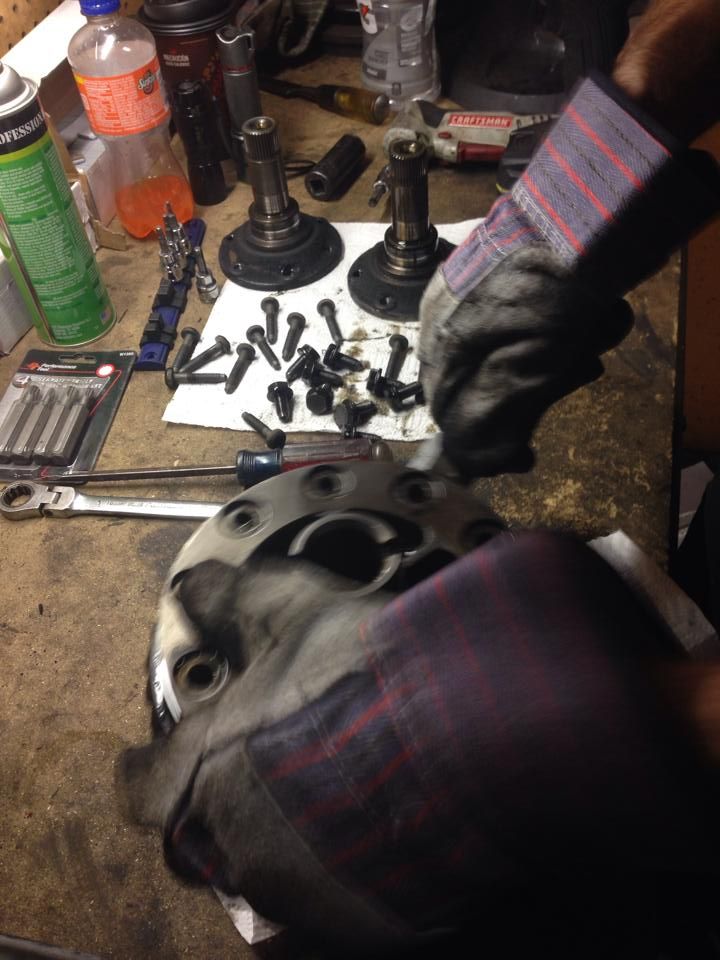

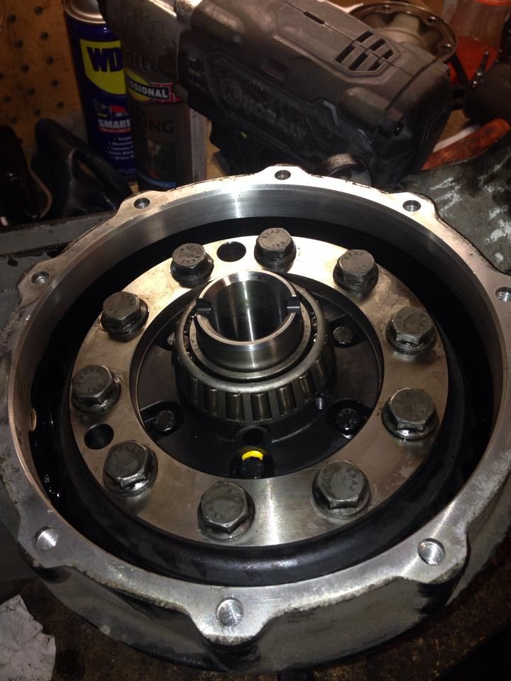

    Cool Wavetrac rear LSD installed. :)
    Sorry no videos yet.
    LSD Part # 40-309-170wk (no matter what the seller says it will fit rear diff 01R!)

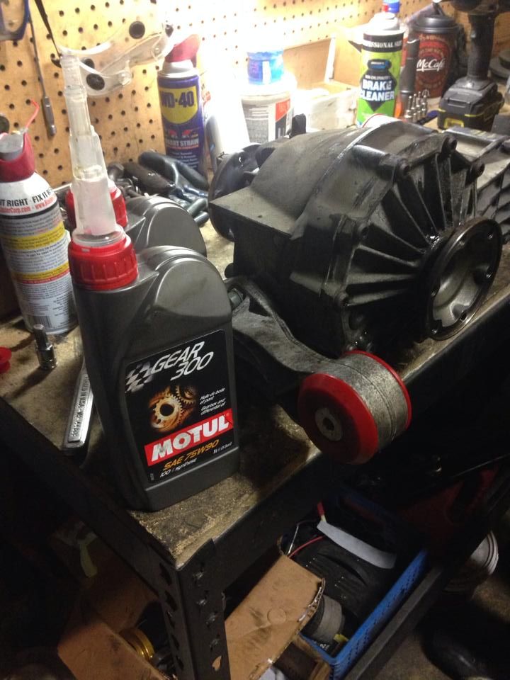

    Wavetrac warranty requires using Motul Gear 300 75w90 or Motul 75w140 competition.

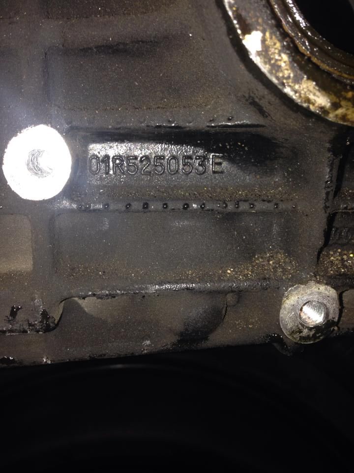

    My diff carrier #01R525053E (2000 A6 2.7T 6MT)

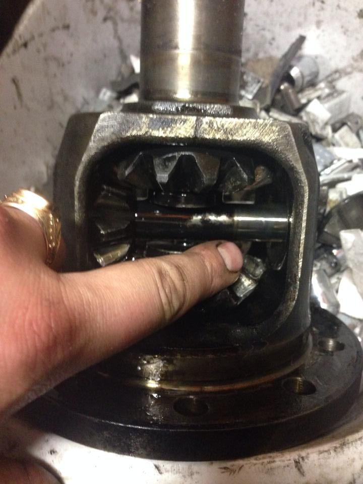

    Here are some pictures of broken stock diff and intalation of the lsd:) enjoy.
    Broken gear on the right of thestock diff:
    new diff in!
    stay tuned for some test runs and videos

    It's a great upgrade, I've put Wavetrac diffs in the front and rear of Allroads for a couple years now.

    i drove it today, and holly shit, my rwd 6 drifts and grips so nice i cant describe it haha, i will be doing lots of videos in near future after i get it out of my system and get used to it :)
    Wavetrac warranty requires using Motul Gear 300 75w90.
    My diff #01R525053E (2000 A6 2.7T 6MT)
    That must be a recent change because my paperwork said to use the factory fill for fluids.
    You will really enjoy the LSD, have fun.

    maybe, mine says motul 300 75w90 or competition 75w140, it says recomended, in big letters, so i went for it, lots of bmw guys using w/e oil they have. anyways the diff works very smooth, im enjoying it every corner))

    Hey Scotty:
    I've heard the D2 S8 LSD differentials (case and all) will bolt into the C5 chassis. Comments? I bought one a while back and while it looked similar I never compared them side by side.
    May 16 2008
    28845
    South Texas
    Quote Originally Posted by ddillenger View Post
    Hey Scotty:
    D2,C5,B6 diffs are the same 01R family.
    Yeah the BMW guys swear by 75w-140 for LSDs. I got a LSD for my BMW 850i with a better gear ratio and the place that I got it from required 75w-140.

    reporting back, first 100 miles mostly city and some highway driving with Motul Gear 300 75w90, no noises at all, very smooth, no grinding, will be changing gear oil at 500 mile mark to check on the condition. Will be def. staying with Motul.

    Also, which diff did you use? Wavetrac's site doesn't show A6 applications.. Is it the B6 A4 rear unit?
    yes the same diff carrier is used in the B5,C5,B6,D2 and early C6 and D3's.
