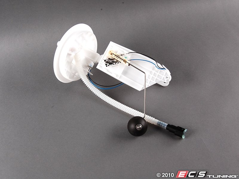

    I believe your problem is with the tank equalizer pump aka: suction jet pump (not to be confused with the SJP that is part of the braking system). The quattro fuel tank is shaped like an upside down "U". The fuel pump runs a line to the drivers side lower section of the "U" and the fuel flows through the venturi suction jet pump to equalize the two sections of the tank once the level drops below the upper section of the upside down "U". If the suction jet pump gets clogged up you will suck all of the gas out of the riders side where the fuel pump is located but the sender unit from the drivers side will indicate that you still have gas in the tank. The pump will start humming and you will run out of gas.

    The drivers side sending unit has the suction pump incorporated into the sending unit. There are two sending units for the fuel. One on each side. The ECM combines the signal from both units to determine the amount of fuel. I believe you are probable sucking the lower portion of the riders side dry and the drivers side is still registering fuel.
    The first thing I would recommend is to pull the drivers side unit and see if the pick up tube on the sjp is clogged with the gasket material you found floating around in the tank.

    I replaced that at the same time as the other sending unit so it's new. I'll pull that tomorrow and see if there is anything in that tube, clean it out. You're talking about that corrugated hose on the sending unit itself? Is there anything else I should check after that? I'll post more after tomorrow, thanks for all of your insight!

    Yes the corrugated hose. Make sure it isn't clogged anywhere between the sender and the pump on the other side of the tank.

    Old Guy, you were absolutely right, the drivers side tank is completely full, the passenger side with the fuel pump is empty. Now, how do you suggest clearing out the actual tube that goes between the two tanks? Where is it in the diagram you sent, which hose is it on the sending unit, and what method would you suggest cleaning it out? Any help is much appreciated!

    I know it will be a pain in the ass but you best bet would be to open both fuel tank covers. Undue the fuel pump locking ring and pull the assembly up so you can disconnect the SJP lines. Remove the drivers side assembly and disconnect the SJP lines from that end. Reach in the tank from the left side and pull the complete assembly out so you can examine it for clogs or splits in one of the hoses. Either one will prevent it from working properly.
