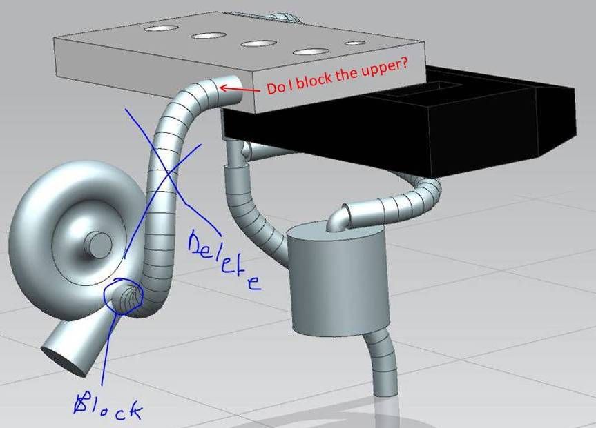

    1. I have post numerous times on what you need to run to atmosphere, I even made a 3D model on how to do it.
    2. Your BSH block off plate if routed correctly should not be doing any damge.
    3. In Corey's thread he clearly shows how to eliminate the oil problem using a BSH block off plate. It outlines that you need to block off the rear PCV where it connects to the turbo.

    Delete rear PCV
    New routing
    Side View

    Quote Originally Posted by FraggyA4 View Post
    Delete rear PCV
    New routing
    Side View
    Jeebus dude, that's AWESOME! I'm still reading that thread.....

    Does that top piece get blocked?

    So when deleting the rear pcv, does the hole on the VC get blocked off also, or should there be a filter there?

    Quote Originally Posted by Toasted Coastie View Post
    Ninja!

    In certain cases you have emission testing so some people will jut leave there pipe on and connected but will just block the port at the turbo. I think there is someone here that puts a small cone filter on that port though.

    It was JR that did it with the filter. But I think you can just block it.

    Yup, I JUST got to that page. Now that you have simplified it to me, I need to order some things and get to

    You did. I'm going to tackle the rear PCV first. After doing that, I will revisit for the "T". Am I going to need new hose for that?

    I'm not sure a think the easiest way to to it is to get some tin(pop can) and cut it to shape. Then use the piece that initially is bolted there but just remove the flex pipe from it.
