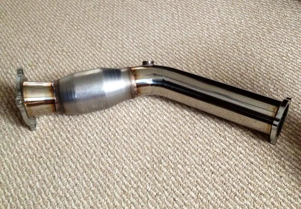

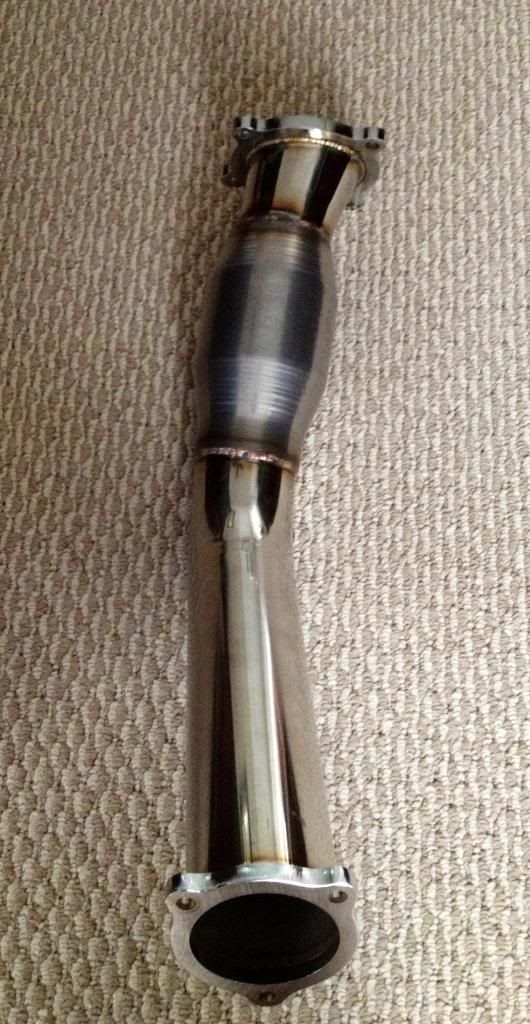

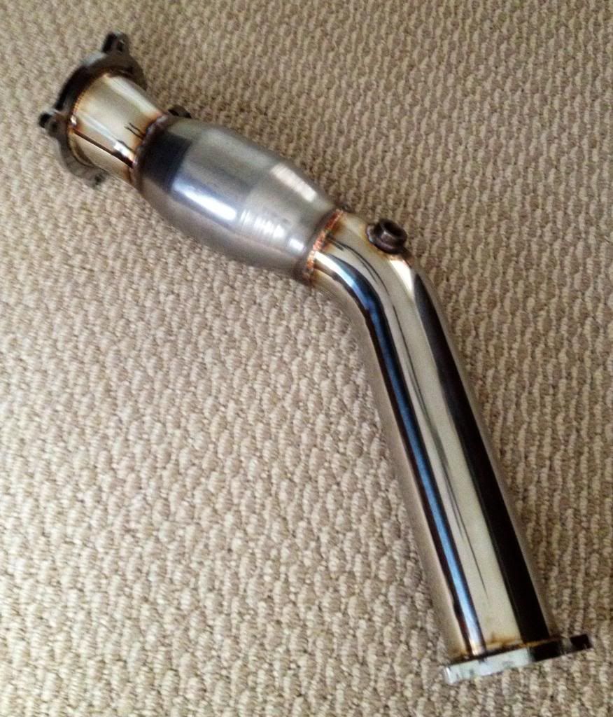

    My wife just bought me a CTS Turbo HFC for Christmas. Originally, I had my heart set on an 034 Motorsports HFC, but my buddy convinced my wife that the CTS Turbo HFC was a better deal. I've been comparing the CTS Turbo HFC to pictures of the 034 Motorsports HFC since Christmas day, and this is what I've found:

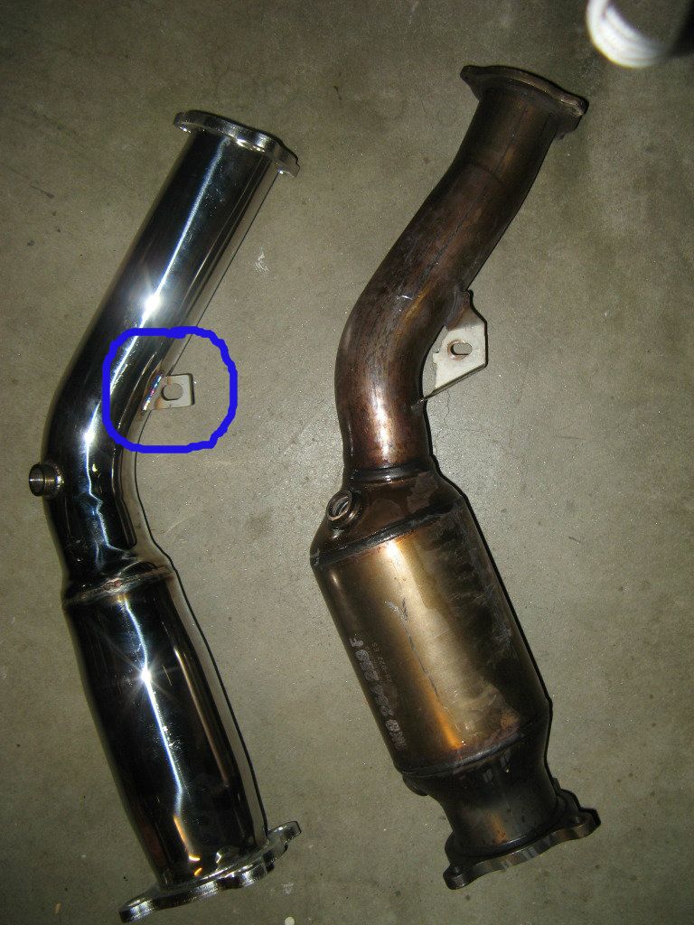

    I've noticed that it is missing the 'tab' that is normally welded on to the bottom side of the pipe (circled in blue in the picture below). Is this 'tab' necessary? Seems like it should be there if 034 Motorsports and Eurocode both have them on their HFC's.
    I've also noticed that the installation kit comes with 4 nuts (to mount the HFC to the turbo), 2 exhaust gaskets (OEM ), and 3 nuts (to mount the HFC to the down pipe). There aren't any bolts included in this kit. I was under the impression that you needed to replace the bolts where the HFC is attached to the down pipe as well. Am I wrong?
    CTS Turbo included an O2 spacer, as I don't wish to go stage 2 yet. It's a 'J-style' spacer, but I can't seem to find a review from anyone with a B8 A4. I'm going to assume that if I stick with this, I will be the first to test if this will work. It has a 'jam nut'; which allows 360 degree indexing (good idea in my opinion, as this will allow me to position the spacer in whichever position I like to make sure it clears the firewall properly). Here's a link to some information I found online:
    http://www.vrspeedfactory.com/vibran...162011620.html
    Here are some pictures of the CTS Turbo HFC if anyone is interested:
    My wife was able to get a good deal on this, however, being a Canadian customer, purchasing from a (proudly?) Canadian company, you would expect to be charged in Canadian currency. She was charged in US currency instead (which, if she had paid through PayPal, would've been a better deal), but of course the credit card company tagged on their 'currency exchange fees', which didn't end up making this much of a better deal after all (only a difference of ~$15 from what I could've had the 034 Motorsports HFC, installation kit, and O2 spacer for). I searched high and low on their website, and can't seem to find any information on which currency they typically charge for their products. Maybe it's wrong of me to assume that a Canadian company would charge a Canadian customer in Canadian currency.
    So, considering that it is missing the 'tab' (as outlined above), that the installation kit seems (possibly?) incomplete, and the fact that I ended up paying more than was originally agreed upon (because of being charged in USD), should I return this, spend the extra ~$15 and get the 034 Motorsports HFC, installation kit and O2 spacer instead?

    I would want that tab because it keeps the HFC from having too much play, but honestly, it probably won't make too much of a difference. I wish there was a way for me to turn my OEM CAT into a HFC :(. I love having my testpipe, but it lets out way too many fumes.
    Oh and I hear those spacers with a mini CAT work well. I personally don't have experience with them, but it seems like a neat product if you don't want to get stage 2 software.

    You don't need bolts for the connection to the downpipe. There are already three bolts spot welded onto the downpipe flange that you will connect to.
    I'd think you'd want the tab for the connection to the transmission but who knows? Call CTS and ask them why they didn't put it on there. Maybe they have a good reason.
    Yeah, it definitely seems like the tab should be there in order to keep the HFC from moving around too much. It is a surprisingly light piece though, so maybe it's not required because of its light weight? Who knows. I'll call them tomorrow though for some clarification.
    I've heard the same about the spacers with a mini CAT. If I keep this, I'll try out the spacer they provided. If it doesn't work, I'll definitely try out a spacer with mini CAT.

    I was told (when i was mounting my 034 HFC) that the 'tab' is also use to hold the weight of the cat and exhaust system. If you don't have it the turbo will hold all the weight and this is not to good for the turbo.
    I was also told to get the original gaskets and nuts from audi for the installation to prevent any leaks etc.

    Well, I ended up emailing CTS Turbo (difficult for me to make phone calls throughout the day because I'm always on-road for my job).
    I got a response from Clay. He claims that all HFC's and test pipe's are designed this way, and that he has yet to see one with the mounting bracket I'm talking about. Clearly, he has not seen any other HFC or test pipe other than the one made by CTS Turbo (including the factory cat that includes this bracket). He also said that he has no plans of revising his product because they feel that it works (we'll see how they hold up over time). I responded to his email with the first picture I posted above, showing the Eurocode HFC with this bracket, and the factory cat with this bracket. I did not receive a response from Clay in regards to this (guess I had a valid point).

    anybody have any input on that tab? i wanna get the SPM street edition but it is also missing that tab and i do not want to harm my turbo

    Reviving an old thread, for input on that mounting tab. Is it not necessary because of the reduced weight?

    I ran a CTS HFC for a while while on the stock tune. Def fealt a bit more vibration not having the mounting tab. Wasn't terrible but after dealing with a CEL now and again without being tuned I went back to stock before going with a 034 HFC and the APR K04.

    Quote Originally Posted by Rollin Thunder View Post
    Def fealt a bit more vibration not having the mounting tab. [/URL]
    More info on this vibration please, throughout all RPMS extremely noticeable? I dont mind having a shop weld on a tab but for the price they'll charge im afraid itll put me right with the price for the 034 one. $330, the CTS is currently on sale for $251

    Quote Originally Posted by Srramirez View Post
    I fealt the vibration at stops and while idling in gear. Once moving the vibration wasn't fealt. It was very noticeable with the a/c running at idle as well.
