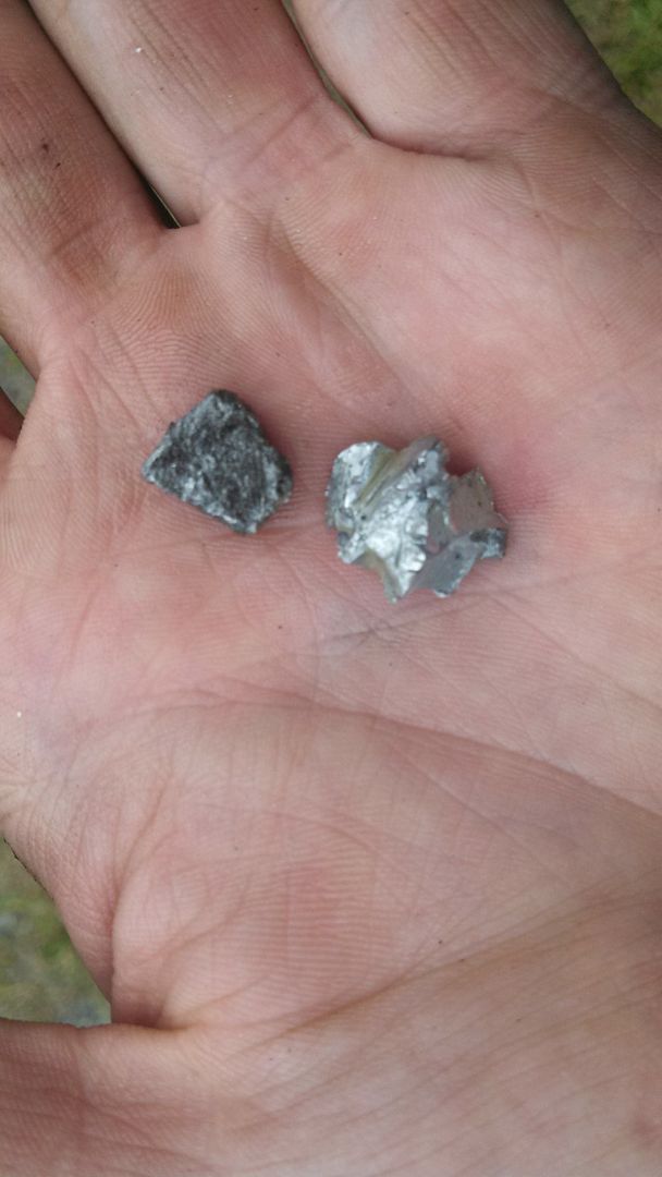

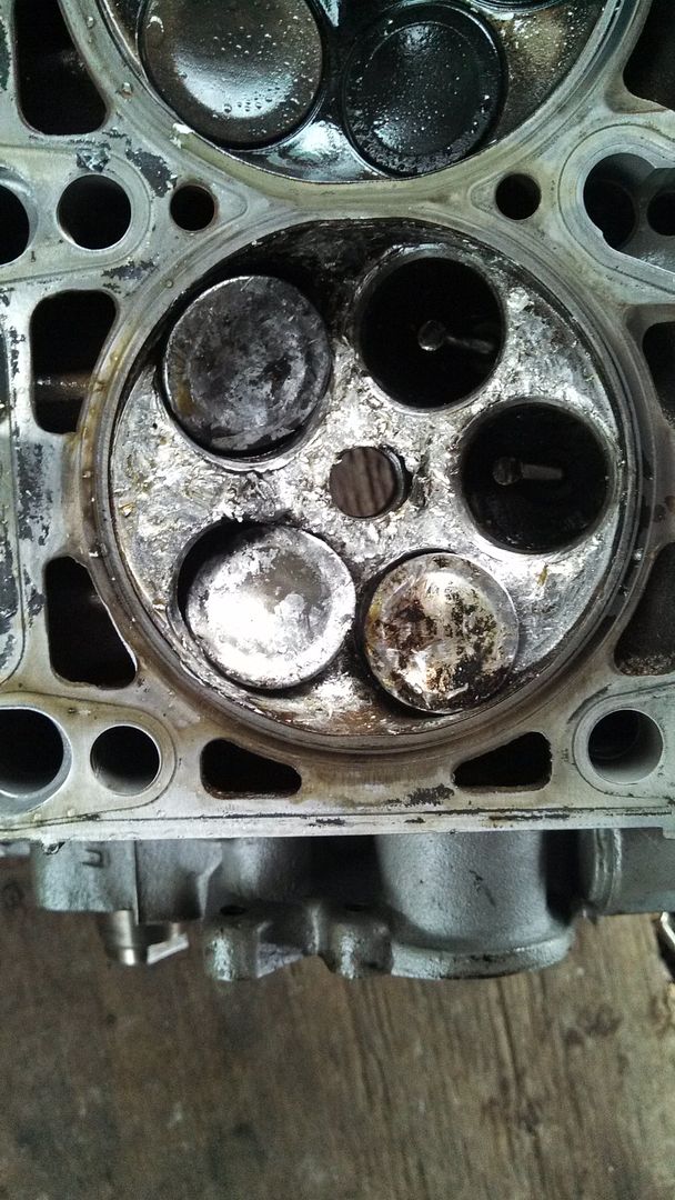

    Let's play guess the parts...
    I think the part on the left is a piece of Rod... part on the right a piece of piston maybe? lol

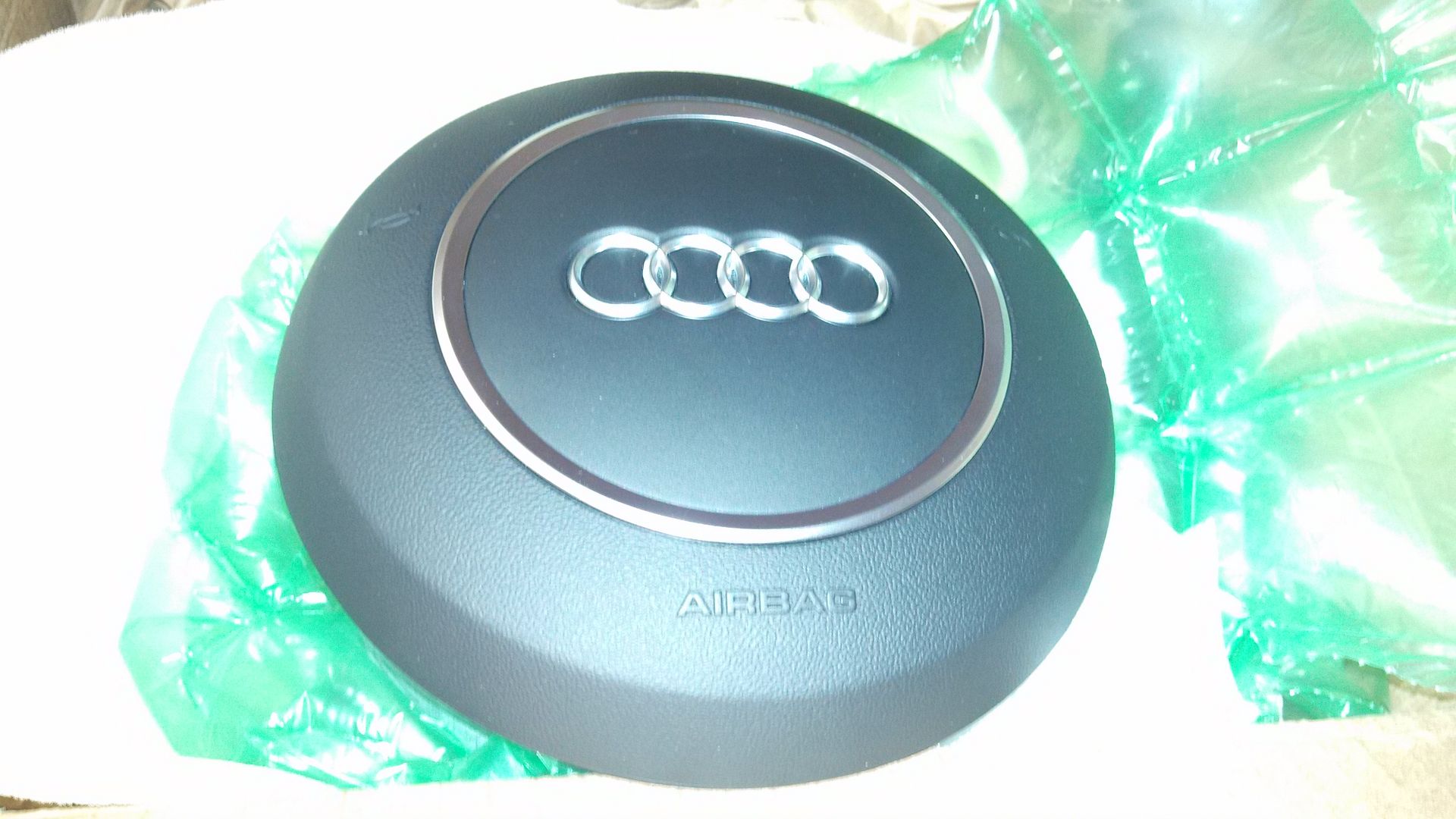

    TT Airbag showed up.
    Important to have one of these with a broken motor :-)
    Where'd you get yours? how much?

    Quote Originally Posted by spd579 View Post
    I got it for a steal... super cheap from someone on the forum :-)
    piece on the right definitely looks like a piece of the piston but the one on the left looks like maybe a piece of the block but time will tell

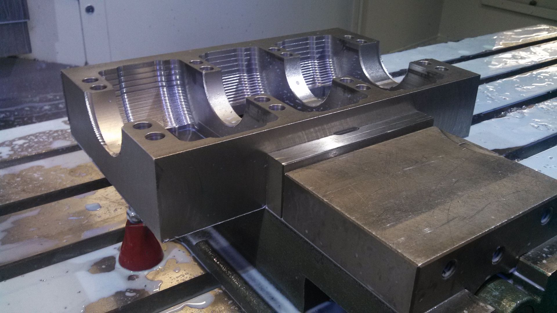

    tosh2_7 on instagram: Get at me
    -RAY-
  5. #3325

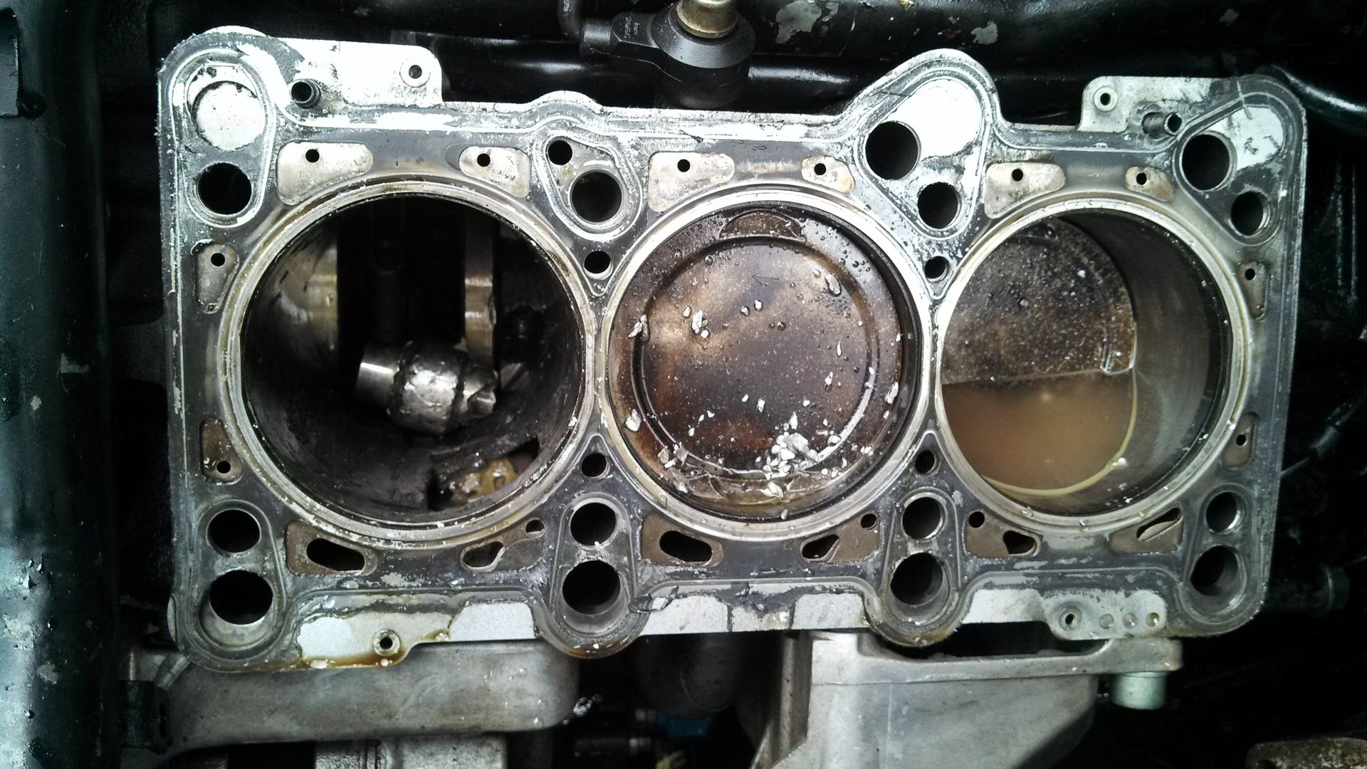

    Quote Originally Posted by tosh2.7 View Post
    It has what seems to be flat sides though... doesn't seem like any part of the block also doesn't seem to be the same material as the block.

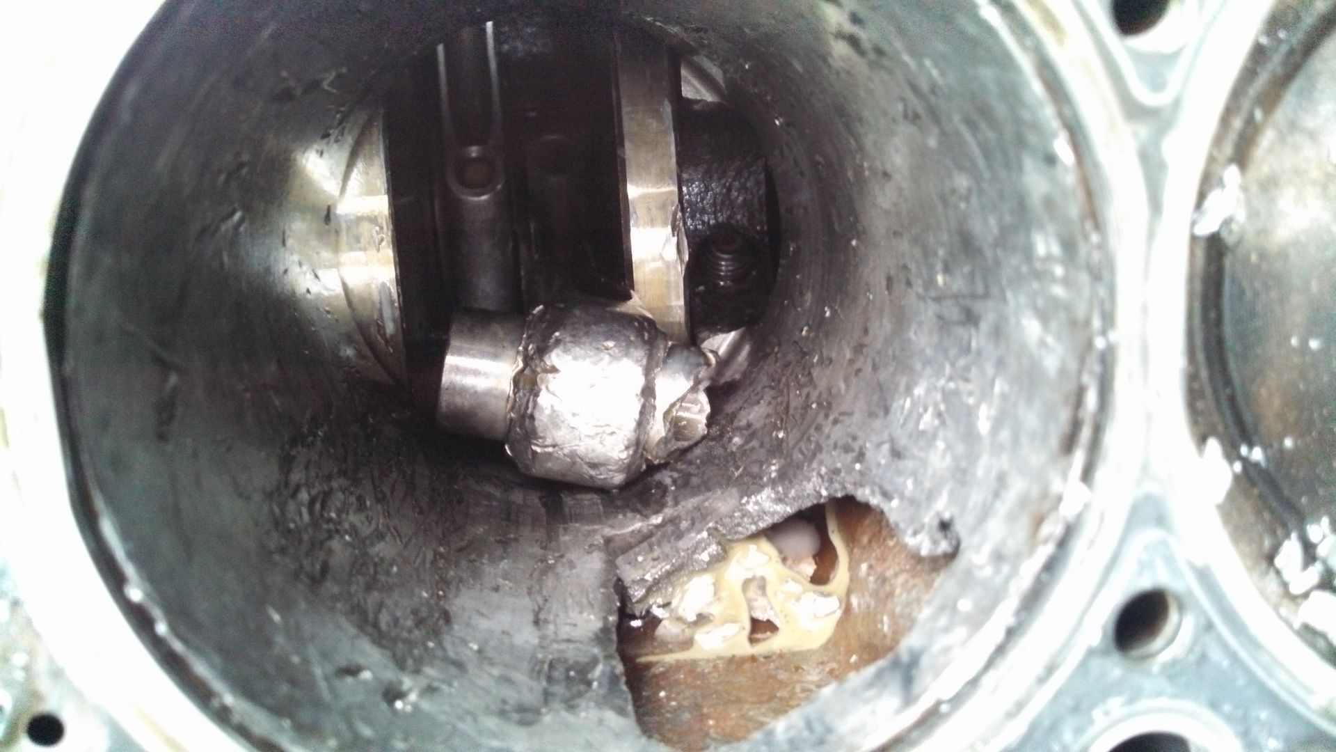

    Meet piston #4

    Sep 18 2012
    100686
    State College PA
    Crazy how there is nothing left of the piston. it got launched into the head and exploded...
    Probably going about 20m/s lol

    Quote Originally Posted by AudiSportB5S4 View Post
    Haha holy crap.. That's some serious destruction! That must have sounded nice when it happened..
    Everyone asks what it sounded like but it happened so quick lol.
    Bear in mind this happened at about 6000rpm in a 3rd gear pull... so by the time I shut it down it was at around 7200 and was less than a second later lol.
    All I remember was it went from a very bad "miss" right at 6000 to instant smoke and noise lol.
    If the piston was going 20m/s... then it would have traveled the length of the bore in about 4 ms lol.
    It was over before I knew it happened.

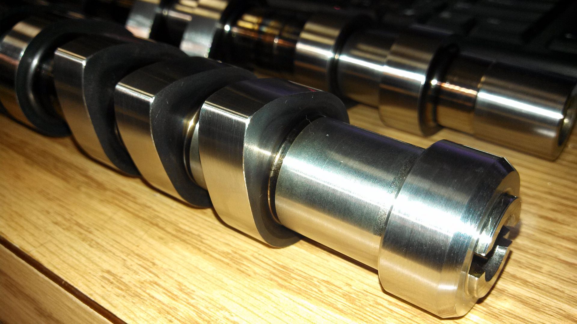

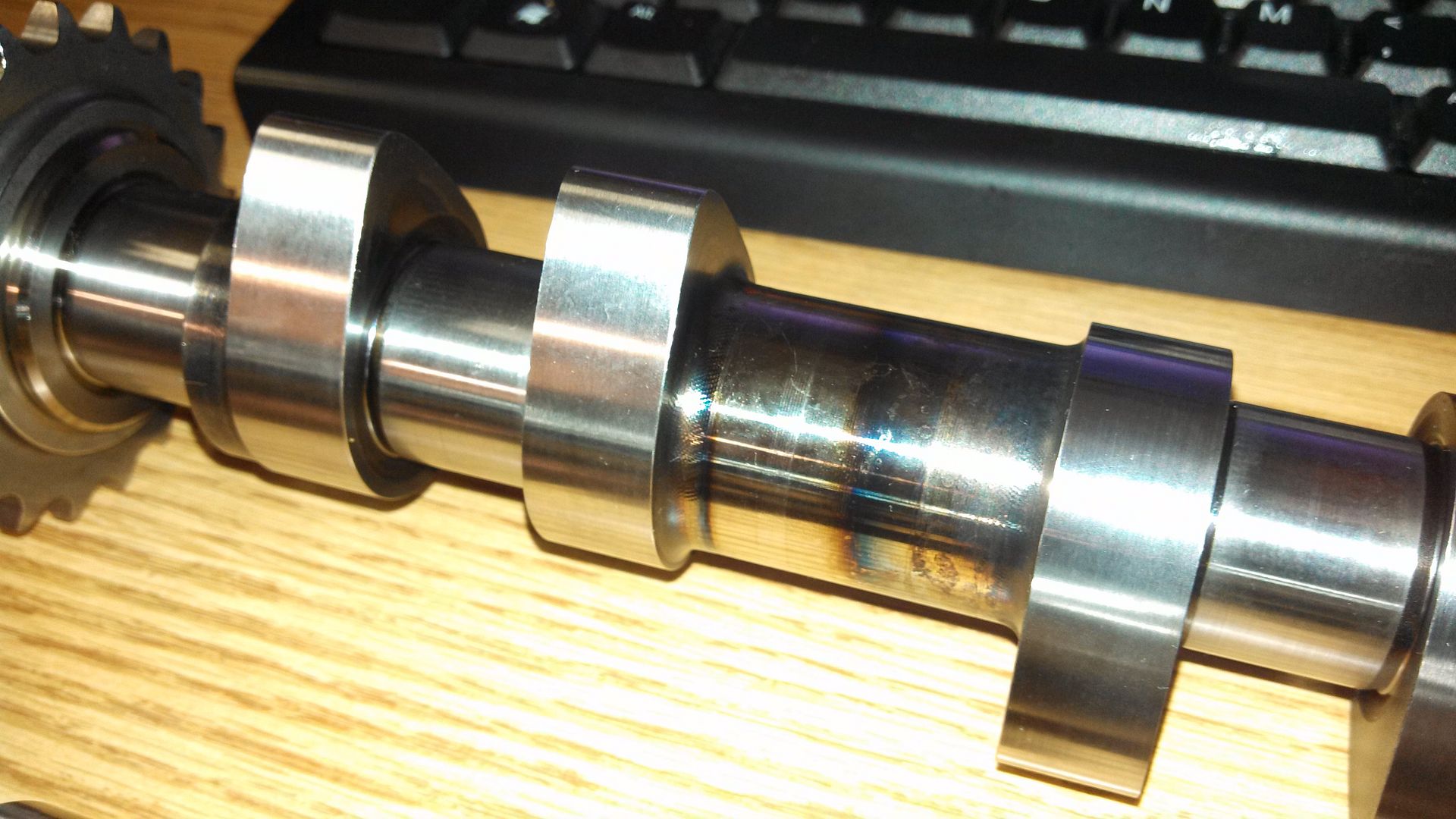

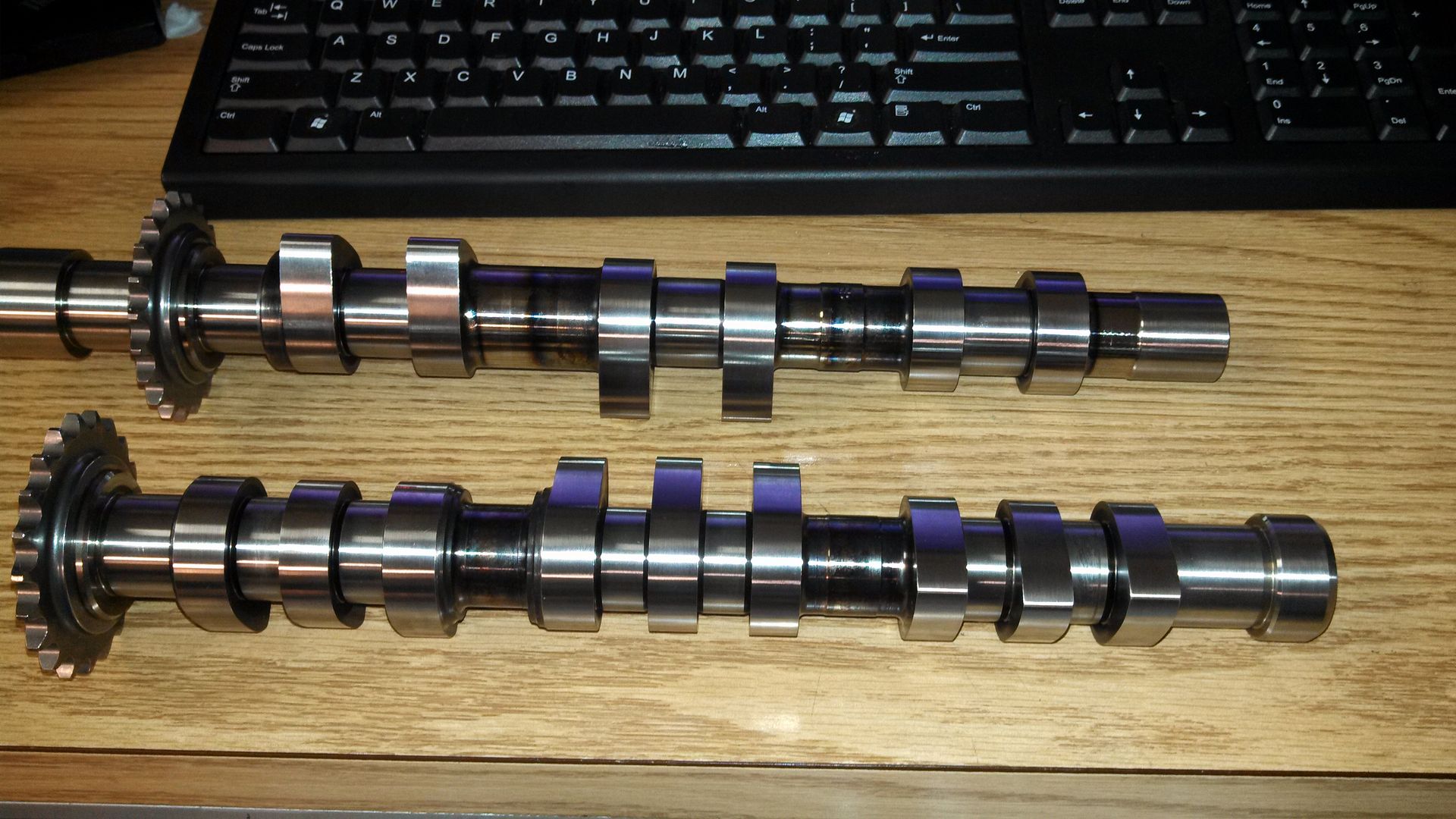

    When's specs going to be released? ...pricing? Always thought there was power left on the table w/ not many really testing a full intake/exhaust cam setup.
    In good news my LOBA cams showed up :-)
    My oh my how nice they look!

    Quote Originally Posted by cjk View Post
    They are just off the shelf LOBA Mechanical Cams:
    http://www.loba-motorsport.com/shop/...echanical?c=30

    nice hole in the block

    Quote Originally Posted by UkuRiSh View Post
    I hope the turbo is ok .
    From the looks of it the exhaust valves got jammed into the head when this happened, lets hope that was enough to keep the FOD out of it.
    Have you looked at the turbo to see if it had any damage? I saw someone mention it a few posts up but I didn't see a scientific reply yet.
    No damage from what I can tell.
    Got lucky there...

    Quote Originally Posted by NOTORIOUS VR View Post
    no doubt, but this time it cost you an RS4 block no? Or did you end up using another S4 block (I hope) :)
    It was the RS4 block...
    Eh - shit happens lol.
    I'll just repair the block

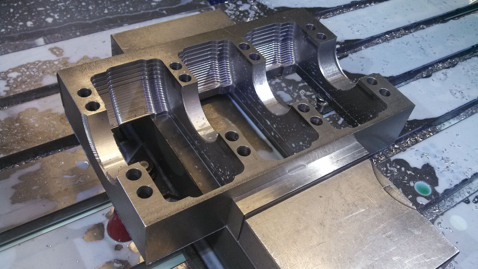

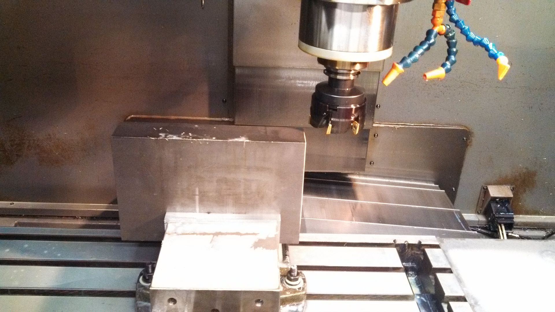

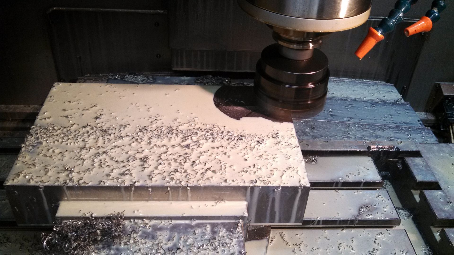

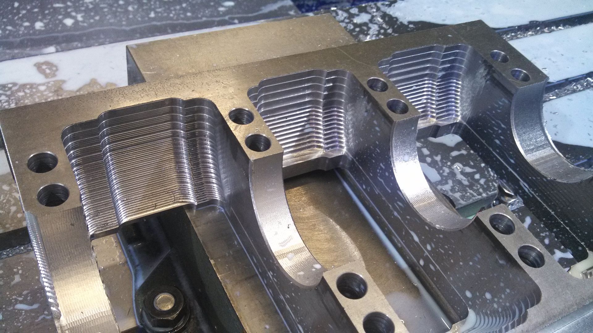

    Making something spectacular at work this week...
    I'll show you when it's done...

    Well it's not done yet but here's the first pics of my solution to the block strength
    I should have it finished tomorrow!
  39. #3359
  40. #3360

    Golden!
