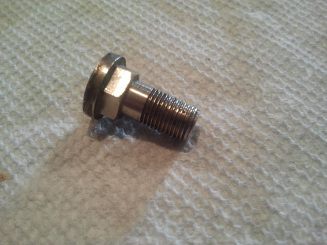

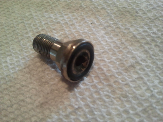

    I have an old set of OZ Racing wheels that finally need new valve due to small leak.
    The 'experts' at the local tire shop claim they have never seen such a valve in their 20+ years in the biz.
    They called around to all the parts suppliers in the area, but the parts suppliers just show up w/ off-the-shelf bolt-on style valves.
    These wheels have threaded valve opening so require a valve that directly screws into the wheel.
    Any help here is much appreciated.
    OZ says, 'sorry, wheel is discontinued'.
    will add pix when i can.
    thanks
    a few more pix in 'My Photo Gallery'...
    Broken valve - photo1
    Broken valve - photo2

    Photos added...
    comments, suggestions, advice ???

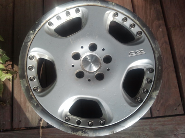

    We don't have a direct replacement for that. If you can post pictures of the wheel and any part numbers off the back we can take an educated guess...

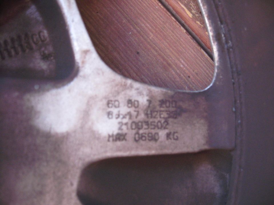

    more photos and info....
    [IMG][/IMG]
    other stamped alphanumeric's on back-side of wheels:
    'Made in Italy - AS-7'
    'TYP 001-60'
    '70600001'

    Since i did not receive any suggestions, I went ahead and used a standard off-the-shelf 1/8 NPT tank valve.
    Works fine, no leaks.
