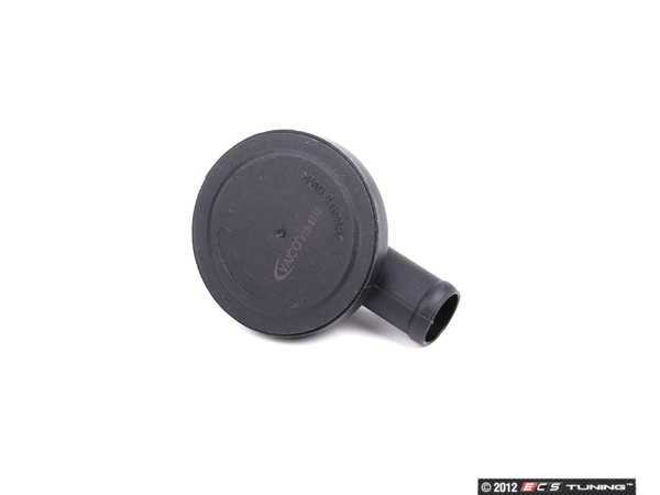

    PRV Pressure Relief Valve (hockey puck): 06A129101D

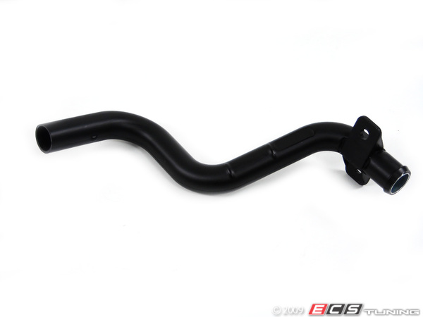

    Breather Hose (plastic piece of crap): 06B103213AK

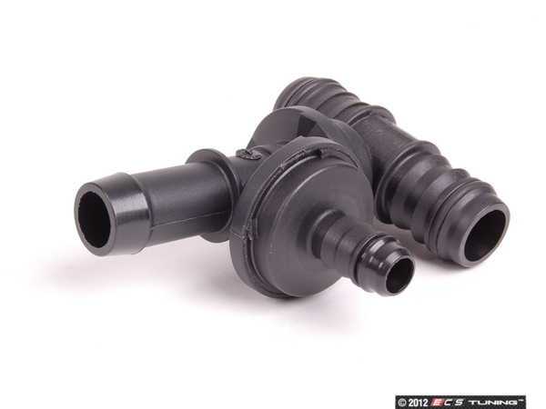

    PCV Pressure control Valve (Tee fittings): 06A103245F

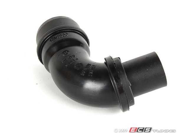

    Breather Hose Elbow (another plastic piece of crap): 06A103213AM (don't forget the o-ring)
