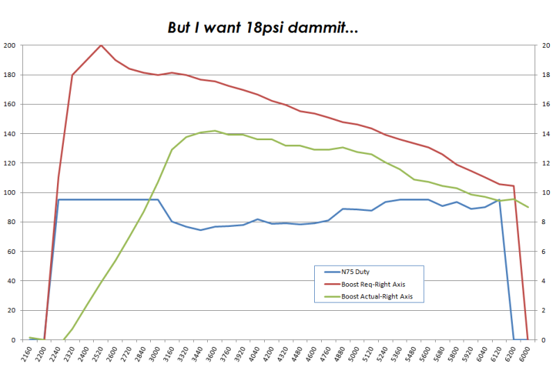

    Nice improvement here. N75 duty is much more normal here at ~70%. Looks like you must have got out of the throttle after 4500. Would have been nice to see the run to 6k like before. But it seems you're having a misfire issue with this new found boost, yeah?
    Looking at your AFR logs (eyes are nearly bleeding now, lol) 3rd gear pull looks ok. 5th gear pull looks like it goes lean at the end. I'm guessing you captured a bit of the miss, then backed out. The target AFR goes from ~13.4 to ~11.5 all at once and it doesn't make it. From your log I can't tell what RPM this is at, or what your foot was doing, so it's hard to say.
