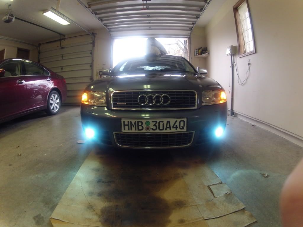

    Alright so i pulled the trigger on some ijdmtoy.com led error free turn signals for the rear and switchback led's for the front.
    Before
    After
    here is the install of the tails. and pics
    here is the install video for the headlights. and pics
    Now for my review, the installation went smoothly for both front and rear.
    1. There are no errors on dash or hyper-flash issues using all the 6ohm 50w resistors.
    2. The rear turn signal leds have no issues beside getting the bulb to fit into the socket, just push a bit and they fit perfectly.
    3. The front turn signals with the switchback bulbs gave me some issues, the connector needed to be shaved down a tad to get the actual bulb to seat properly in the socket. so just dremel that down and its good
    4. When keeping my blinker on for over 10 seconds the bulbs would not switch back to the white parking lamp. This is because our cars come with a 2 wire system and not a 3 wire system that is actually what these bulbs are made for. the 3 wire system has a ground a parking and a blink wire. the 2 wire system What Our Cars Have is set up like this : one wire for ground and one wire for parking and blink.
    5. When using the lane change feature (3 blinks and off ) they worked like they were suppose to.
    6. Flashers work perfectly.
    7. Using this chart from this thread helped me find the tap points for the resistors http://www.audizine.com/forum/showth...Wiring-Diagram
    if you have any more questions pm me
    hope this was clear enough to understand

    I think I may have the solution to your bugs.. I just installed a set of these and found that I had to use 2 resistors on each side - one from pins 7 to 8 (see diagram below) and one from pins 9 to 8 (covers the steady "on" and the signal "blink" modes of the LED switchback bulb). After installing the 2 resistors on each side, I don't have rapid blinking signals, errors, or the 10-second issue you mentioned. Everything is working great.
    Hope this helps someone...

    Quote Originally Posted by hbodo08 View Post
    I'm pretty sure the stock bulb is 3 wire as well...about 75% sure. Blinkers are usually dual element so that would require two power wires and one common ground.

    I bought some as well few months ago but mine are different. My while light stays on when amber is blinking. Is there something I can do to make white turn off while amber is on?
    Senior Member Three Rings mjt20mik's Avatar
    Jun 18 2012
    95412
    2013 Audi A4 Quattro
    @emil: I was told from the person from the site I got the bulbs from, that it stays white even when flashing. So it may just be the bulb you have.
    With regards to my issue, I even tried just putting in the bulb (without the resistor) to see if it would work even with hyperflash and whatnot. The bulb still remains white if I leave it in one way. If i rotate the bulb 180 degrees, it just stays off until i put the indicator on (in which case it stays orange).
    Account Terminated Four Rings
    Feb 16 2009
    38764
    Ithaca New York
    Your dont stay white when flashing tho.
    Can you put picture up of the connections on the bulb? Maybe i need to bend them some way
    Veteran Member Four Rings Pr0n's Avatar
    Jul 10 2007
    19450
    Bus pass + 2004.5 A4 1.8TQM6
    trunk
    Quote Originally Posted by Emilgevor View Post
    You have the older "Type 1" switchbacks, the "Type 2" is the one the OP has.
    Quote Originally Posted by V-LEDs
    Type 1 alternates white and amber when the turn signal is applied
    Type 2 only the amber flashes when the turn signal is applied.
    edit: instead of "older" I should use the term "original".
