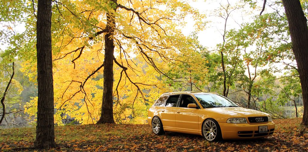

    Quote Originally Posted by maciej-xx View Post

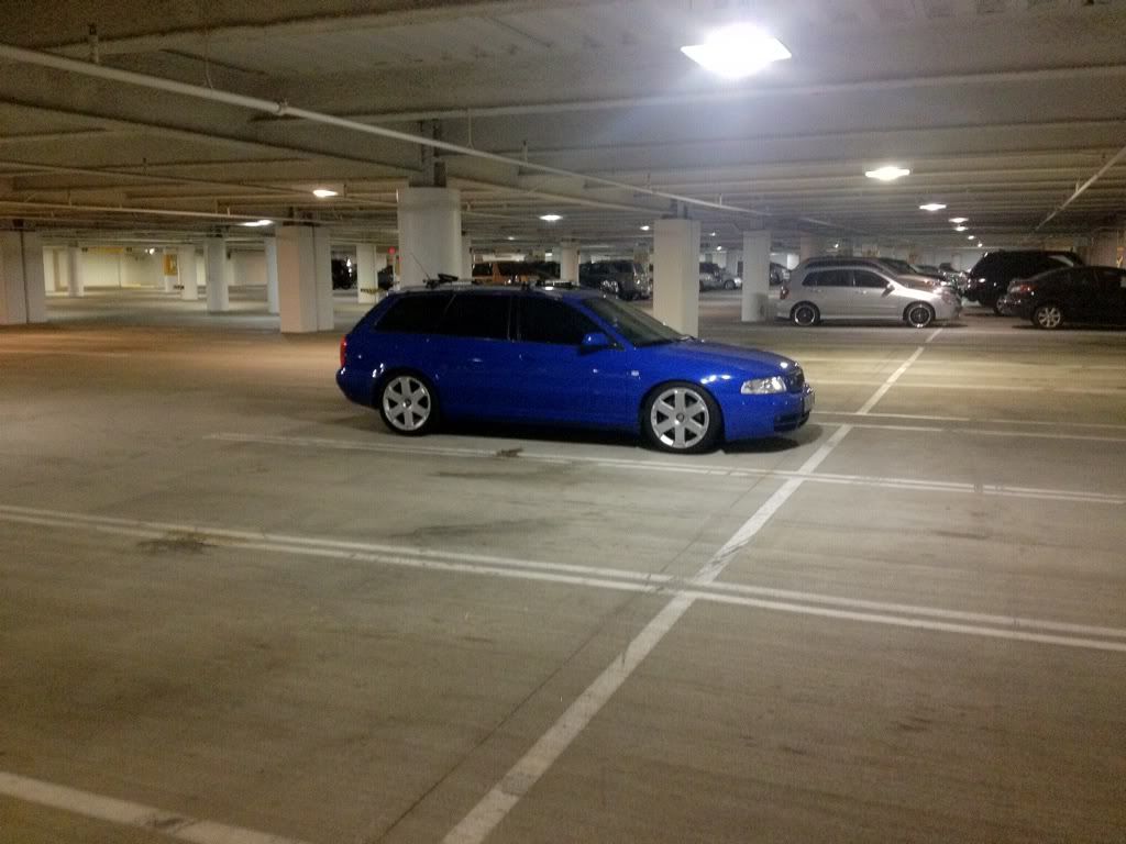

    i think ive seen you around before
    also, im pretty sure i know where this last pic was taken... off of milwaukee between armitage and north right? i used to live in logan square and still work from there. i wanna light up that wall with my paintball gun every time i drive past it
    beautiful car though
    -Mike

    Quote Originally Posted by $lick View Post
    Yes, that's the spot. and thanks!
    how did those fit the B5S4? I need to know offsets?
    These are 18x8.5 ET35 10mm spacer and some minor caliper grinding was required to clear front brakes. I have rolled fenders in the front, and still have rubbing issues.

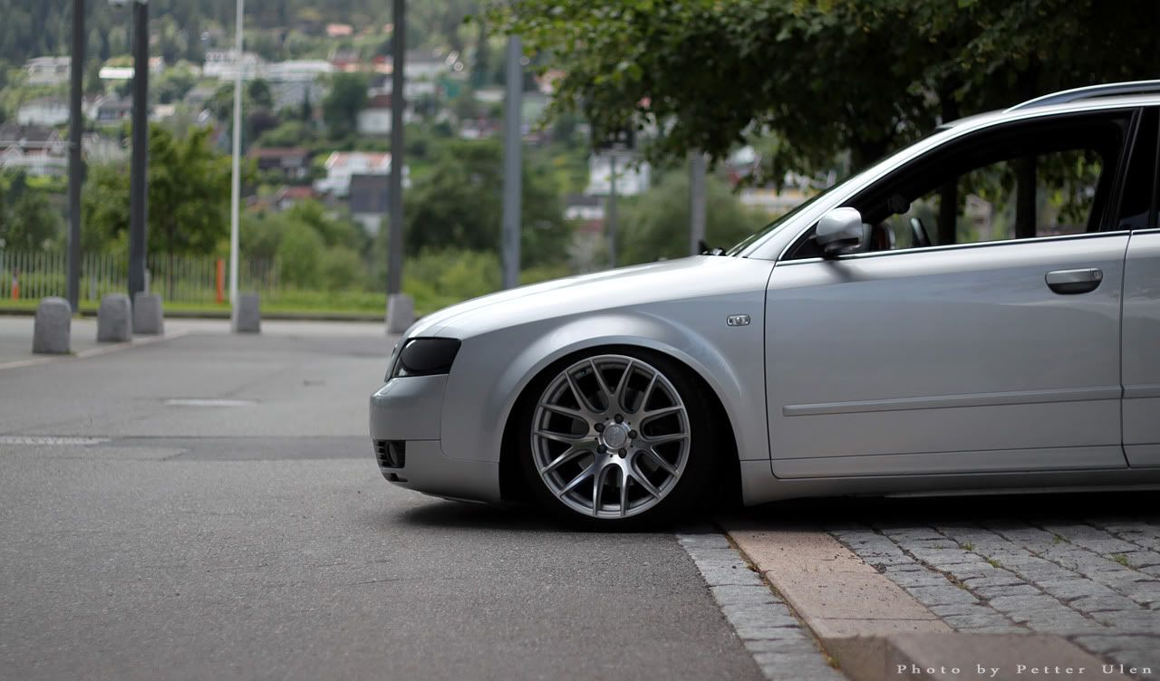

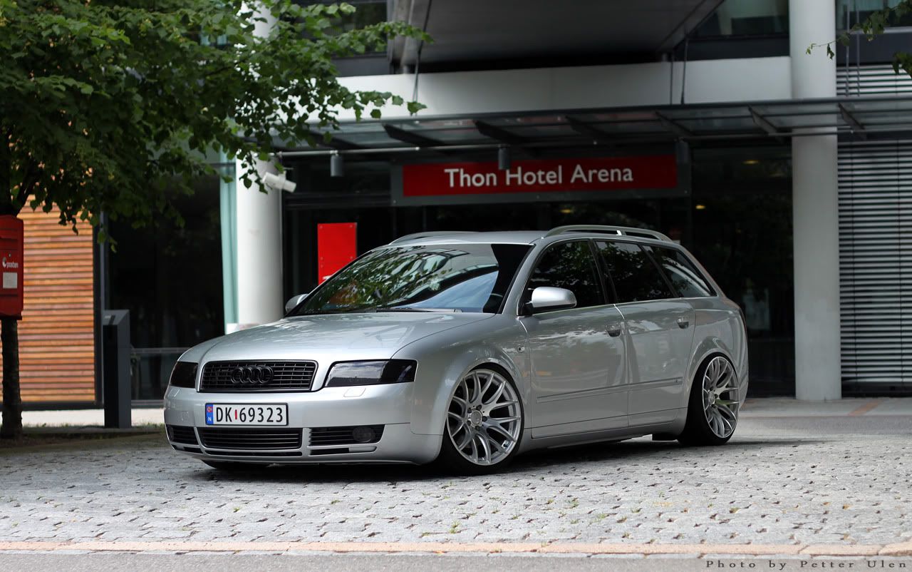

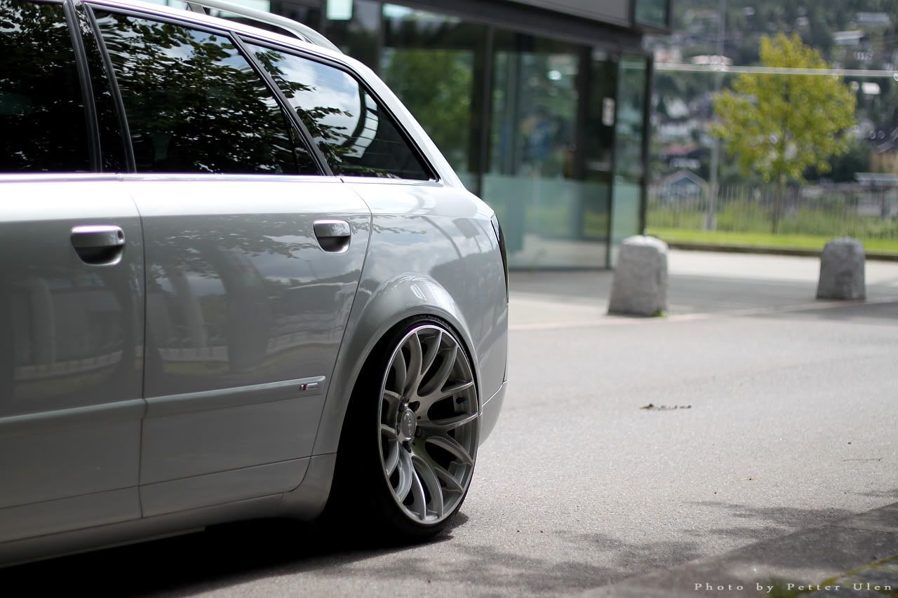

    Not mine, but a friend of mine.
    9,5x18" on all four, static ofcourse. CanŽt remember the ET by hand...IŽll update it later.

    ^et 40 i think from an old post.

    ahhh 8.5s with 10mm spacers. According to MIRO they dont make a wheel to clear ANY Big Brake. Oh well maybe i'll run a set on the wifes car this year

    Active Member Two Rings Dusty Mauve's Avatar
    Feb 04 2011
    70486
    Bergen, Norway
    Looked it up now.
    Et27,5 front
    Et25 rear

    Quote Originally Posted by Dusty Mauve View Post
    this looks pretty awesome because my avant is the same color so i have an idea how it will look... thanks few questons ist what size are those 19's?
    also
    Looked it up now.
    Et27,5 front
    Et25 rear
    ok call me a hard core newbie to the wheel game because i dont understand any of the terms you guys are referring to so can someone break down the science for me. I understand that spacers are needed for "stance", Wheel poke and sometimes to help clear brakes but the "ET27,5 and ET25 rear" not sure what that means or what it stands for etc etc

    If I had to guess based on those numbers, the wheels are probably et 40 with 12.5mm spacers up front and 25mm in rear. Et, or offset is the measure of the distance between the centerline of the wheel, and the hub mounting surface. The lower the offset, the more poke the wheels have.
    http://www.tirerack.com/wheels/tech/...jsp?techid=101
    Reference pic:
    Feb 04 2011
    70486
    Bergen, Norway
    Not sure if he uses spacers, but the numbers come directly from the owner so I guess they are right :)
    Tankdeer pretty much sums it up. Its basically a number that says where the backside of the center is located. ET30 is 3cm from the middle of the whole wheel. ET0 is dead center.
    IGottaP, those are 9.5inches wide and 18inches big :)
