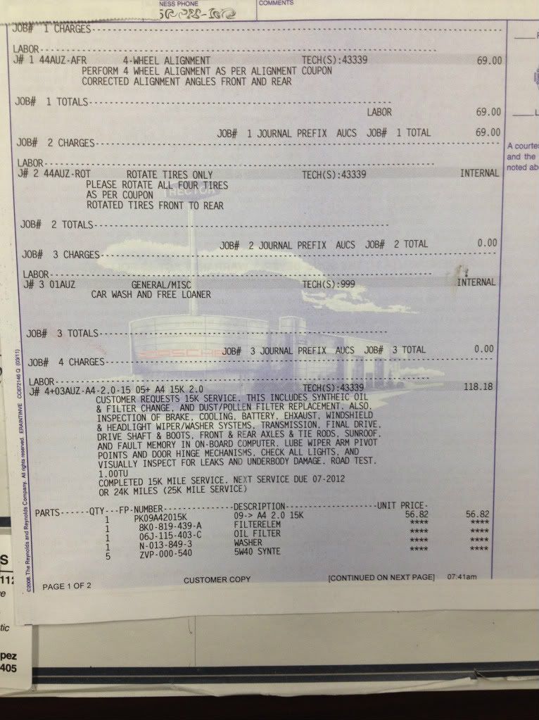

    Results of my $99.99 at Anchor Audi.
    If you are in NYC, give them a call and ask for Christina.

    Jeez, did it come with a dinner at Morton's??? Rector Audi is running or was running a special for $69.00. I couldn't refuse to take the offer especially after I took over the car from my wife
    BTW: if you're close to Rector ask for Paul Medina, he has been great to me for the past 10 years.

    $69 is crazy. What else do they offer on the cheap?
    -cW
    There were other coupons such as free tire rotation, free loaner and some ridiculously (can't remember the price) low offers for a fluids and brakes.
