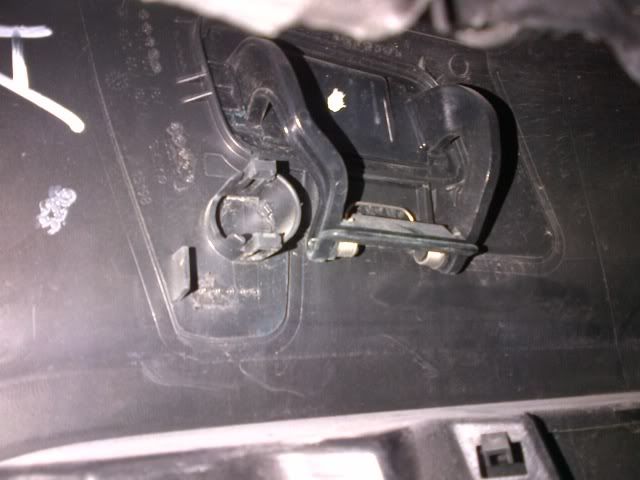

    I think the A5/S5 group may be lucky for front parking retrofits. Thanks to another member who got a kit from me for this picture. It shows the parking sensor bracket built into the bumper already. This is or was (see the post on the poor car after it's recent accident) a 2011 so not sure if it's different for older cars.

    I'll be picking up my new bumper from the dealer when I get back so I can help to confirm this as well.
