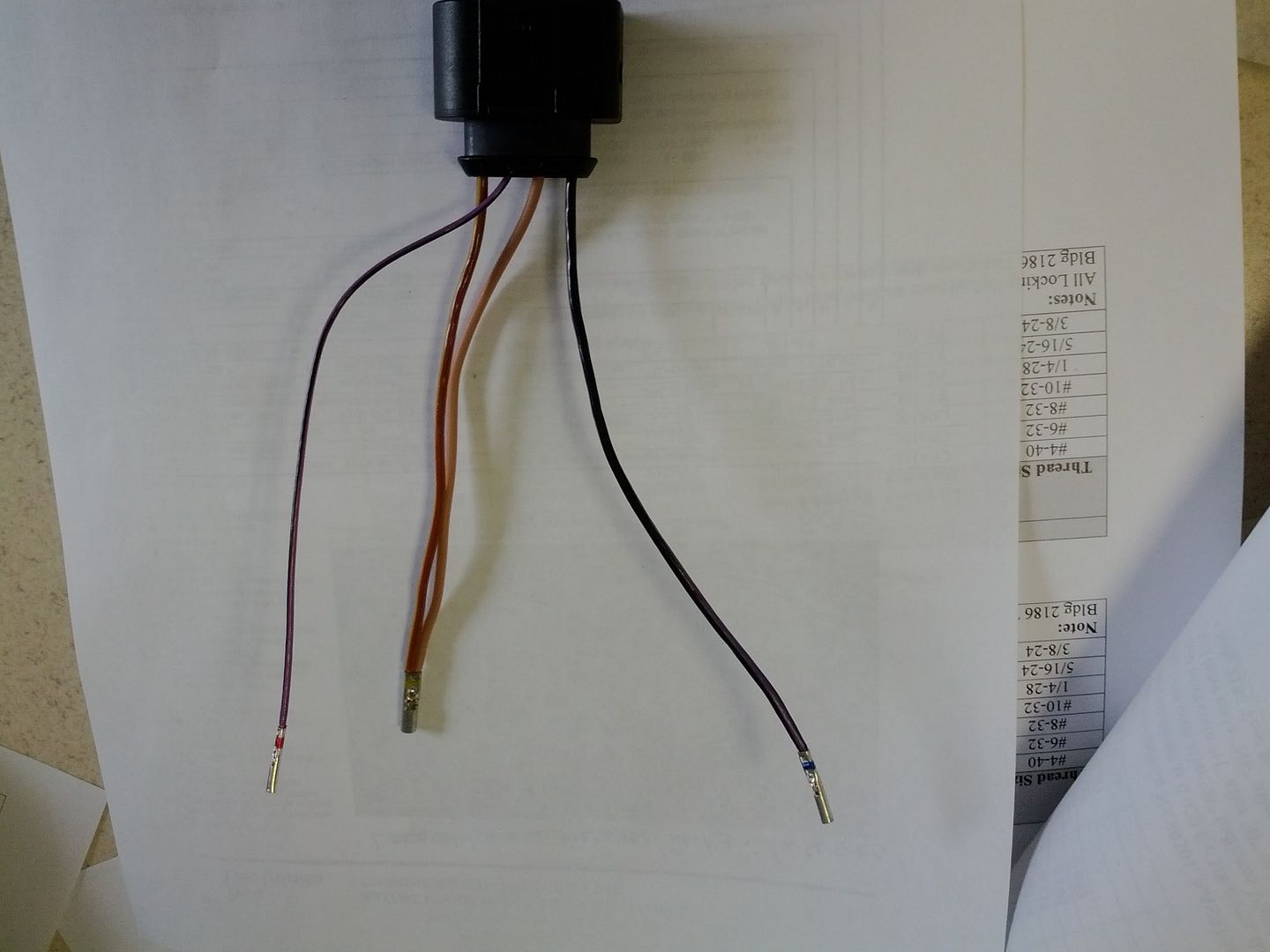

  2. #322
    Veteran Member Three Rings Danza's Avatar
    Jun 28 2010
    60789
    ^ That look right to everyone?
    -Ian

    Quote Originally Posted by RusS4 View Post
    You wouldnt happen to work for DynCorp would you?
    Quote Originally Posted by odhinnhrafn View Post
    Looks perfect, and yeah, DynCorp or L3? lol. We use those splices in Army Aviation, as well.
    I'm a civilian engineer, you can pretty much figure out what I work on by my location lol
    -Ian

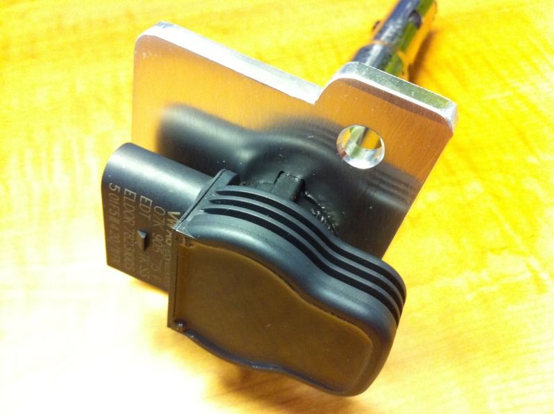

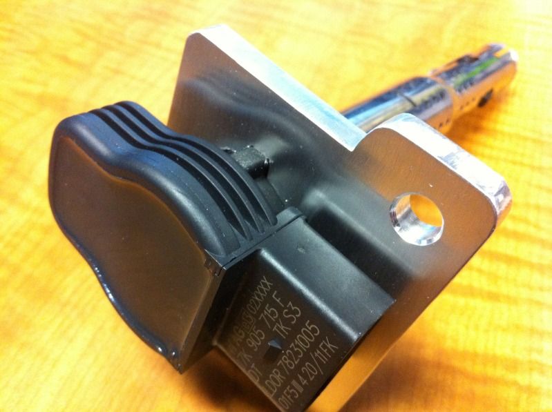

    I'll be doing this swap with the 07K905715F coilpack and I'll be making the aluminum adapters myself. Can someone tell me how thick those plates are? Based on my mockup I'm guessing about 1/2". Does this sound about right?

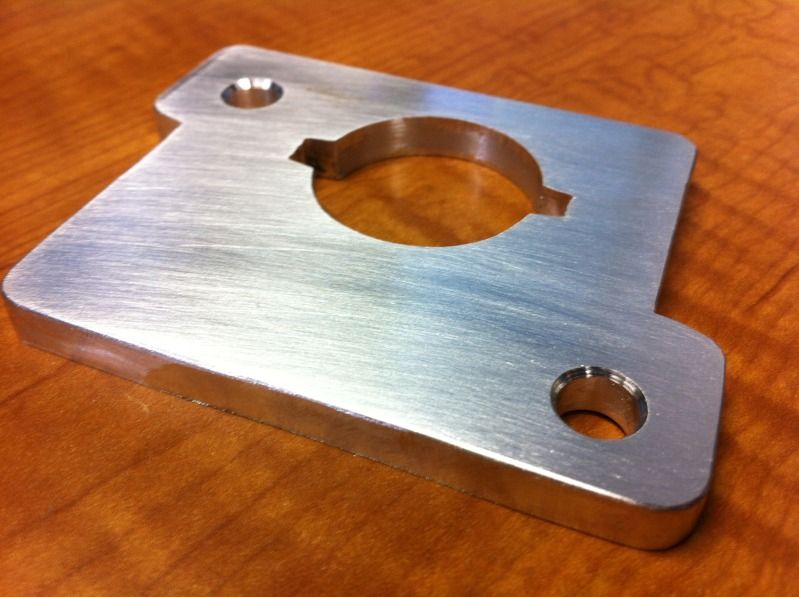

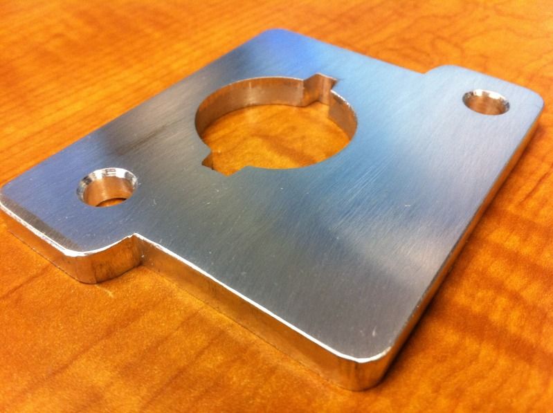

    I don't doubt they will be fine without the adapter (they fit pretty tight) but just to keep the plug holes clear of debris and keep them "secure" I do want to install the adapters. Besides, look at how they look without...
    But since I'm not about to pay $20 a piece for the adapters I'm making them myself (with the help of my retired machinist father). With these latest coils 1/2" or somewhat thicker would do to cover the sealing portion of the coilpack.

    So I just finished making my 2.0TFSI coil pack adapter brackets... see pics below!
