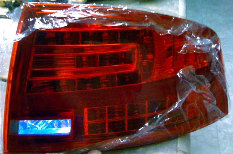

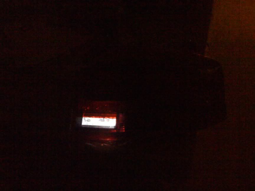

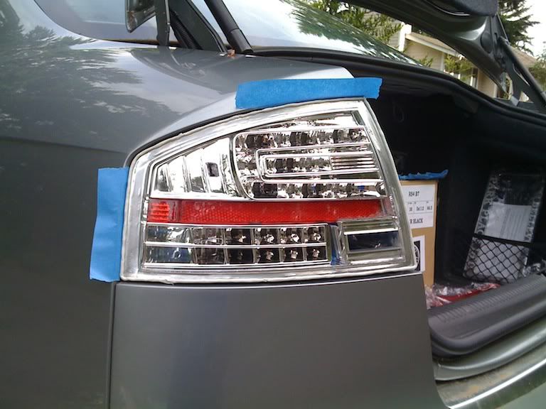

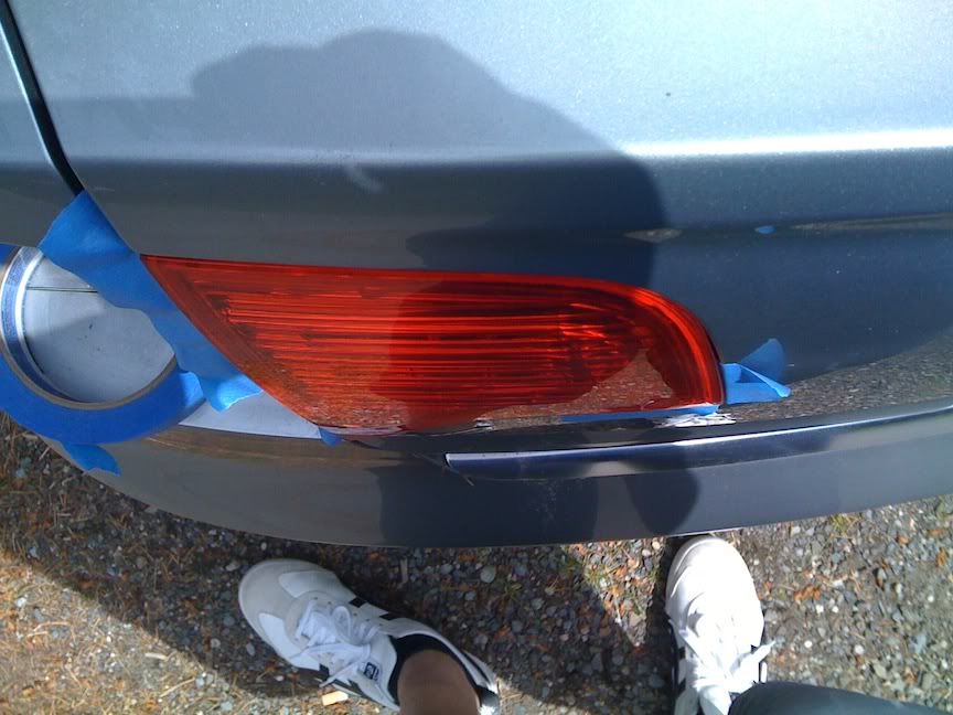

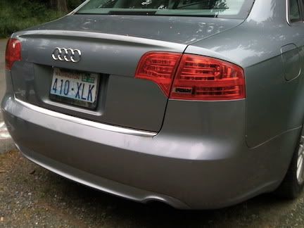

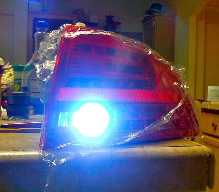

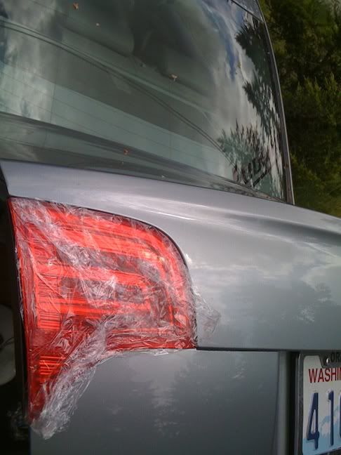

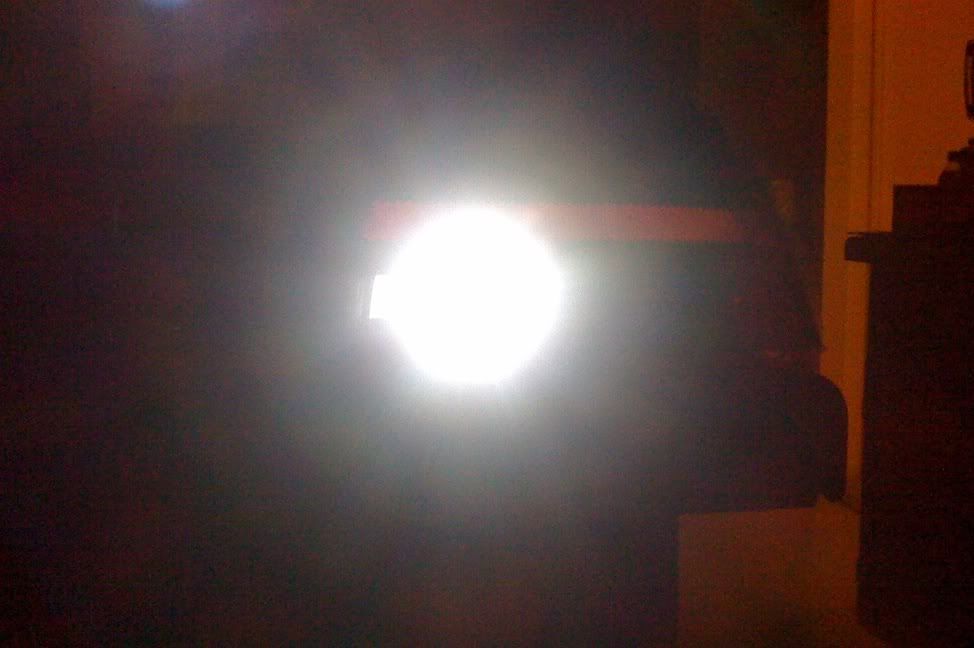

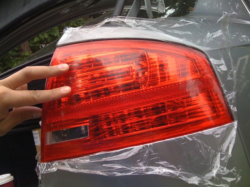

    Since this thread I've gotten a few questions and requests for detailed pics via pm so here you go fellas
    Yes I moved over the entire reverse light housing and rebuilt it on the new light, completely sealing off all light. It's perfectly lined up and flush behind the lens just like factory
    (led cluster reverse bulb lol)
    no idea why it looks bluish with my kitchen light on
    from an angle
    straight on
    This has been covered already in a previous thread. You have to start from scratch and build each set on your car because the oem lens is a lot thicker than the aftermarket.. I had to modify the housings to sit a few mm's more inward on the car, and reshape the surface where the lens will seat in order to get everything flush. I did not modify the lens at all. I also mounted the housings a few mm's higher on the car and the lens a little lower to keep the reflector strip on the lens from blocking the led's. Had to get the fitment absolutely perfect so it takes a lot of grinding and eyeballing
    Hope this helps guys
    oh ya I used aprox 2mm bead of oem taillight sealant/adhesive...nothing fancy
