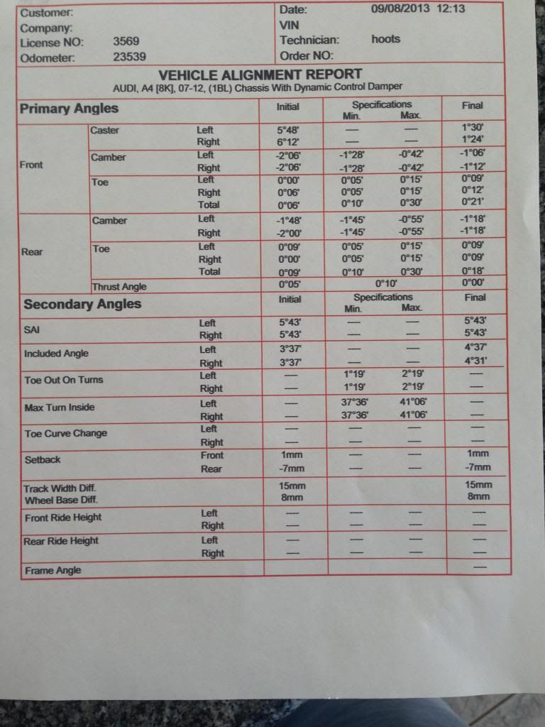

    I just got H&R OE springs installed and alignment done. Can someone help me deciper how off my car is since the shop performed the alignment against specs for an A6 and not A4/S4? I am trying to read this and compare against my "after" alignment specs in the image below. Since caster is not specfied, should I worry about it? Some other people that posted their alignment specs show that caster on their cars were around 4.8 and not 5.27/5.34 of my car. In trying to read the above specs, I don't know how to compare the total toe to the .5" toe on my spec sheet. I know that my front camber will be off regardless since I am lowered now. On the specs above, is the first number under total toe referring to what it should be on each tire and then the second number the true total toe? For the rear camber it looks like max acceptable is .91 and mine are .83 and .89. Any advice would be great as I am a novice when it comes to alignment specs.
    What I need to answer is do I need to go back and have them do this again based on the A4/S4 specs.

    Thanks. Comparing to yours mine looks to be significantly off.

    Any feedback on the amount that I am off from what Phillips posted and if I really should go get it done again?
    Mar 16 2011
    72490
    Quote Originally Posted by gringoloco2000 View Post
    All of your specs look good as they stand. Aside from using 4F A6 profile as their baseline, which may not differ from the B8's toe settings, the shop you went to did well.
    The camber and caster on our cars are static; there will always be slight differences from one another.
