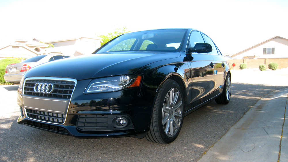

    Wheel Spacers Research + Photos
    I'm loving everything about my B8 (hopefully I get to keep it ) except the wheel offset. I like the wheels and will keep them, so some spacers are in order.
    I still have my B6 with has RS4 Replica wheels with a 35mm offset (8x18). The stance is perfect in my opinion and I would like my B8 to look the same.
    I tried swapping wheels to see how it would look but unfortunately the RS4 reps do not fit on the B8s hub.
    So I took out the ruler and measured as best and accurate as I could.
    On the B6, the fronts sit exactly flush with the fender from what I can tell. The rears it ~5mm inside from the fender edge.
    On the B8, the fronts sit 14mm inside from the fender edge while the rears sit 21mm inside from the edge.
    So to get the same look, I would need 14mm spacers up front and 16mm in the rear. I have not seen either of these sizes so now the question is, should I go with 10mm/15mm...15mm/15mm or 15mm/18mm? 10mm/18mm?
    10mm on the front would put the wheel 4mm inside from the fender edge and 18mm would but the rear 3mm inside from the center edge. That sounds pretty good I'm thinking. I don't think I want to do 15mm on the front as it's past the 14mm that would make it flush and I don't want it to stick out one bit.

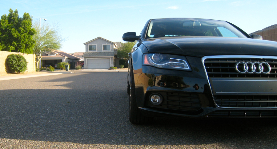

    Here are some photos showing both cars...
    I was surprised to see the stock 18" Sport Package offset is ET47! So whimpy! :)
    Was also surprised by how nice and thick the Sport Package anti-sway bar is. Looks seriously aftermarket.

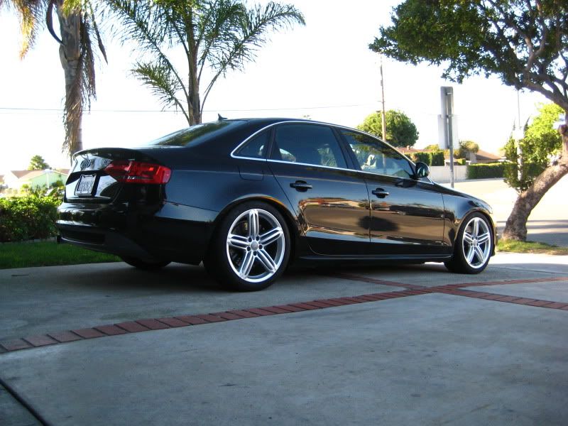

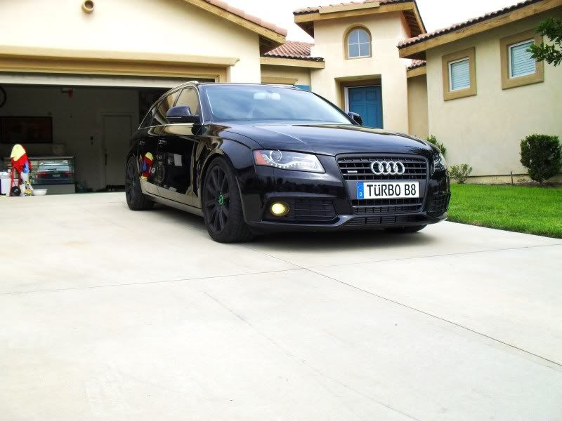

    I've found some B8 photos online which are throwing me off.
    These are apparently 10mm spacers...I think they look really good, especially the front, the back could use slightly more.
    But then these are 15mm back and front and they almost look less aggressive than the 10mm. What gives?

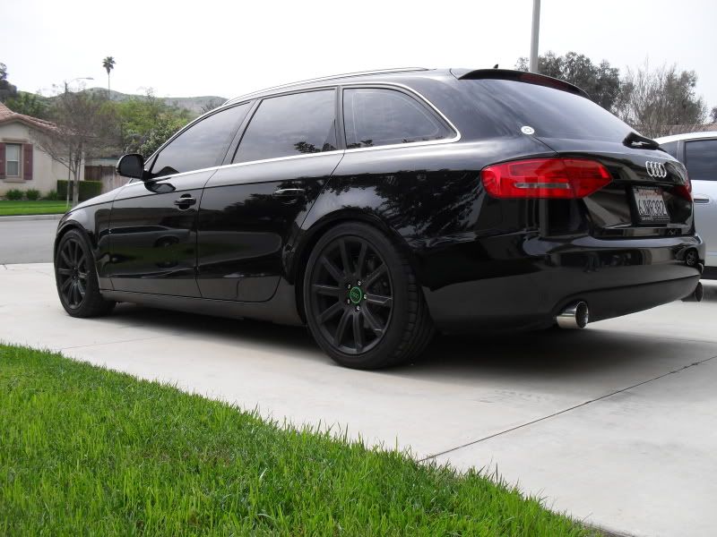

    The avant posted above is mine.
    That was with 15MM spacers all around, and could have easily gone with 20MM in the rear, both before and after H&R springs dropped the ride height.

    I also noticed you are comparing two different B8 wheels above.
    The white sedan is an S4 with stock 8.5 ET43, the rest are A4 sport pack wheels at 8" ET47 (which you obviously know)
    Mar 02 2007
    16074
    Fresno, CA
    I was just about to post that. The trispokes are already 10mm more aggressive than yours.

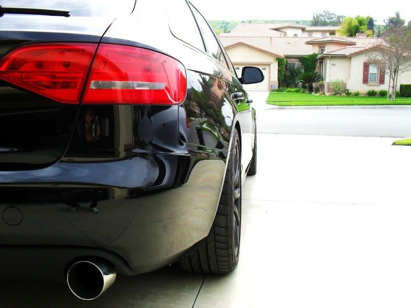

    believe it or not 10mm would fit perfectly on the fronts rolled or not, its the rears you'll have trouble with. when i had this setup, i got a light scrub in the rear on dips and when fully loaded and thats with trimmed liners and a bunch of stuff shaved down.
    this is with 10mm rear(ET33), 5mm front(ET38). sorry dont have too many pictures of this setup. if you can tell with these crappy pics, you can see that the wheels still look sunken in the fronts.
    heres ET32 all around from another setup i had, again fronts weren't the problems. it was the rears.
    thats if you're gonna use the stock 255's.
    actually i take that back, its a close fit and i have -2 camber in the front. anything less and it might start to rub. so i wouldn't say it fits everyone...

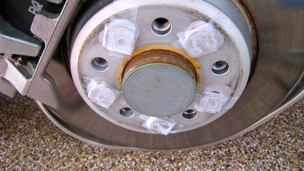

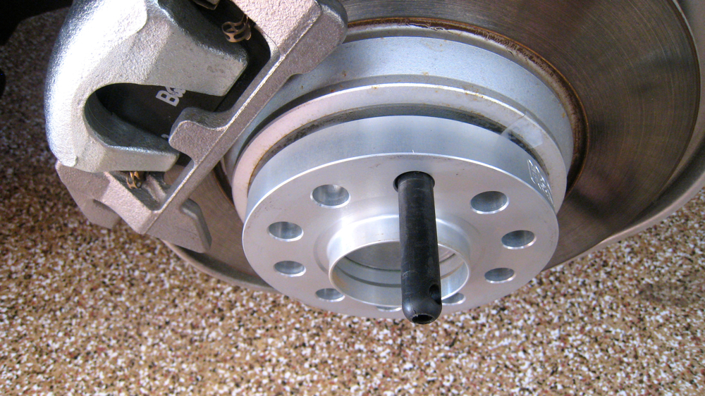

    And they're on! :D
    I'm going to do a little "How-To", even though it's the easiest install in the world, but I just enjoy doing them (similar but of course a lot less complicated than one I did back in 2007 http://www.audizine.com/forum/showth...o-2002-Audi-24... ).
    I went with the 15mm/20mm from H&R with new 43mm front and 48mm bolts. They are definitely not too big, which I was concered about, and I could even see going with 25mm in the back, though this looks nice and still OEM in a way, which I like.
    Here are a couple teaser pics until I get the How-To done...

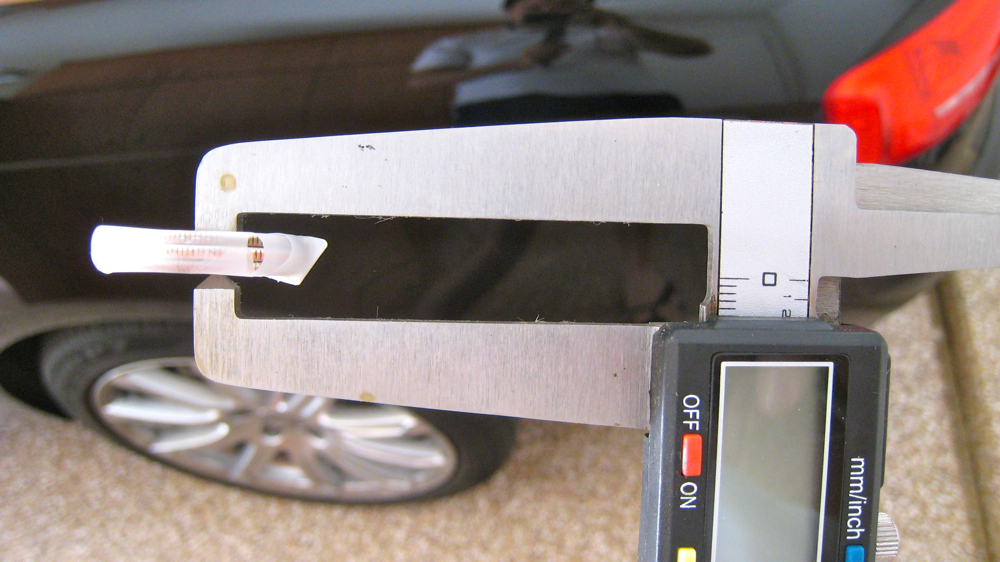

    Ok now you guys have me wondering about the 25mm in the rear. I like how it looks, but I have that feeling where I'm asking myself "I don't know, it could be a bit better."
    Someone stop me if this is too crazy but here is what I'm thinking. Now this is just to test the aesthetics, I will not drive the car like this...but I need to know how it will look and if it's 25mm is too much or not.
    5mm is 0.196". Three quarters (coins) stacked together are 0.187". I'm thinking of taking the quarters together, maybe 3 separate stacks and placing them between the spacer and wheel hub, then mounting the wheel. I'm thinking it should be ok, I'm not going to drive the car, just lower it off the jack to see how it looks.
    Good or insanely stupid? :)

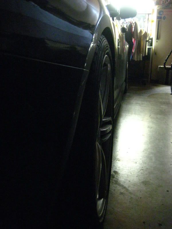

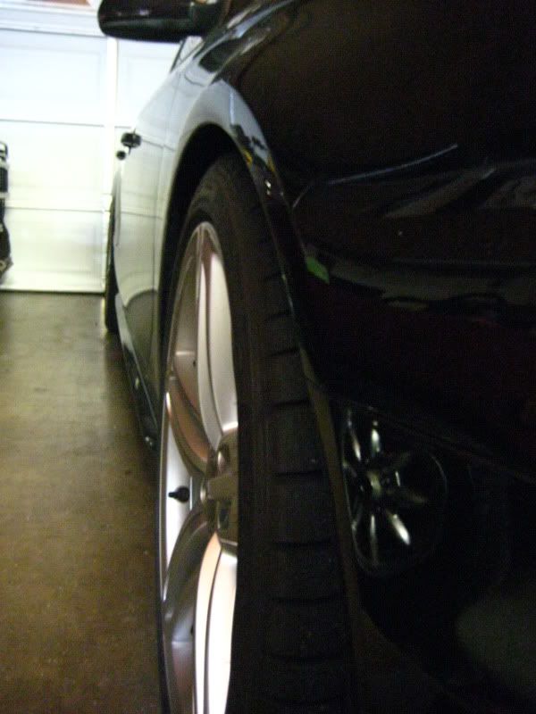

    Did my experiment this morning and I have to say that I prefer the 20mm over the 25mm.
    With the 25mm, something just doesn't look right. Maybe if the car was lowered it would be different, but without lowering it, you can see too much of the top of the tire which looks odd. The 20mm still looks OEM...stock in a way, but a good way. 25mm looks like a staggered setup and I'm not liking it.
    Plus, these Pirellis are a lot more rounded than the Continental DWS (which I will be getting once these are worn out) so with a more squared off tire, it would look even more odd I think.
    A couple photos...
