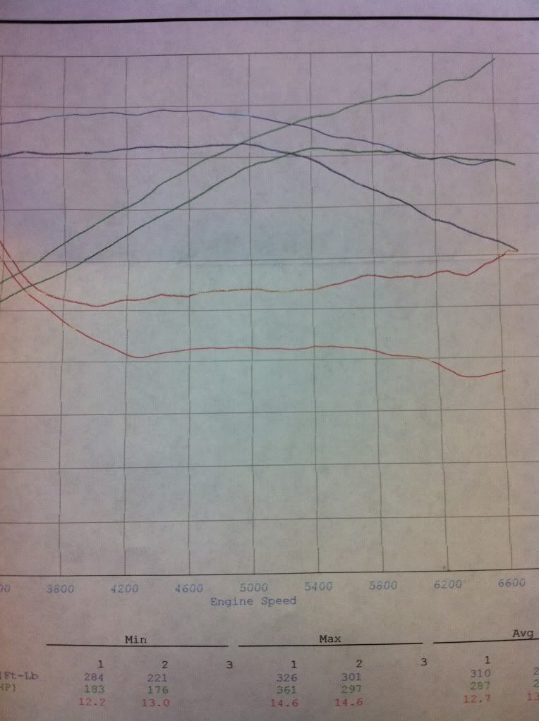

    there indeed has been a software revision for the mtm cantronic. and for my mtm S4 over here in Singapore, it sure is alot faster than before it was tuned. Not sure if its faster than the APR S4 on our end as most of us are on MTM, only 1 i know of is on apr thus far..

    I think it's not so much as a biased/love. Piggybacks "trick" the ECU into outputting more "power". A ECU flash/tune recalibrates things to make more power (and efficient). The difference? APR's tune doesn't cut out boost past 5k rpm (so APR flashed S4s keep pulling hard till readline). A piggyback can't "trick" something that is hardcoded into the ECU (bypass valve opening at ~5k rpm). The graph you linked shows that. There's a few dyno graphs here that show power increase continuously through the range for APR tuned S4s.
    EDIT: Here's how an ECU Flashed dyno looks like (HP continues to climb past where a "stock" ECU would open up the bypass valve - which recirculates boost into the supercharger and not into the engine):
    Last edited by PsYkHoTiK; 04-15-2011 at 12:04 AM. Reason: Added Fonzie's dyno graph

    Nice dyno chart, right up to 5,500RPM when the boost gets dumped. Mine's like a ski jump right to redline
