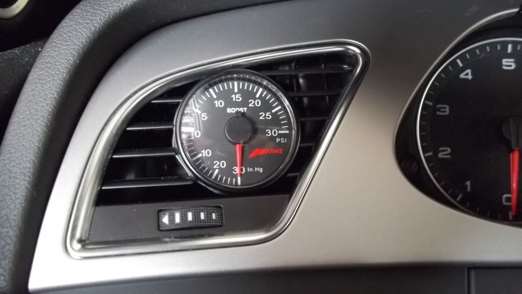

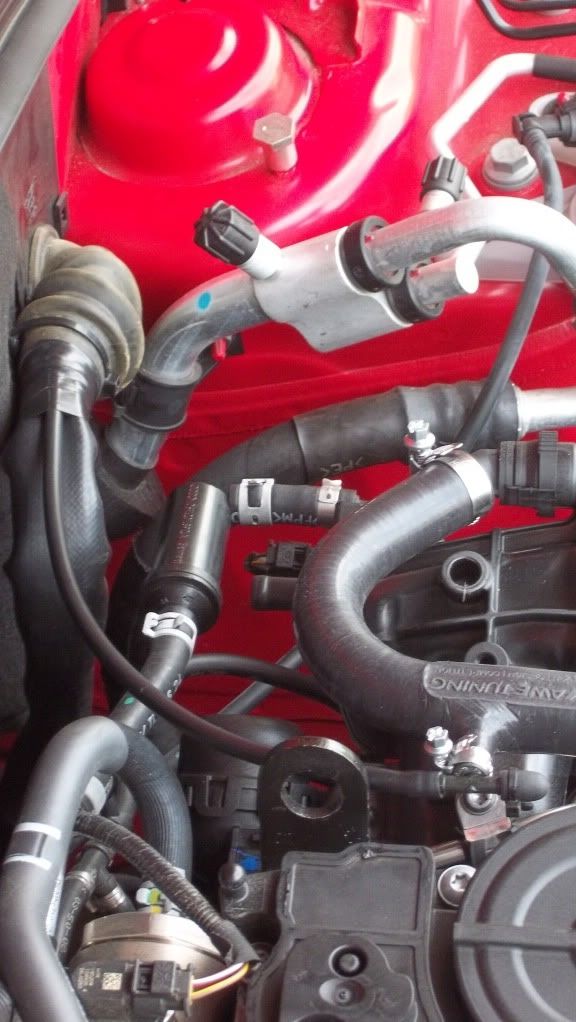

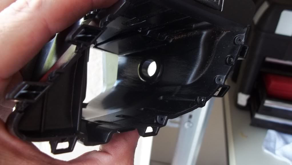

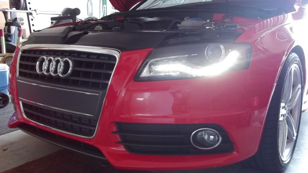

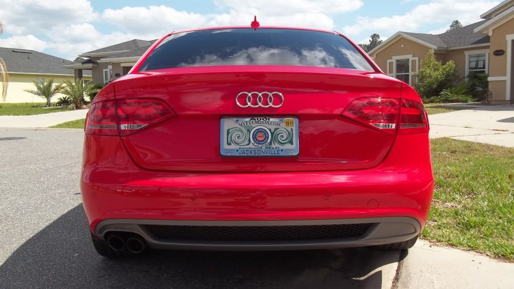

    Here are the pics I promised. I will not have time to install the boost gauge tonight. When I get some time off work I will install it. Worst case scenario, Tuesday. I am also going to takea few interior shots, nothing special, but for the interior I am going to focus on audio variations between stock and modded as well as my instruments. More to come soon so until then, enjoy.

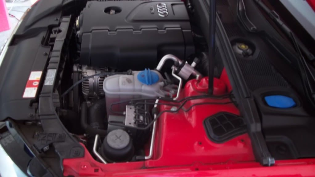

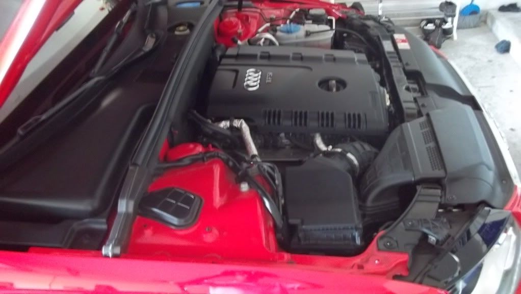

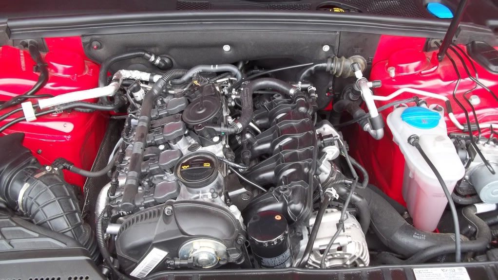

    Photos under the hood:

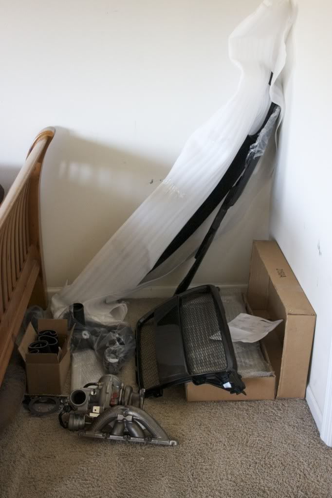

    Got my Eurocode FMIC and CF goodie today. I am supposed to get my K04 and exhaust next week. Now...here is the big question. Should I install everything next week or wait until I get the intake?
    Things are still in the air about my local dyno so I am thinking about making the drive to the next closest one in Orlando and getting some colombian food and a few dyno pulls.
    Suggestions? Comments?

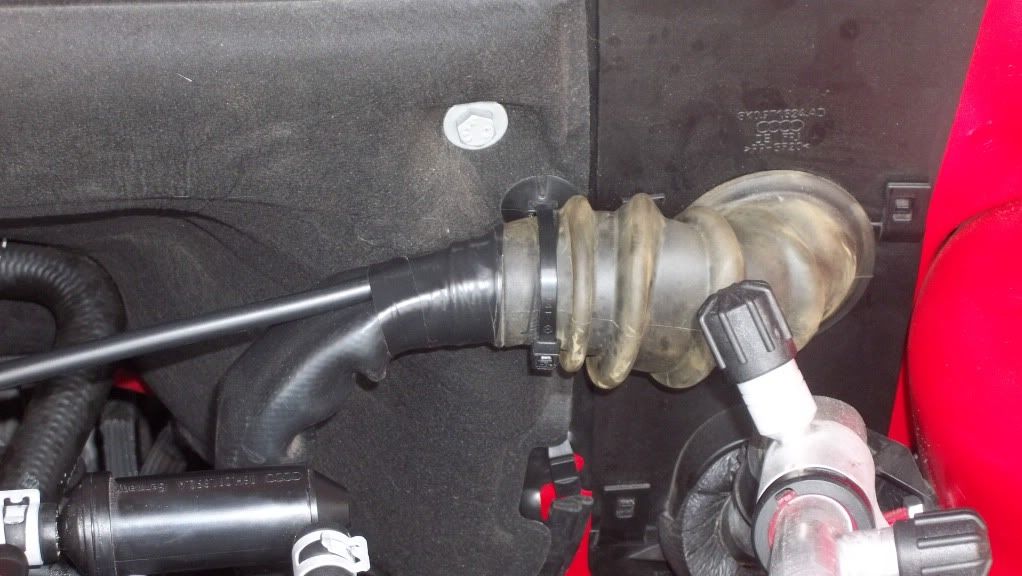

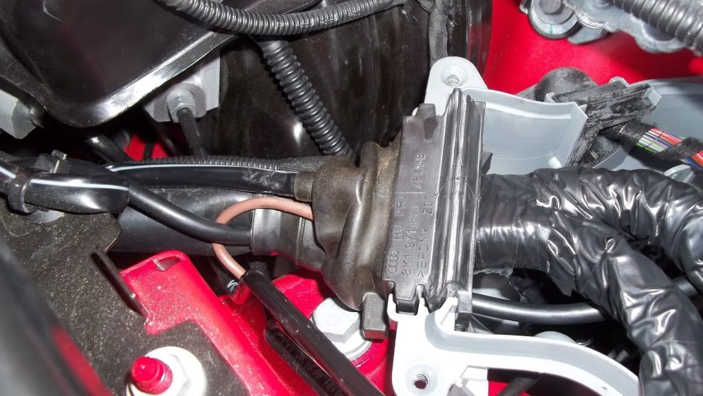

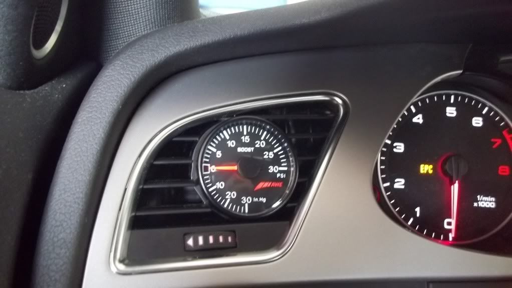

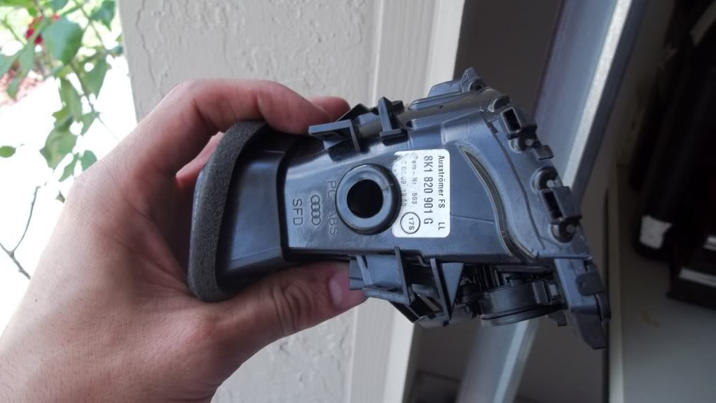

    So I just finished installing the AWE Boost Gauge. Pretty easy and straight forward except for one small issue. The directions are perfect until you get to the wiring portion. My guess is that my trim (S-Line) has the fuses in a different orientation then what was originally designed by AWE. With the AWE wiring configuration, the gauge still works, but the switched power is attached to a 12v constant, and will remain on when the car is off. This is only a problem if you are relying on the directions completely and are clueless when it comes to wiring. As for myself, I was an aircraft electrician for 6 years so I dont have any problems in that area. So please, grab a multimeter and check your connections prior to sealing everything up. I would suggest that for any electrical work. Also, when taping into another wiring harness, use some common sense. Grab your owners manual and pick a fuse block that is used for something that would normally only be operational with the car on.
    Other than that, which only caused me...MAYBE 5 minutes of extra work... this install was quick and easy and the product looks GREAT! The fitment of the actual vent piece was flawless and the wire taps that come with the kit were very handy. I deviated from the install slighty by not cutting into any of the boots, and adding a simple rubber grommet in the air vent that my electrical lines pass through. This would prevent any headaches down the road JIC the plastic were to cut into the wires causing a short. Anywho! Without further ado, pics are below with a video of operation (sorry for video quality, definitely not my best camera).
    Not sure how to embed...so just click on the picture below and it will take you to the video.
  29. #69
    Veteran Member Three Rings Scorpio's Avatar
    Apr 15 2009
    41258
    Texas
    nice job..cant wait for your k04 updates

    thank you for the detail picture of the AWE boost tap and the no cutting the boot suggestion. I have the p3 digital vent gauge, reading boost off the ecu currently. I have the AWE boost tap in my trunk for about a month now, going to attempt to install it this weekend so my boost gauge will obtain boost via the tap instead of the ecu for an accurate reading.

    So I got back home last night and had a few packages waiting on me. All my body work is in as well as my K04 upgrade. I called Eurocode to check the status on the exhaust and it either left today (Thursday) or will leave tomorrow (Friday). I tried calling the dyno shop, and to my everlasting surprise they didn't answer. I will try again tomorrow. I also have to get in touch with my insurance company to get my car looked at for an estimate on my front end repairs. I do not want to install any parts until the car is repaired CORRECTLY.
    Other than that, I will also call EC tomorrow about the Carbonio intake to see how much longer before I can get that in as well. Supposedly I am going to be traveling in 2 weeks so I was hoping to have everything done before I go and get a day to have some fun. Anyone want to see some pics of everything?

    i can imagine a huge stockpile of parts

    Quote Originally Posted by TofuShop View Post
    Not to far off!
