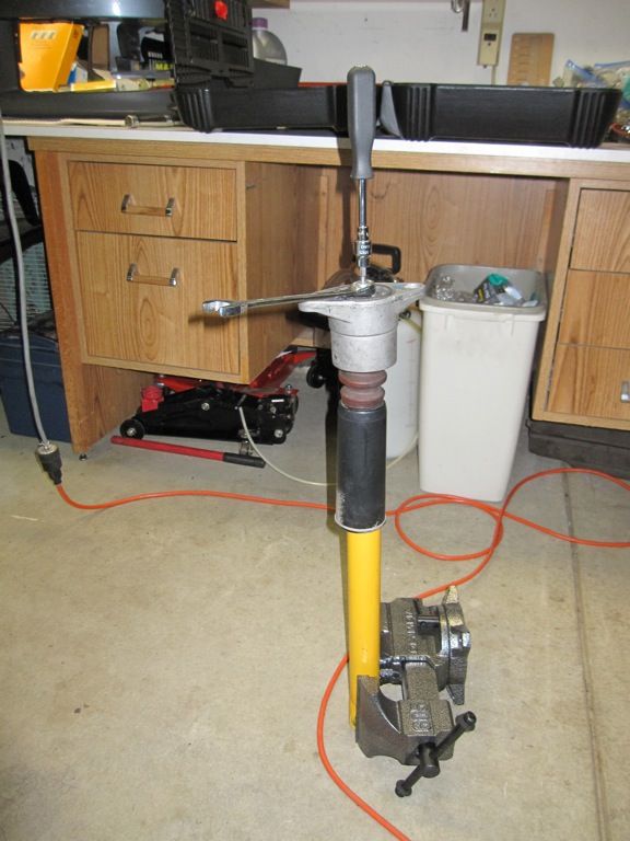

    Nate, maybe this'll help.
    After doing this the hard way when we first installed my Koni's, I tried a different route when adjusting them.
    I popped the shock in a vice on the floor and then used a square head driver to depress the sliding arm alllll the way to the base.
    Then, when fully depressed, you can rotate it using the driver. When it stops, you'll know you're adjusting the shock and not just spinning it.
    I went back and forth a few times to get the feel of it, then rotated it all the way left / counter clockwise to start at fully loose then adjusted accordingly.
    The way I was holding the driver / rotating my hand, it was four turns end to end.
    As I'm using these with an Eibach Pro Kit, I did 25% for the rears and about 50% for the fronts (but I've gotta redo the fronts, something is off).

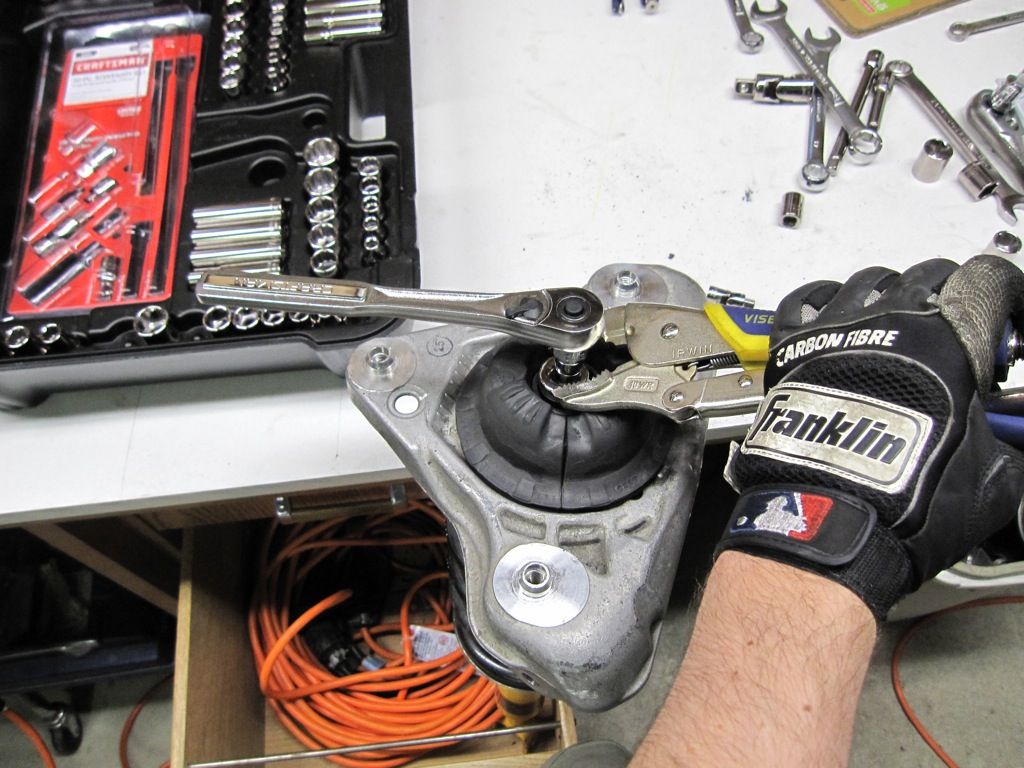

    Afterward, you need to be sure the top nut is tightened all the way down or the shock will clunk. And BALLS is it ever annoying.
    Yeah, I know. Vice Grips are ghetto (oh and I was just using the drawer to hold the shock so I could take this pic... held the base in the vice as well.)
    Also, I cut my front dust boots down by about 2-3in but am thinking about removing them completely. I suspect they're making noise but unsure of that yet.

    I don't think the issues is with the nut coming loose. It should be a Nyloc nut. The problem occurs when you go to tighten the nut. The shock shaft offers little resistance and turns as you tighten the nut. You either need to use a hollow socket set and an Allen wrench or else clamp the top portion of the shock shaft to prevent it from turning. Otherwise it is extremely difficult to tell when the nut is tightened properly.
    such as a pair of vice grips around an old t-shirt up towards the threads?

    I have noticed those nylock nuts should be replaced every few uses. It seems like they do indeed back off slightly, well atleast on my 9hlins they seem to back off if re-used a few times.

    just to update this thread, since it was linked to. i got everything in fine and used a hollow socket set and an allen bit to tighten down the front nuts on the koni's. no problems here. this was back in 11/11
