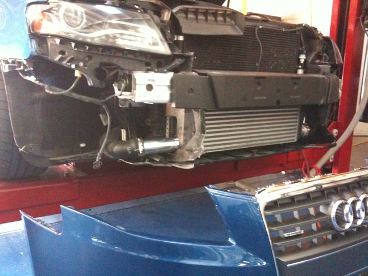

    'MrPerfect' ....what brand/size core did you end up using? Can you share some details of the custom fitment around the crash-bar? Did you stop at the endtank inlet/outlet (like AWE) or did you replace piping from the turbo and to the TB? Let's see some pics :)
    Way late on this but...
    Almost double the size, less than .43PSI pressure drop, and no modification of the bumper cover. This picture isn't of my car, but it's the same deal. Jon at Goodspeed jigged this up and is able to re-fabricate it on demand.
    Tons of Audis, Tons of Mustangs. That's just how I am.

    Quote Originally Posted by MrPerfect View Post
    Cool. Good to know that somebody is stepping up and giving the B8 some love.
    How do you like it so far? Do you see significant power gains over stock?
    What did it cost you, if you don't mind?
    I'd really be interested in hearing about any other options besides AWE (which I'm sure is top quality) but friendly competition is always a good thing IMO...

    Wanted to follow up on what Mr. Perfect posted. I contacted Jon at Goodspeed for more information on their FMIC. The following is what he told me via email:
    The unit is a direct fit with no bumper modification and is designed to keep the core low, as to not cover the majority of the radiator causing poor air flow over the radiator and A/C condenser. The kit will include all hardware brackets and the intercooler along with a full set of instructions that has not been finished yet as all the units sold so far have been installed in house. Testing has shown a very significant drop in intake temps over the OEM as well as the currently available units on the market, and its shape keeps a much more even cooling effect than a tall thin design which when measured is not significantly larger than the OEM. Our core measures 616 sq inches and the oem is 357.5 sq inches, giving almost double the capacity yet looks very OEM through the front grill. The pricing is much less than what is currently available as well retailing at only 789.00.
    With that being said, I inquired if they (Goodspeed) would be willing to give those of us who are interested a discount if we could put together a group buy, to which he responded yes. He was wondering how many people, and how soon folks would want the product? If you are interested please feel free to pm me and hopefully we can put something together sooner rather than later.

    if possible I would love to see more pics of the core/end-tanks/included piping off of the car.....can you see if Goodspeed has any additional pics of the product?
    ...and possibly a little more info on how it's installed to the car.....drill through crash-bar like AWE?

    Quote Originally Posted by cory_can View Post
    Will do...

    tank and inlet design will change that. Inlet is of factory size
    (2.25) as to make this a direct bolt on. As for modification to the
    car only 2 small pilot holes in the back of the bumper beam will have
    to be made and a proper size drill bit can be supplied. And to your
    question on size, yes i did mean cubic not square, my mistake i
    apologize.
    I will try to find some more detailed photos for you this weekend
    Jon stated that he is willing to answer questions people can email him direct. If you would like me to send them just let me know. Hopefully this answers some questions.
