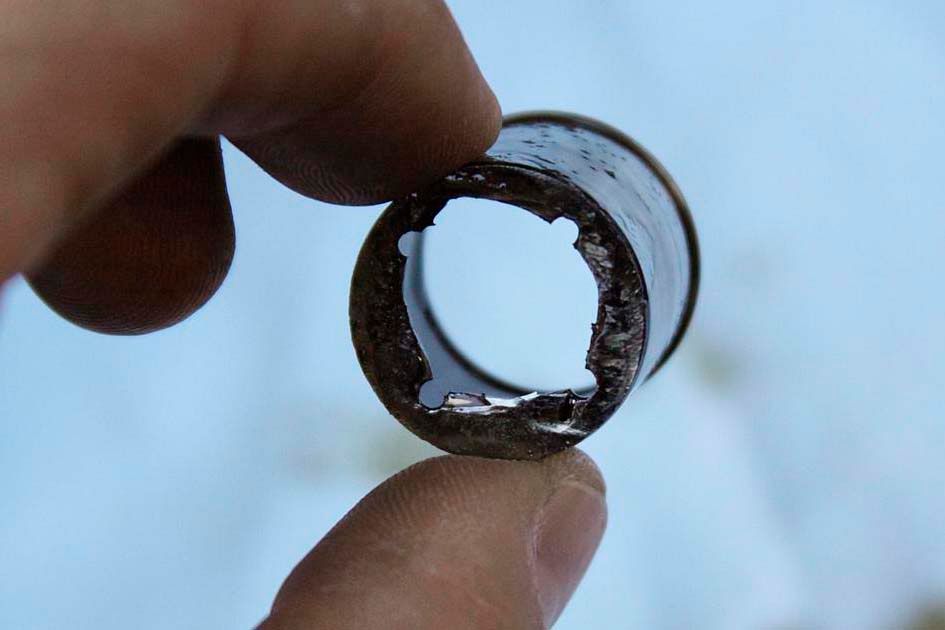

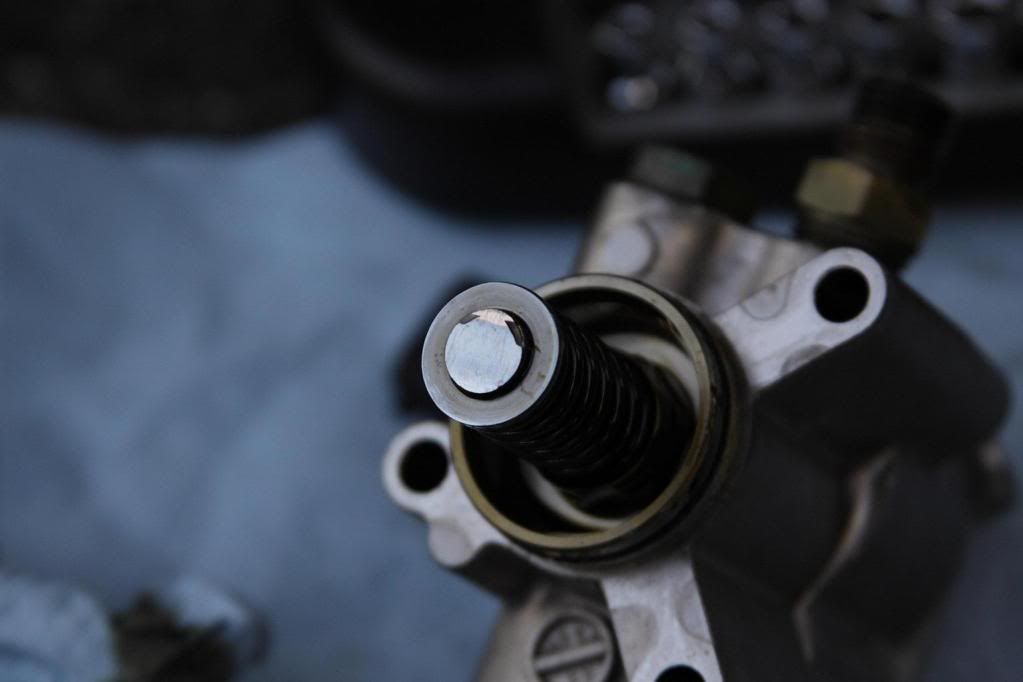

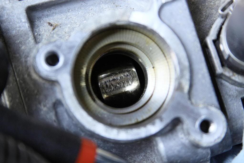

    CAM Follower !!! F%#K ... SECOND UPDATE: cam, cam follower & HPFP replaced !!!
    Just came back in the house. Check this out. More pics coming soon. Will call dealer tomorrow. It's still under warranty. 65k miles on the car.
    CHECK ENGINE light came on after first start. Is it normal? It went away after a few starts.
    SECOND UPDATE 10/20/2010 As the title says I got everything replaced under warranty. The dealer was not easy to deal with, but after all I could not be happier I got everything fixed. And above all the tech found the missing piece. Thanks again to all for the info you guys gave me, special thanks to vannyhuj for his emails. I really think everybody should have the cam follower checked even if nothing seems wrong. That was my case. The car was driving perfect, the only thing I didn't like it was the extended crank at start. But I'm not sure if that had anything to do with this. I will see how's the start when it'll get cold.

    ouchhh! could you see damage on he cam? You under warranty? Man when i first bought my car and read so much about this, everyday i drove my car i would worry about this happening so i feel bad for you man cuz that could be pretty expensive if not under warranty. If you gotta pay for it yourself, you could try just changin the follower and the fuel pump and see if the cam was truly damaged. I'm curious if the cam does get damaged enough to require changing or the dealer just does it as precautionary practice.

    Quote Originally Posted by makav3li View Post
    No you can not just change the follower.. It will wear out quicker than a hooker on crack!

    Yeah x3 OUCH!!!!! :-( You have to replace the cam, follower, and fuel pump with that damage. What year and miles?

    I'm not convinced that you really need to change all of those parts, because if he spring in the pump breaks thru the follower, i can't imagine that spring is strong enough to do that much damage to a metal cam. Now I dont know first hand if this is true or not but this is just my assumption. I think if you just changed the follower, in some instances, things will be just fine.

    Ouch. Sad, but unfortunately a pretty common problem with these cars. PSA: Check your followers with every oil change!
    Looks like you'll be needing a new cam, follower, and fuel pump. Good thing you're under warranty still!

    now my other question is where did the metal that wasin the cam follower go? Inside the cam area? Up inside the pump? I guess that would kind of scare me :-/
    if you look at the photo of the cam lobe, it is obvious it's toast: the pump plunger ate right through that thing... OP, have the car towed to the dealer and since you are under warranty you should get your car back in a couple of days...
    What do you guys think about this? He's making a good point here. Where's all that metal gone? I would assume in the engine? Do any of you know what's the procedure when they change the cam? Any cleaning involved? Do they usually get rid off all that extra metal that came off the cam follower? or that will stay in my engine forever?

    All the metal will end up in your oil pan and will attach itself to the oil screen which will eventually compromise oil flow. Your engine will need to be flushed and your oil pan will need to be pulled off in order to clean out the metal shavings from the screen. My follower, HPFP, and cam looked exactly like yours when I had mine fixed earlier this year. Unfortunately I was out of warranty and ended up costing 2500 bucks including cleaning out the shavings. Just have your ECU set back to stock mode and the dealer should take care of it since this is a common issue for our cars.
    You should also have them carefully check your cam chain tensioner and cam chain while they are in there. After putting my car back together it was still making a louder than normal ticking noise. It turned out that apparently some of the metal had been caught in my tensioner causing it to stick and damaged it and the chain. Another 900 bucks:(

    Quote Originally Posted by shiro1745 View Post
    I had the exact same thing you did. You can PM me for full details. Basically the piece of my cam follower came off as one, and ended up lodged around the cam chain tensioner. So I wouldn't expect this to end up in your oil pan. Oh, and I just happened to find the piece by accident. I highly doubt the dealer will do this if you don't tell them specifically to look for it.
