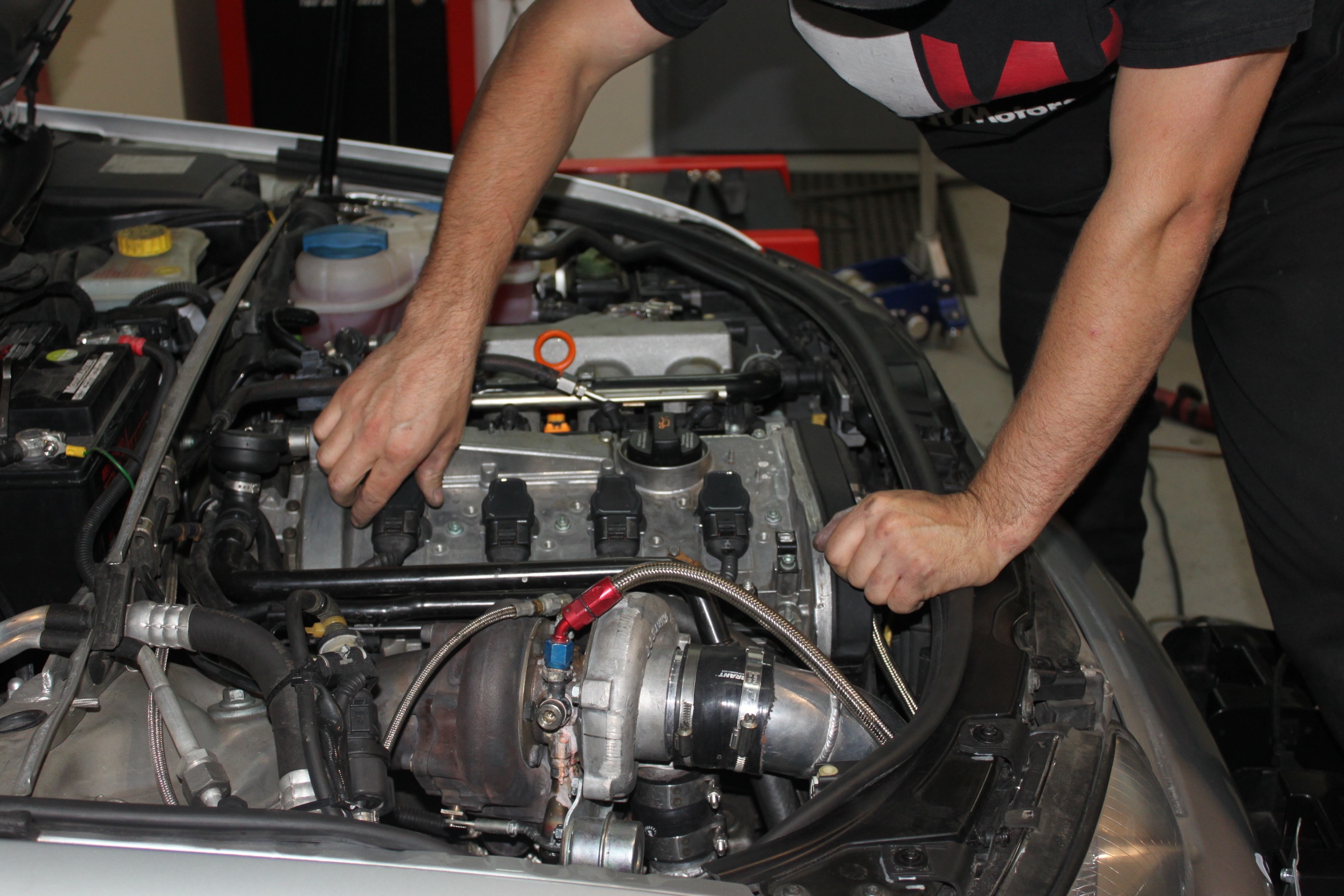

    My friend Jason's car was at the shop (August 11, 2010) and I asked him if I could dyno his car as he has a 2871 setup that he daily drives.
    So I did a back to back test with OEM rev. R, rev. D coilpacks and the Okada Plasma coilpacks

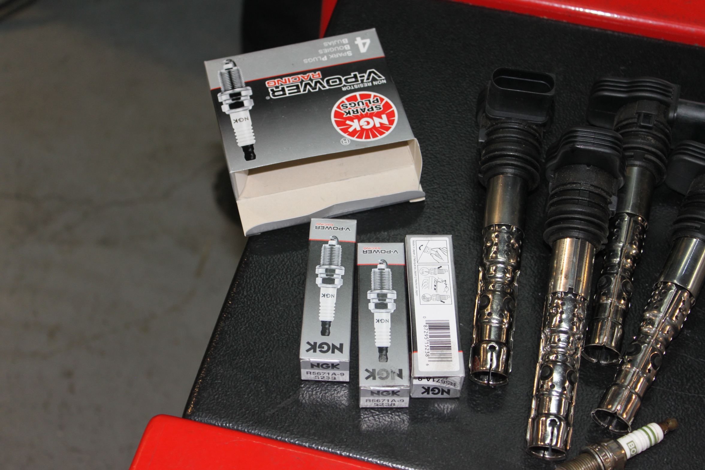

    Then we did a two more pulls to compare the Bosch FR6DTC 2 prong plugs vs a new set of NGK 5238 single prong temperature 9 plug to see if there is any effect running a colder plug or for that matter a new spark plug vs. a 5 month old one.
    The time between pulls is the amount of time required to swap out the coilpacks or the spark plugs.

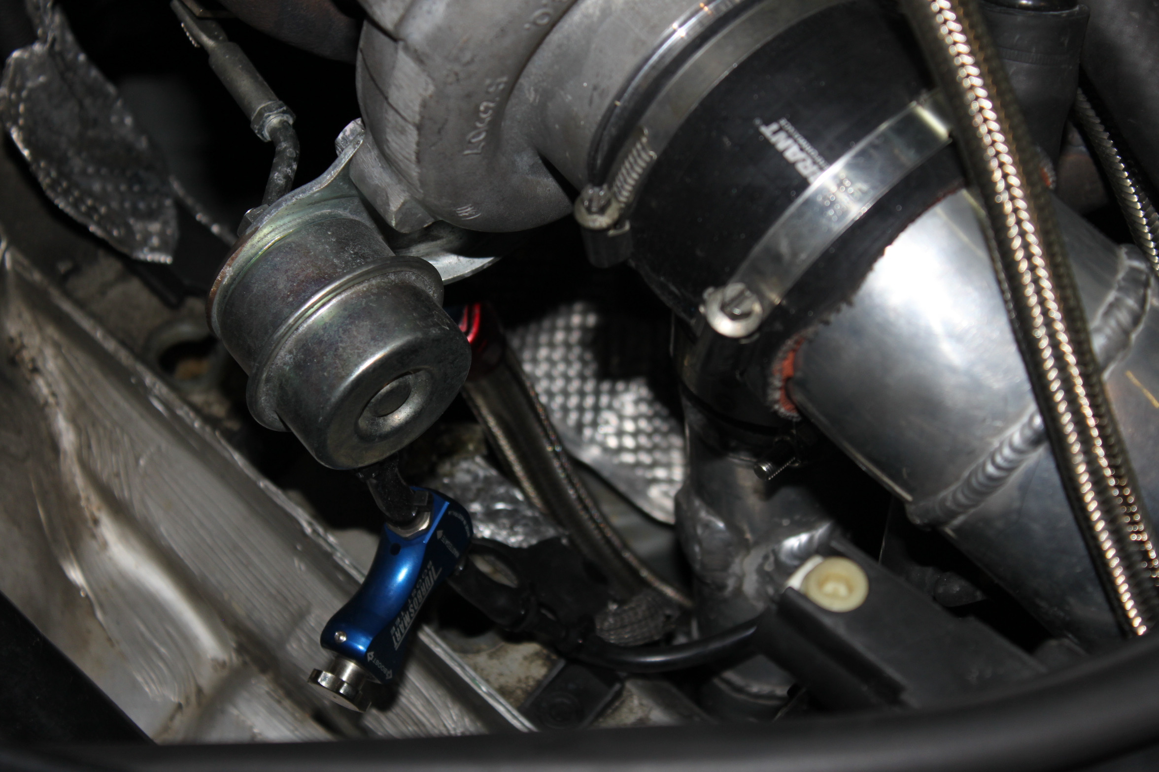

    All pulls were done at 18psi as that is what his manual boost controller was set at and 94 octane gas. His car is not running meth.
    Picture of his MBC
    Once again all I wanted to know if is these Plasma coilpacks would provide any gains by just swapping them in WITHOUT any tuning to take advantage of the extra spark.

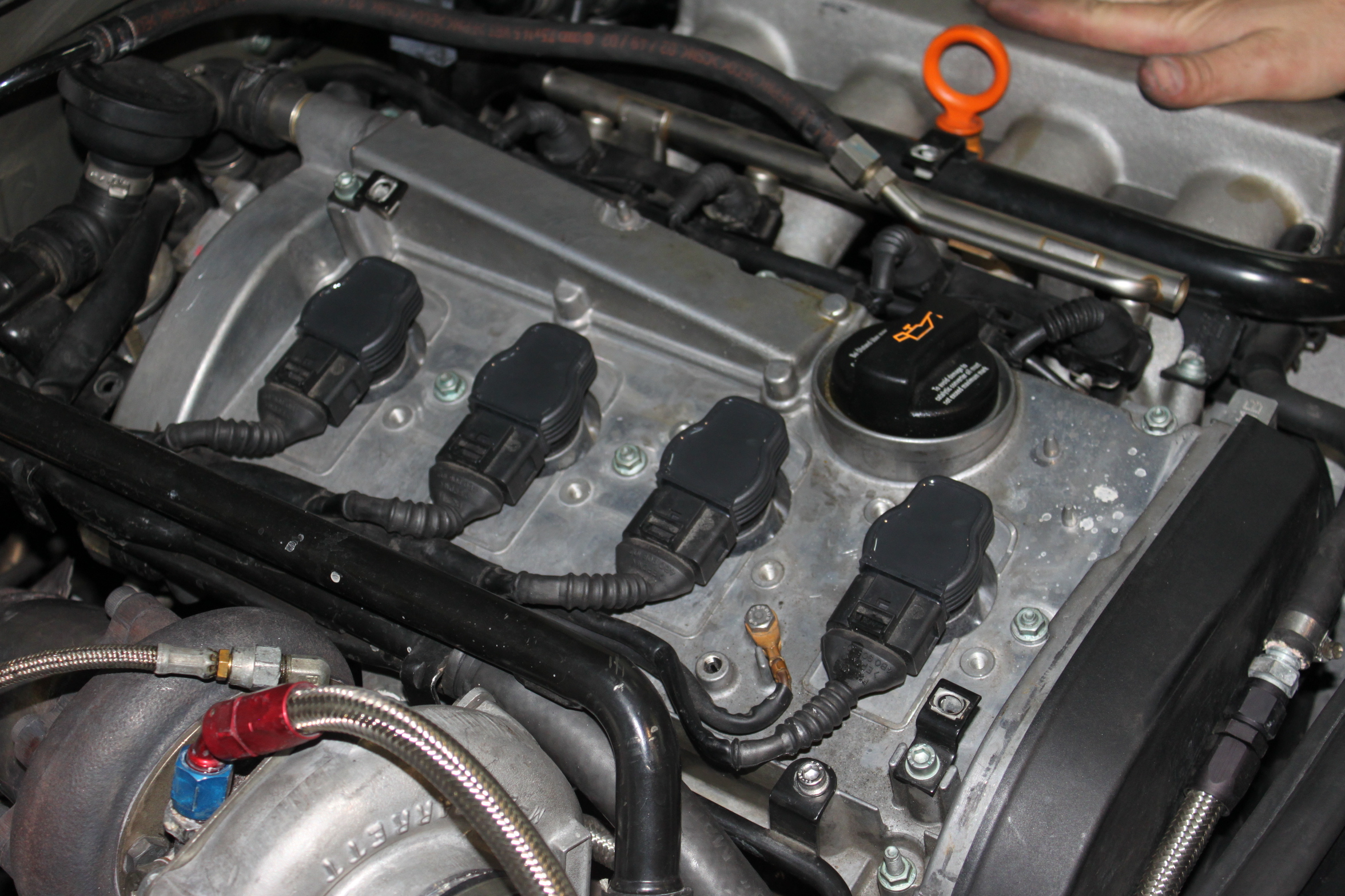

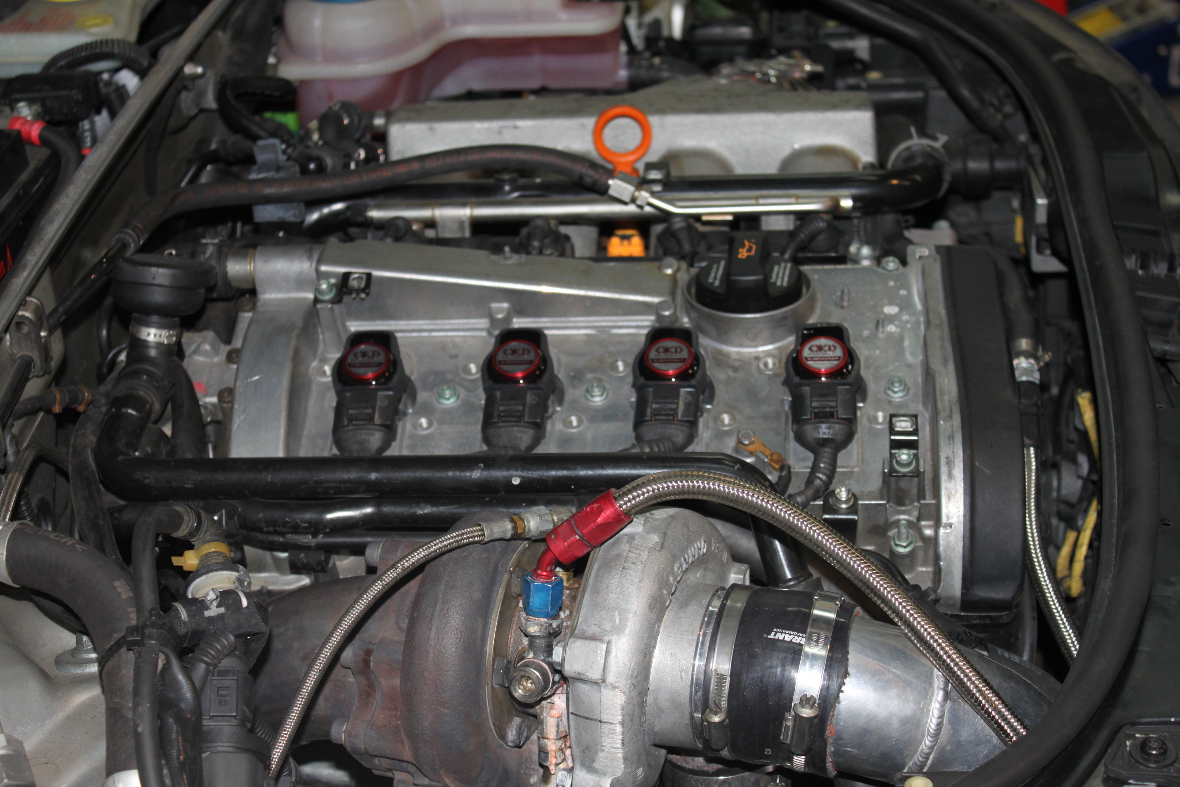

    stock rev R coilpacks installed
    this is the video of the logger for the OEM rev R coilpack pull

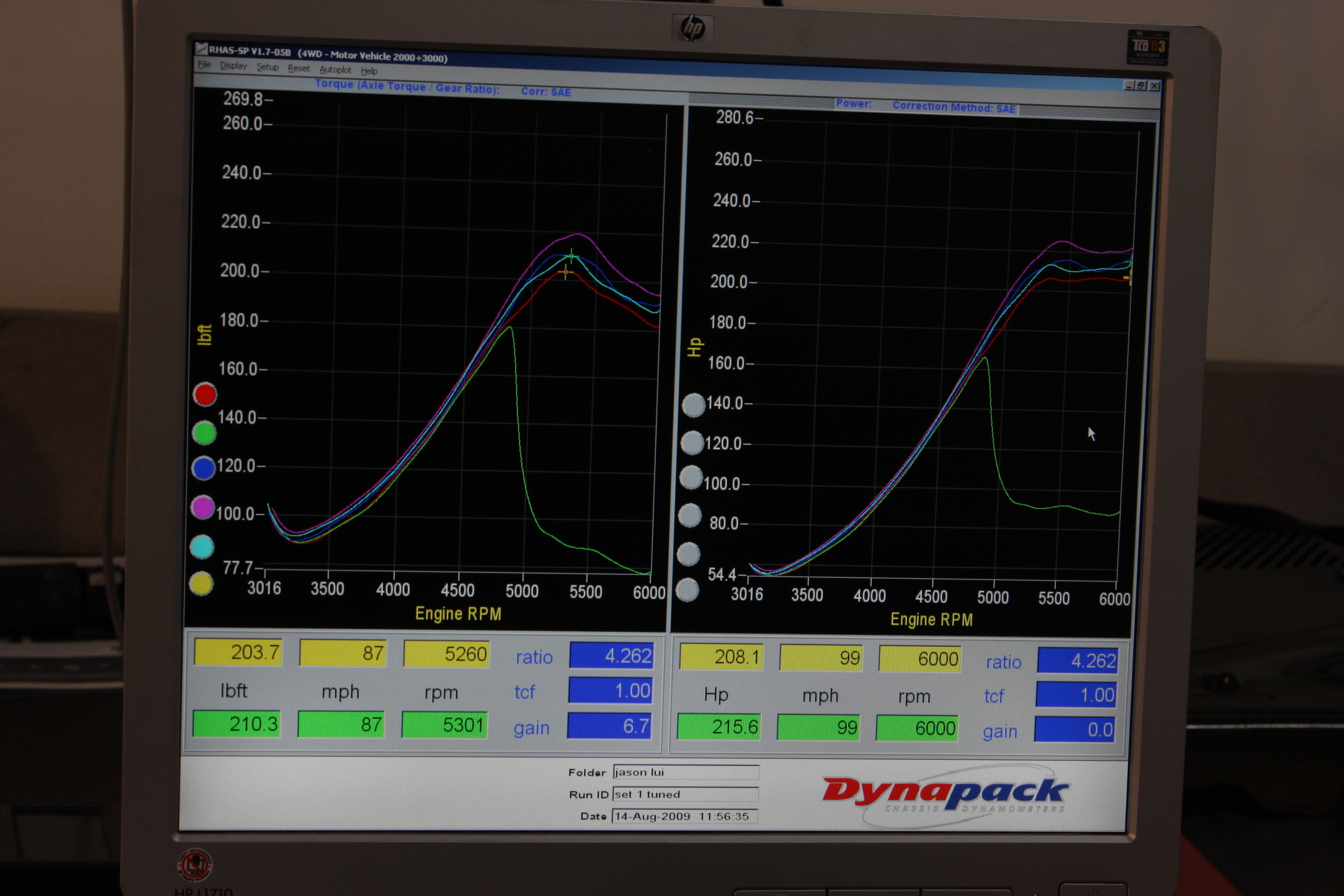

    dyno plot (solid red line) with output figure

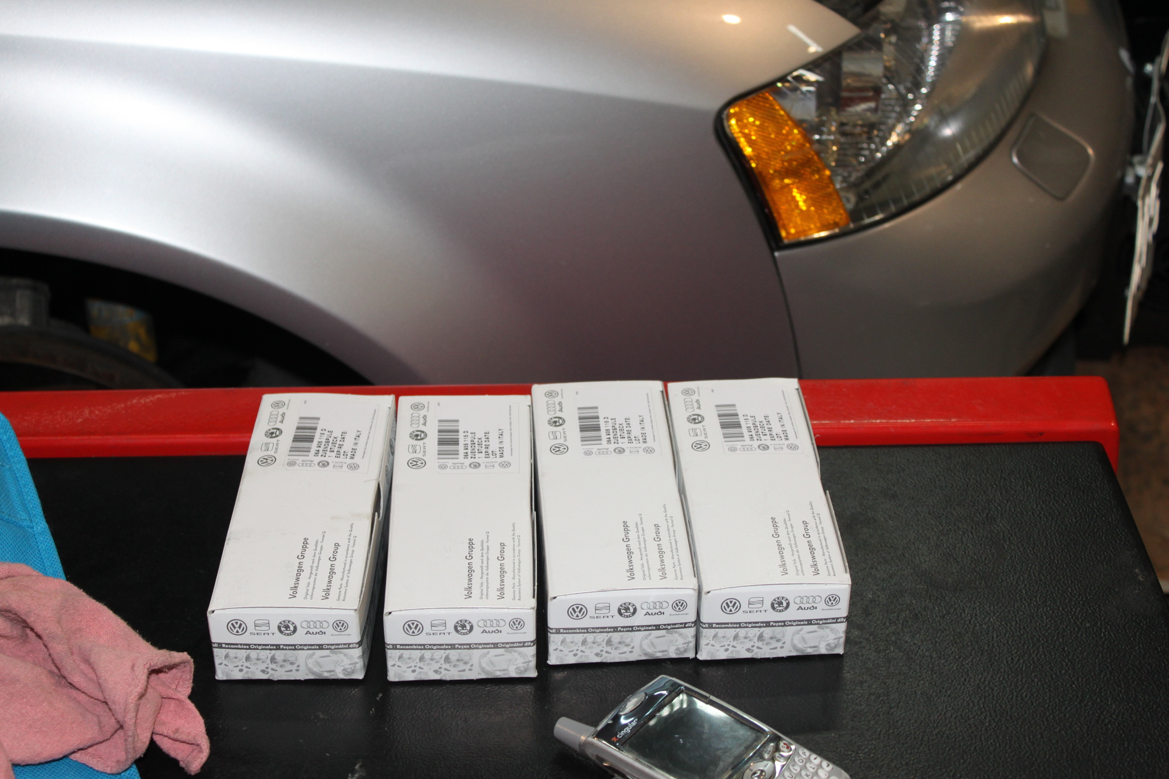

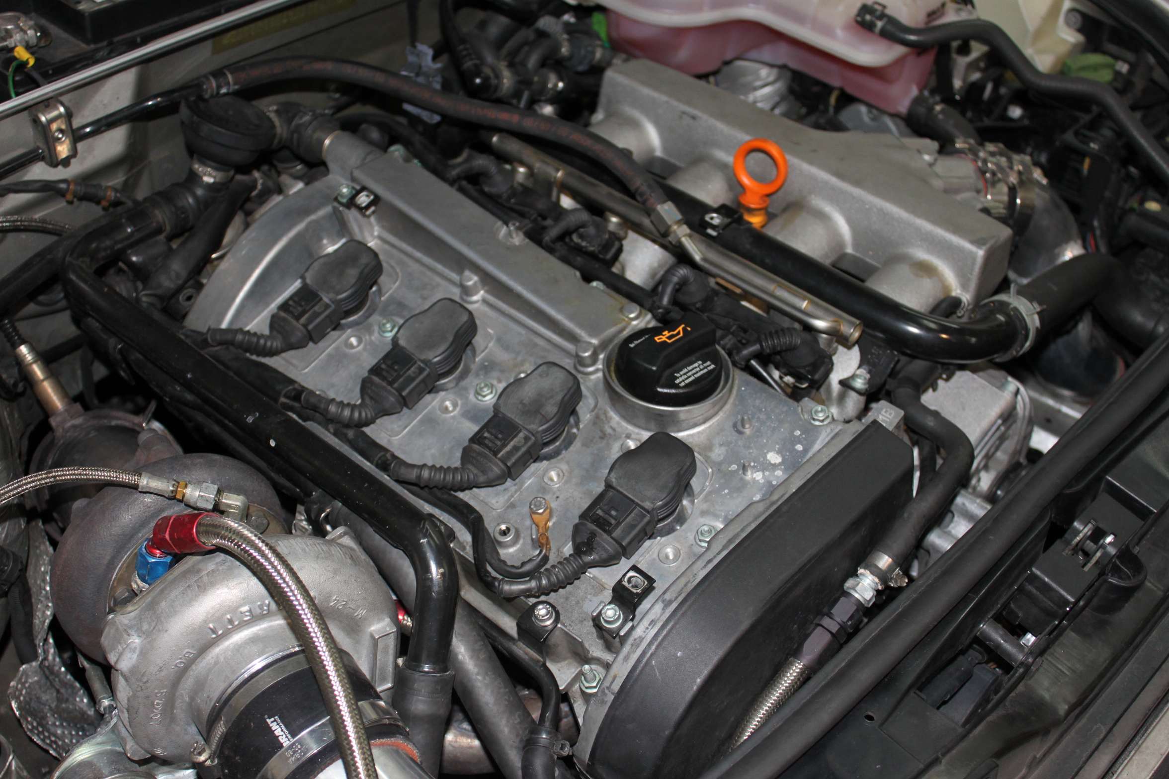

    Brand new set of OEM rev D coilpacks
    this is the video of the logger for the OEM rev D coilpack pulls
    if you watch the first video you will hear 'brrrruuuuupttt' sound and that is the car misfiring from the coilpacks.
    http://www.youtube.com/watch?v=prLeujfOX5Q
    we did a second pull to see if the misfiring was going to happen again. it did and this is exactly the same issue I had with the set of coilpacks when I had. so no issues with the rev. R coilpack but massive misfiring with the rev. D
    http://www.youtube.com/watch?v=jM7d4QDqCzo
    dyno plot (solid green line) with output figure

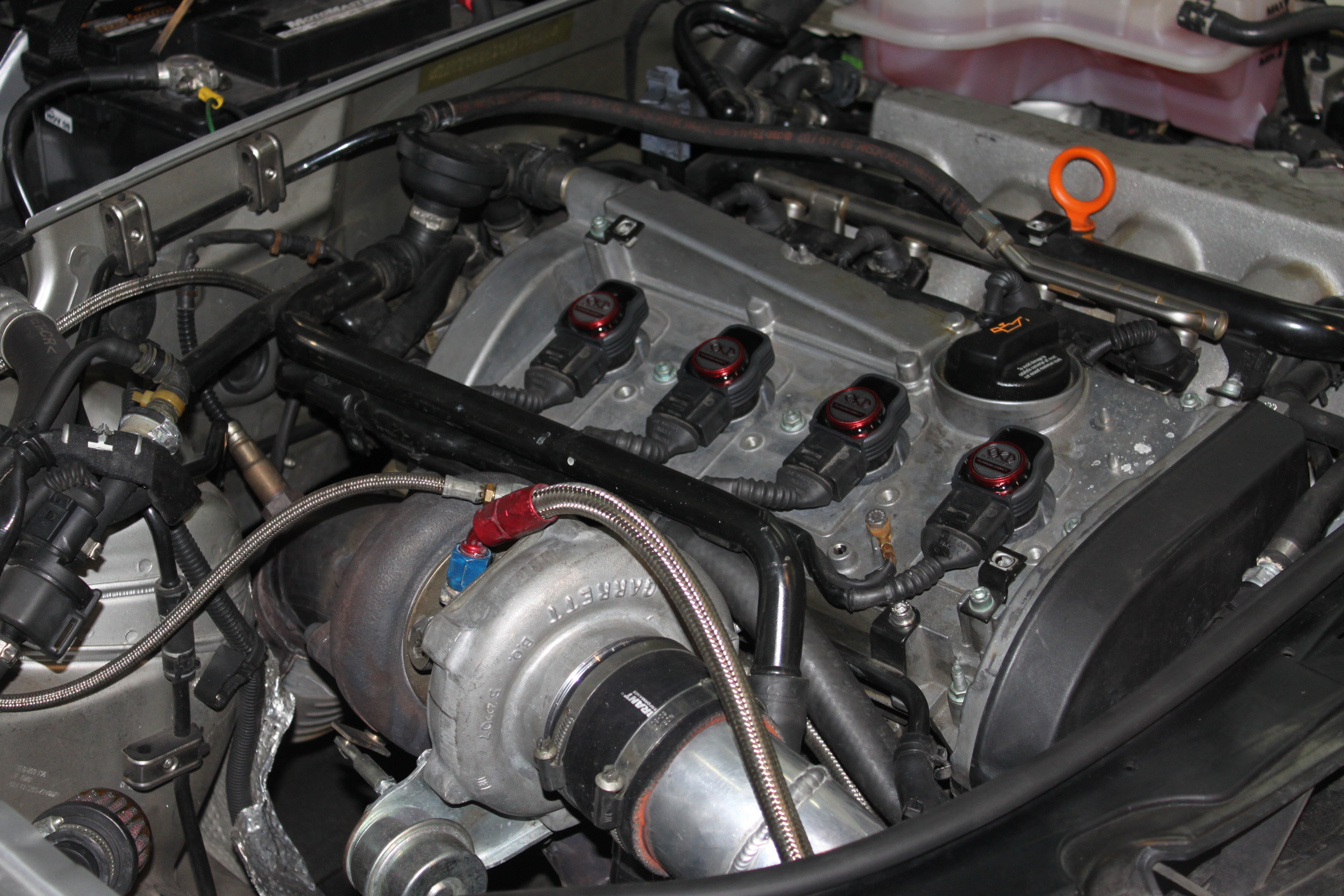

    Okada coilpacks installed (borrowed from reapersA4)
    this is the video of the logger for the Okada plasma coilpacks
    http://www.youtube.com/watch?v=zeZpVj2EaW8

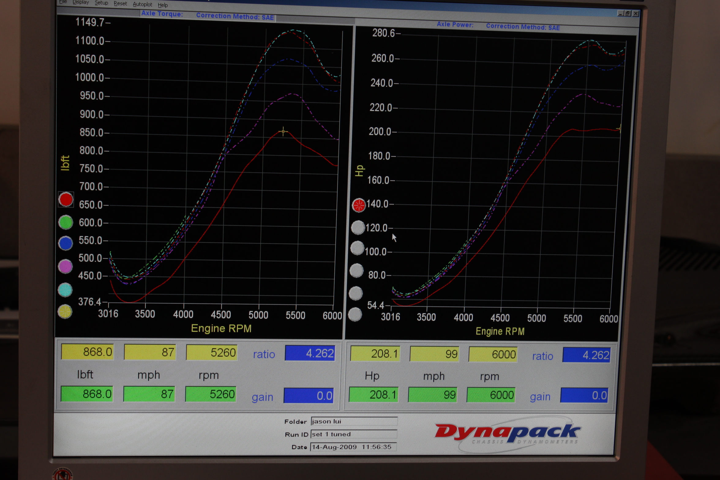

    dyno plot (solid blue line) with output figure

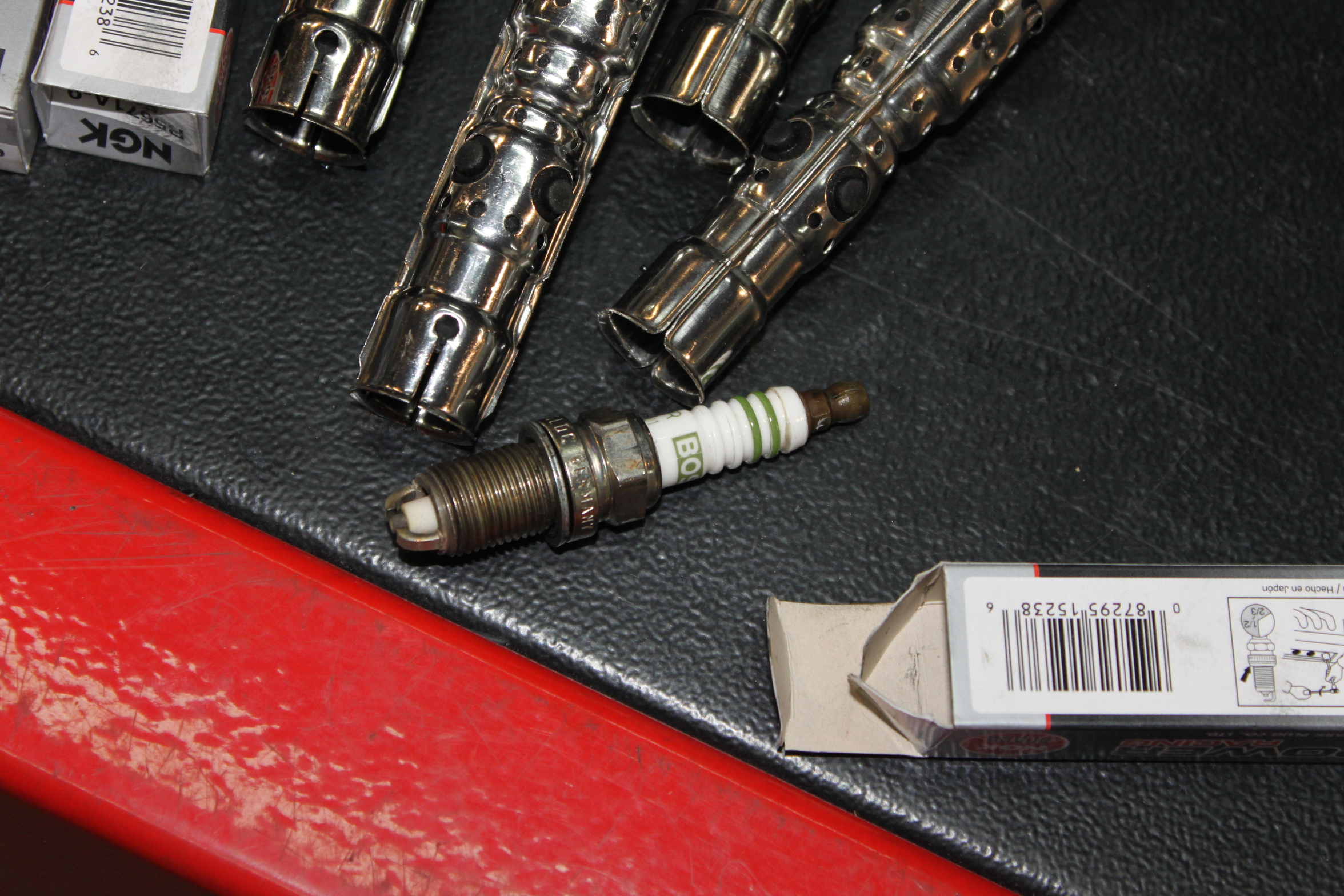

    then we swapped out the Bosch FR6DTC 2 prong plugs and replace them with these new NGK temperature 9 plugs
    this is the video of the logger for the Okada plasma coilpacks & NGK plugs
    http://www.youtube.com/watch?v=hUkVuq8iSso
    dyno plot (violet line = Okada coilpacks, NGK plugs)

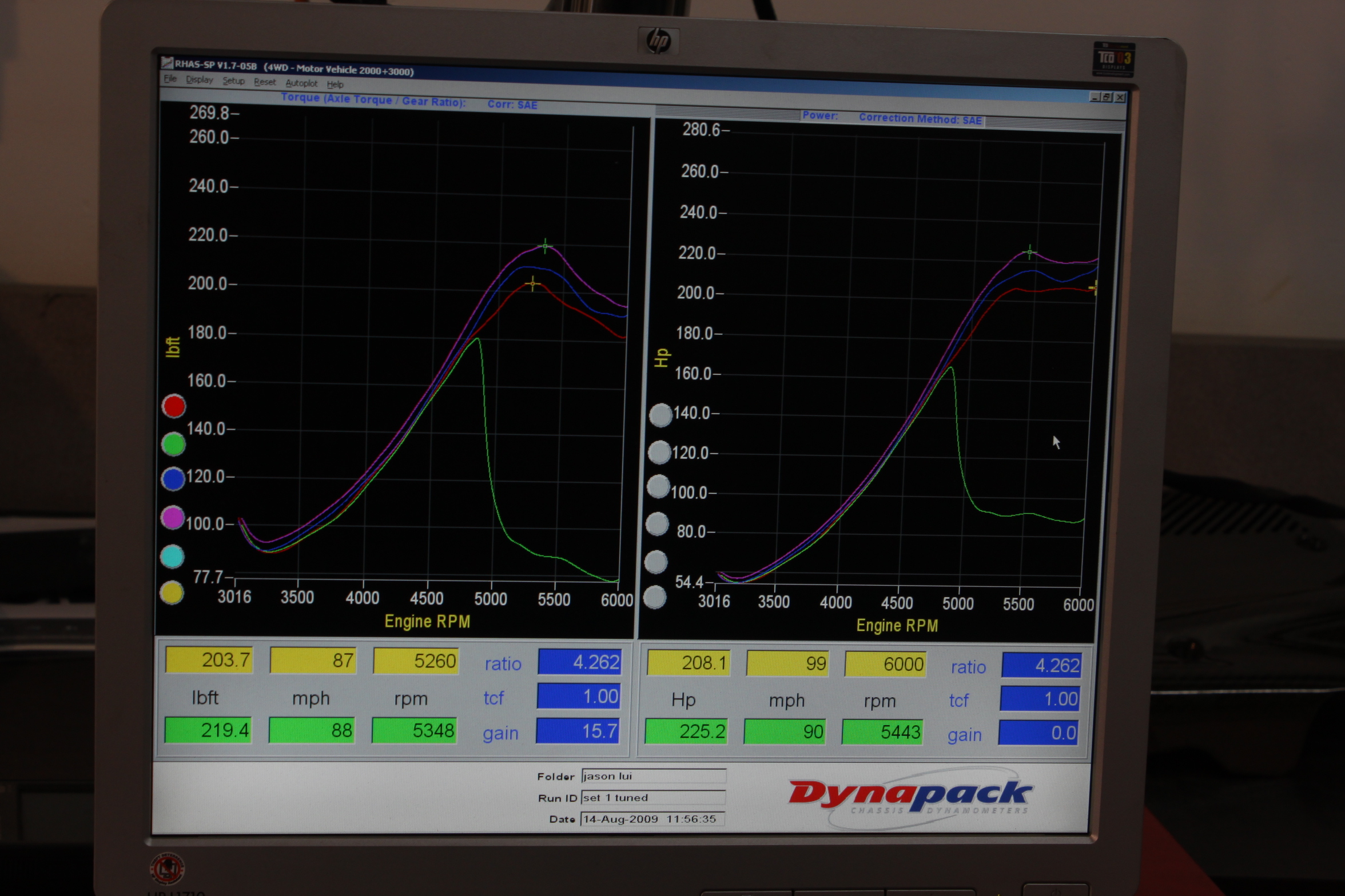

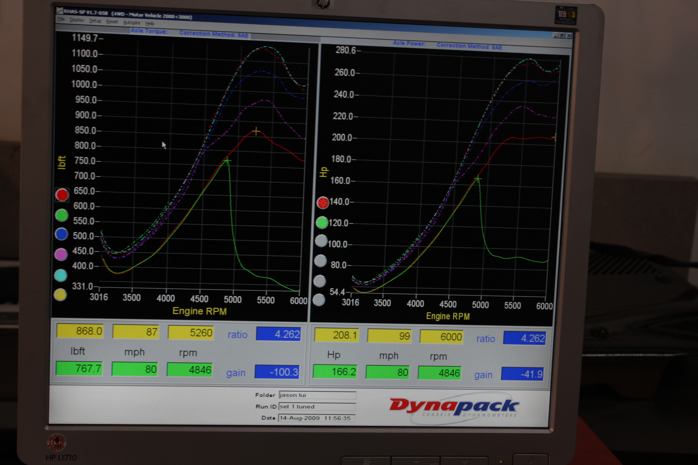

    so summary of the plot above:
    red = OEM rev R coilpacks with Bosch plugs
    green = OEM rev D coilpacks with Bosch plugs
    blue = Okada coilpacks with Bosch plugs
    violet = Okada coilpacks with NGK plugs
    light blue = OEM rev. R coilpacks with NGK plugs

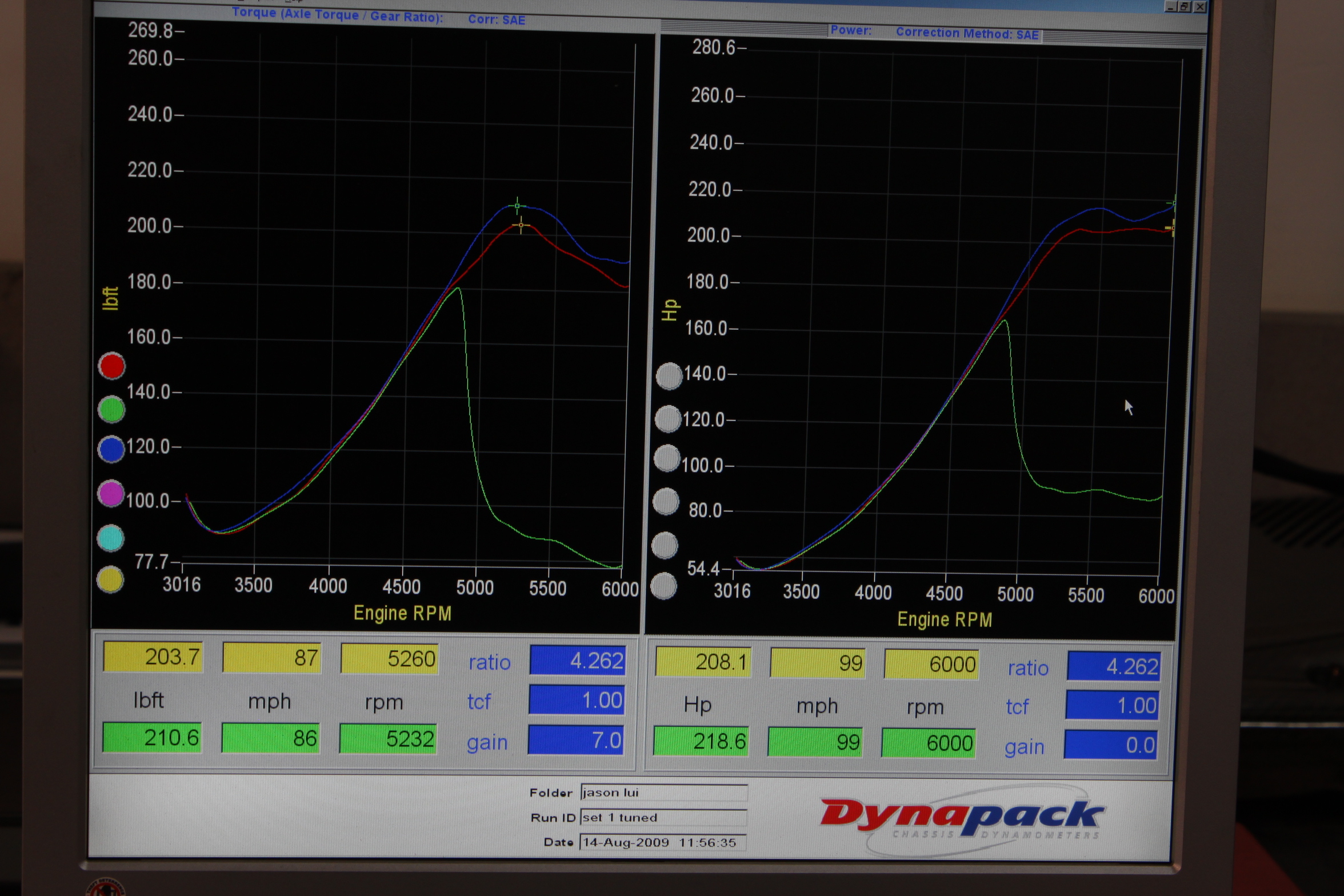

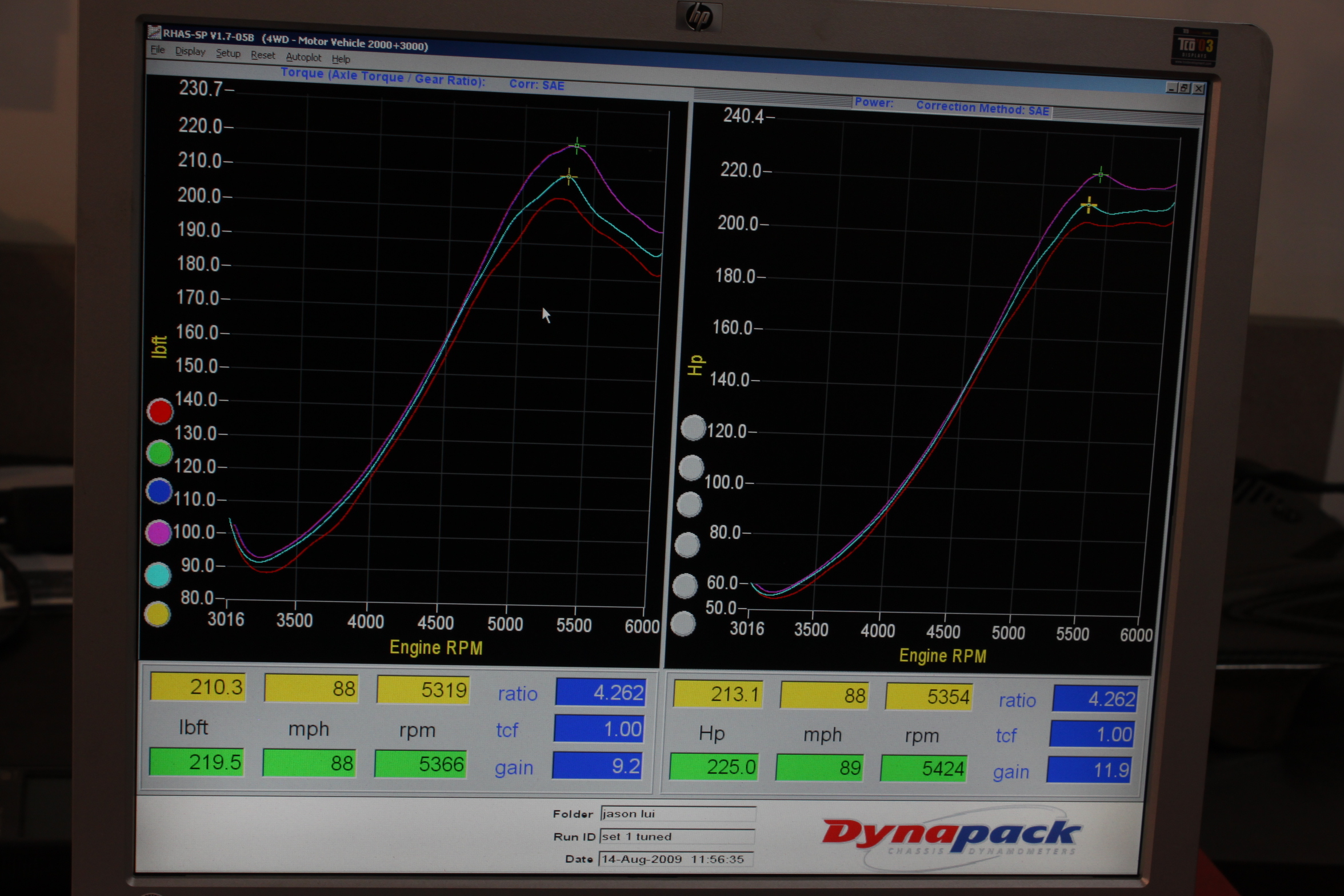

    To make the plot a lot more easy to read here is the results that you want to see

    I think 15hp/15tq at the wheels is pretty good gain for coilpack and spark plug upgrade.
    The gains would be higher at higher boost levels as well.

    a 2871 making only ~210whp? I know some dynos read low, but that's real low. And what is up with the torque readings in the first couple of dyno charts?
    TEAM|AXION

    Quote Originally Posted by speedydragon View Post
    As I stated: All pulls were done at 18psi as that is what his manual boost controller was set at and 94 octane gas. His car is not running meth.
    This test was to show plug and play gains so no adjustment to the setup of the car was done.
    Are you referring to the graph with the green line?
    That's when the rev D coilpack spark blew out and the car started to misfire.

    Quote Originally Posted by [email protected] View Post
    I meant the first dyno chart where the torque reading is like 800lb. tq.

    The scale used for that axis was not correct in the chart.
    You can see in the last few graphs the scale factor was corrected.
