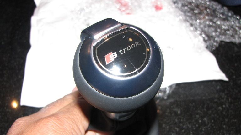

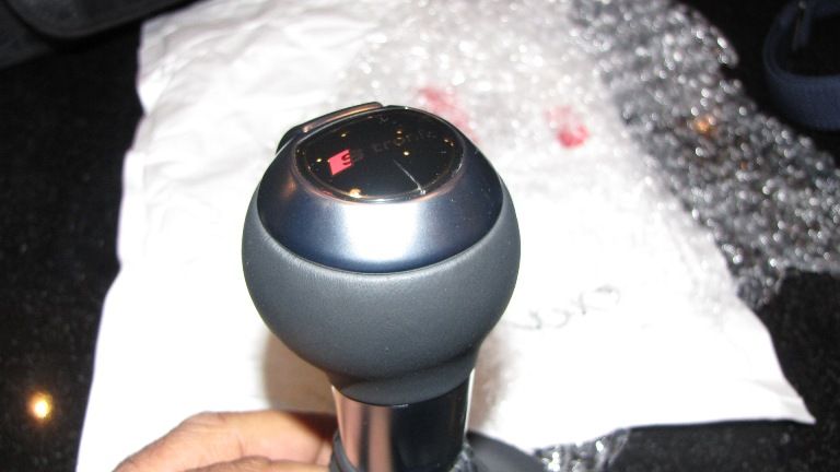

    Received my shift knob today and was greeted with a hair line crack on the top of the shift knob. I contacted the supplier who inturn blamed the postal service and said that I should sell the unit at half the price I paid for it :S I'm miffed because had they packaged the product accordingly I wouldn't have had the issue....
    One thing that i did notice was that the shift knob was not perforated like Alex's and matches up quite nicely with my stock steering wheel.
    Hair line crack under a camera flash
    Other pics...

    this is where i ordered the gearknob from
    http://cgi.ebay.de/ws/eBayISAPI.dll?...m=200481923463
    this is what my gearknob looks like with the shift boot removed.
    C7 A6 3.0T, APR Stage 2+
    VBOX verified times:
    0-60mph 3.63s
    1/4 mile 12.22s @112.4mph
  38. #78
    Senior Member Three Rings guy013's Avatar
    Jan 21 2010
    53691
    Singapore
    ok guys, i had originally thought i had FUBAR-ed my 1st s-tronic gearknob. turns out i could still use it. i had broken one of the 2 springs that is used to hold the trigger in. i managed to fit it into my car now but the only thing is that because it has only 1 spring left, the trigger doesnt stick out as much as it should, but still can press in to select gears etc.its just that the movement is about half what it should be. in any case, my new S-tronic knob should be here anyday now and i'll put that one in. not sure what to do with this one though.... money spent to learn i guess.
    this is the part number of the S-tronic knob and shift boot that i bought.
    this is the part number of the original a4b8 knob + shift boot
    1) when you receive your S-tronic knob, the 1st thing you should do is remove the red plastic rod WITHOUT pressing in the trigger. Dont worry the trigger will still be OUT even after you remove the RED ROD. it is held out by a mechanism inside the knob head.
    2) then you need to remove the shift boot. i didnt take pics of this but basically underneath the shift boot is a round black ribbed plastic thing which can turn about 30 degrees. make sure the 2 thick lines are NOT ALIGNED. then pull with all your might to separate the shift boot from the gearknob. you dont need this shift boot anymore cos it only fits the A3.
    3) Next you remove your stock shift boot. use a small thin plastic piece to pry open from the SIDES, not the TOP, as that is where the clips are. there are 2 on each side and should be fairly easy to pull out. once you done so, the underneath has a metal locking ring holding the gearknob in place. i didnt know how to remove this without destroying it but i'm sure there will be those who can figure it out. if so, you can re-use this later to secure the S3 knob in place.
    4) once the metal locking ring is removed, you can basically pull the gearknob out with a bit of force. now the original knob + shift boot is out, time for the dirty work......
    5) you see the white plastic selector lever pin with the hole in the middle facing the side? well you need to heat this up and twist the whole damn thing so that the opening now faces the top. i used a lighter and a set of pliers to twist it. this will take a fair bit of time to do (~20min) as i was careful not to melt the plastic rod. take note that if this plastic rod breaks, you are in a world of pain ($$$$$$$$) to get it replaced. this is what it should look like when you are done.
    6) now if you have followed all the steps carefully, you should almost be seeing the light at the end of the tunnel. the trigger on the S3 knob should still be OUT. fix the original shift boot to the bottom of the S3 knob. it should click in place. lower the shift boot and gear knob over the selector lever and press it all the way in so that it doesnt turn left or right. if you still had the metal tie from step 3, then you can re-use this to fasten the S3 knob on the lever. if not, you can re-use the black plastic ribbed piece from step 2. this isn't as secure but will still work. this is what it looks like.
    7) NOW that the S3 knob is IN, you can PUSH IN THE TRIGGER so that it will hook onto the selector lever pin. clip the shift boot back in and bring that camera out to show the rest of audizine what your spanking new knob looks like!
    once again, i really cannot emphasize the importance of not pressing the S3 trigger IN when you receive your knob in the mail. doing so will complicate the process tremendously. i am at pains to describe the process to get that hook back out without a specific Audi tool which we do not have access too.
