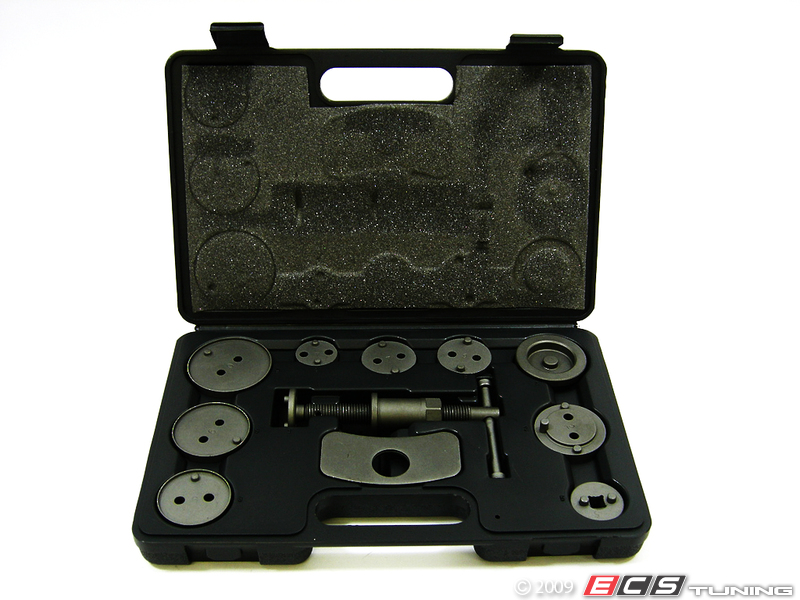

    For those wanting to do their own, you need a handy kit like this:
    http://www.ecstuning.com/Audi-B8_S4-.../Brake/ES9747/

    I finally got these stoptech posi-quiet pads installed (sorry for the delay i was back and forth at the dealer for a rear door malfunction, front joint bearing, front right torn caliper boot, front left control arm.... it's been an eventful month for my car)
    The rear install was pretty standard, needed to vcds to retract e-brake, push turn caliper tool to release the rear caliper.
    Front install was pretty uneventful... except i don't think audi designed their pad wear sensors to be reused with aftermarket pads. The sensor broke when my installer tried to put it back in. You cannot buy a brake pad sensor on it's own... you can only buy it with an OEM pad. My temp/perm solution is to run without a brakepad sensor... just ziptied it to the brake line and out of the way.
    I was pretty disappointed with the fact that the posi-quiets didn't come with a sensor (there is only one BTW... front driver side). I might follow up with stoptech about this... can't be all that expensive to throw on a single pad sensor on these pads... can it??
    Initial braking response is slightly less harsh.... you can definitely tell that the pad is a harder compound and makes more noise. I'll report back with pictures of dust accumulation in the next week or so.

    Sorry to hear about the pooch Hydro. Had to put mine down a couple years ago, its gut wrenching.
    foodplz, I have no idea how casual your dealer is, But! ****> This is a common issue on lots of VW and Audi's. We did our own pads here and this issue happened (a while back) and when we tried to get the parts warrantied, they said no dice because we must have broken them.
    Now not for nothing, but I explained to the tech that lots of these break, and it should not affect any warranty at all, because the entire unit was secured until we could bring it to them to inspect.
    In short, make sure its noted on your sheet somewhere that the techs are aware of the sensor issue and that it should not be detrimental later on.

    I just ordered front and rear EBC red stuff pads. Do we have a good DIY on how to install them on the B8?
    Hopefully I dont have the same brake sensor problems. I'll let you know how it goes.

    This is similar with info on how to use VCDS to retracts the electric brake on the rears and how to reset it again once down.
